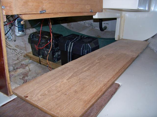

Rich had asked how i mounted my batteries..

This could be a repeat post, i posted it earlier, but now I do not see it. maybe it is lost in cyberspace. Could have something to do with demon rum....
Anyway, rich (rbone) had asked how i mounted my batteries. I tabbed and screwed two 1X6 inch board mounted athwartships on the two stringers that run along the bottom of the hull in the hold underneath the cockpit. then i attached two strips forward and aft of the battery boxes to keep them from slidding. Then i used my extensive time tested lashing skills (jk :D) to attach one box, and had a strap for the other.

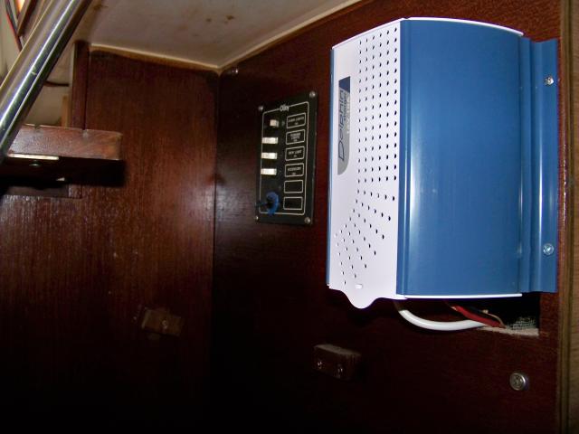

I have one battery attached, but intend to get another. My charger is a two bank reya / dolphin.

It looks good Keith.
