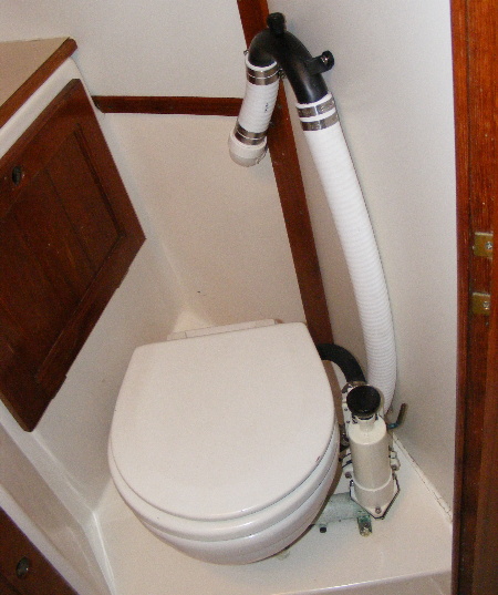

I have an anti-siphon loop between my head and tank.
It's there simply because it was a return bend I could get quickly that had mounting lugs attached. I figured the anti-siphon couldn't hurt helping stuff flow down into the tank and, if I ever had odor, I would just plug it up. So far, no odor. Anyway, it would be an easy matter when leaving the boat to just unscrew it and screw on an adapter for a hose to the solar pump set on deck with the hose running up through the Dorade vent right above.
