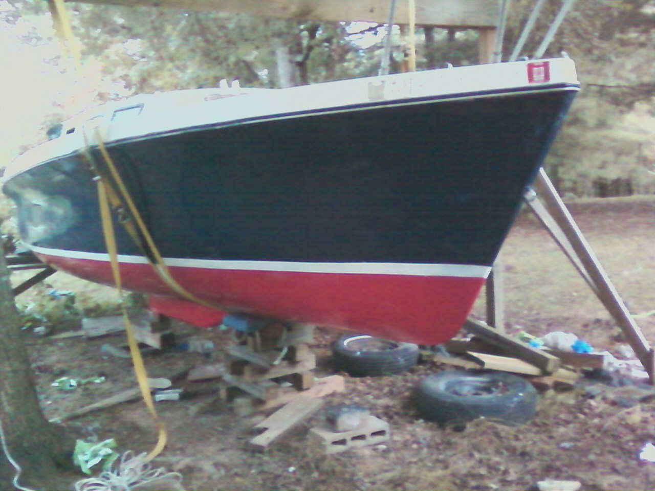

I have an old Rhodes that I have been slowly repairing. I plan to give it to my kids. Here is an album with a few repair pics and I have many more if you find the useful.
On my Rhodes I plan to use puck LED lights for the interior and clamp on nav lights for the rare occasion that I sail at night. For an anchor light I hang an LED camping lantern from my boom. I don't trust some 5:00 AM fisherman to look UP at my mast in the fog so I like to keep my anchor light on the boom. Regarding insurance, I assume you are only going to get liability. You will not need any inspections for that.
On the interior, I am not going to reinstall the galley. I've been gunkholling on various boats for 20 years and almost never cook in the cabin. My recommendation would be to get a nice bimini and a cockpit table and clamp a BBQ to the stern rail. At anchor you will want to cook outside to keep the cabin from getting hot... and then just make sandwiches for lunch underway.
13,020

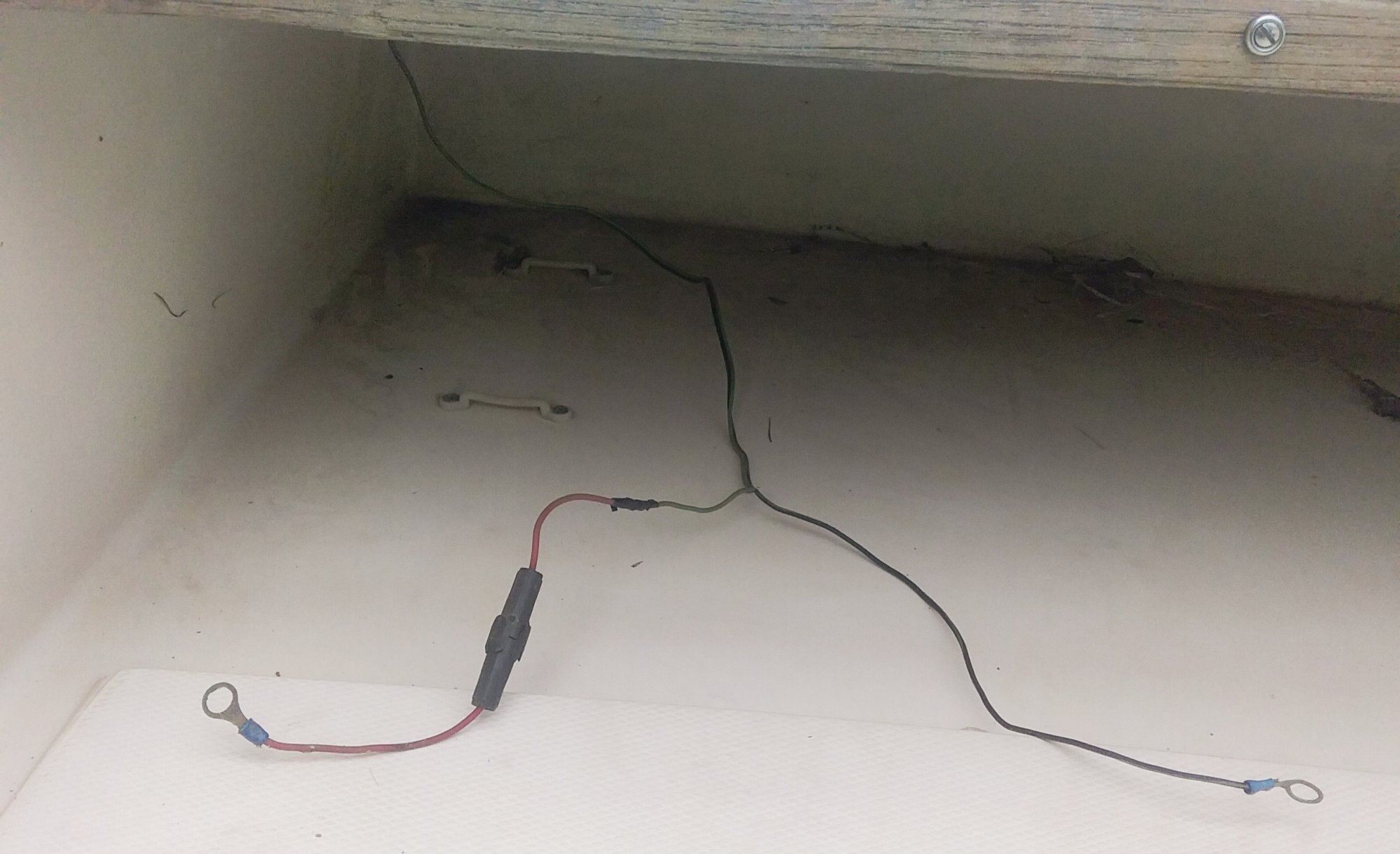

Update... I just went out to the boat and searched again from bow to stern, and wouldn't you know, I found this in the last place I looked! Couple of 16 gauge wires with an inline fuse, and a couple of battery hold down cleats. This was under the stbd cockpit seat with one wire just sticking out of a hole in the bulkhead. Still no switch panel... I can't imagine you had to attach the wires to the battery to turn on the running lights...

By the way, I looked at your Rhodes album and was planning on spraying my hull "flag blue". Is that the color that you used? What brand of paint did you use? (Or is that gel coat...)
13,020
The blue was on the hull when I got it. I stripped and barrier coated and painted the bottom roll and tip with oil based (in the can) rustoleum enamel paint. The red and white are rustoleum.
I've used rustoleum on several boats and have always had really good results. The other think I like about rustoleum is that 5 years later, when I scratch the hell out of it... I can still find an exact color match for the touch up and a spray can is good for the touch ups on the bottom.
The bottom of this boat is also rustoleum...
If you are going to trailer sail, you don't need anti-fouling bottom paint. Just rince off the bottom after each sail. I've done many week long trips in my boats and a simple wash down once it is back in the driveway is enough to keep the bottom clean.
