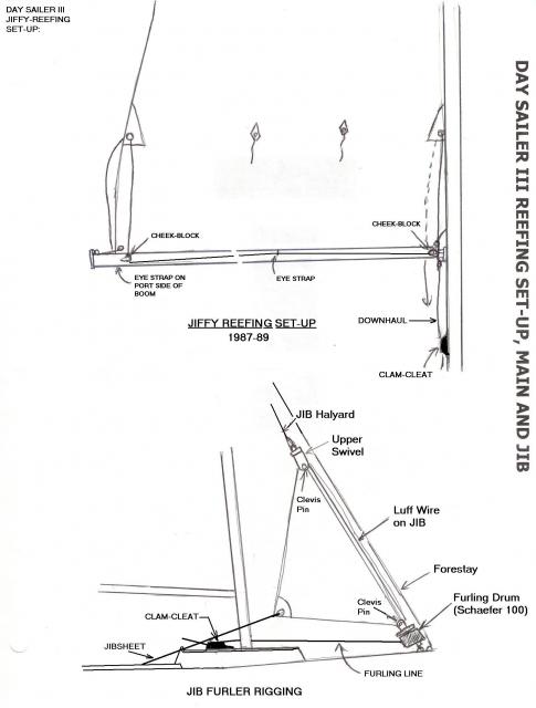

Oday Day Sailer Wareham, MA
I have a 1979 DS II and will echo the advice to get reefpoints added to your sail! I would expect that the cost to do this on a Mariner would be very close to the $60 that I paid for reefpoints on my DS mainsail (Harding Sails, 1999) price will most likely be a bit more now, inflation, but still worth it. Figure about another $40.00 +/- for hardware and you will be set. Harken has drawings of jiffy-reefing set-ups on their web site, but it looks too complicated and $$ for my taste. I'll attach a drawing of the set up for a DS III, this is basically what I have on my DS II.....well, close enough! I have a camcleat on the side of the boom to secure the reefing line, it would mount as close to the forward end of the boom as possible, on the port side in the diagram.
