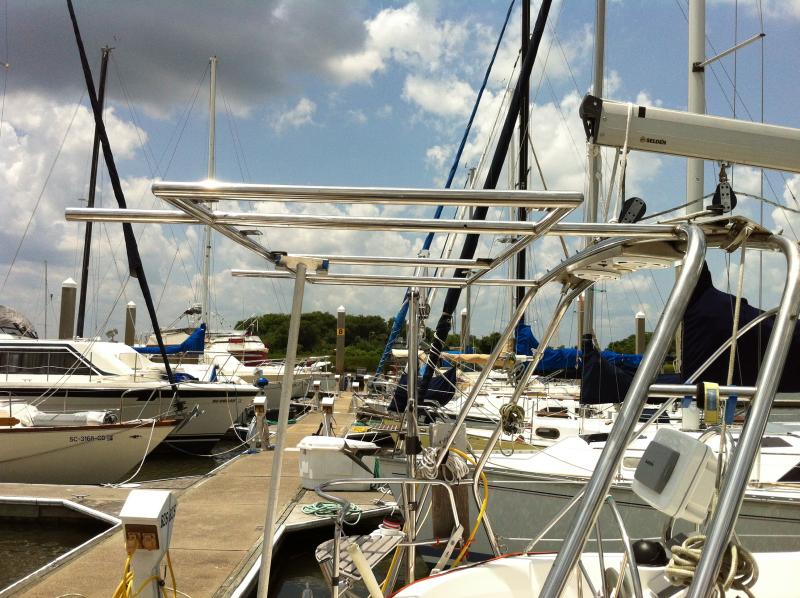

He's a picture of the solar rack and dinghy davits I had installed. Two additional supports were welded in on each side after the picture was taken
