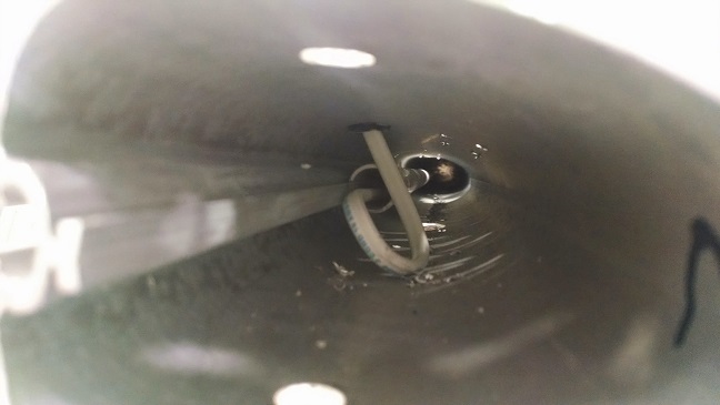

Here is an interesting photo; You'll notice the inside of the extrusion forms a T-shape on the back of the sail track. By cutting a slice up the PVC it just grabs around the extrusion and you can just slide sections of pipe up the mast without fasteners.

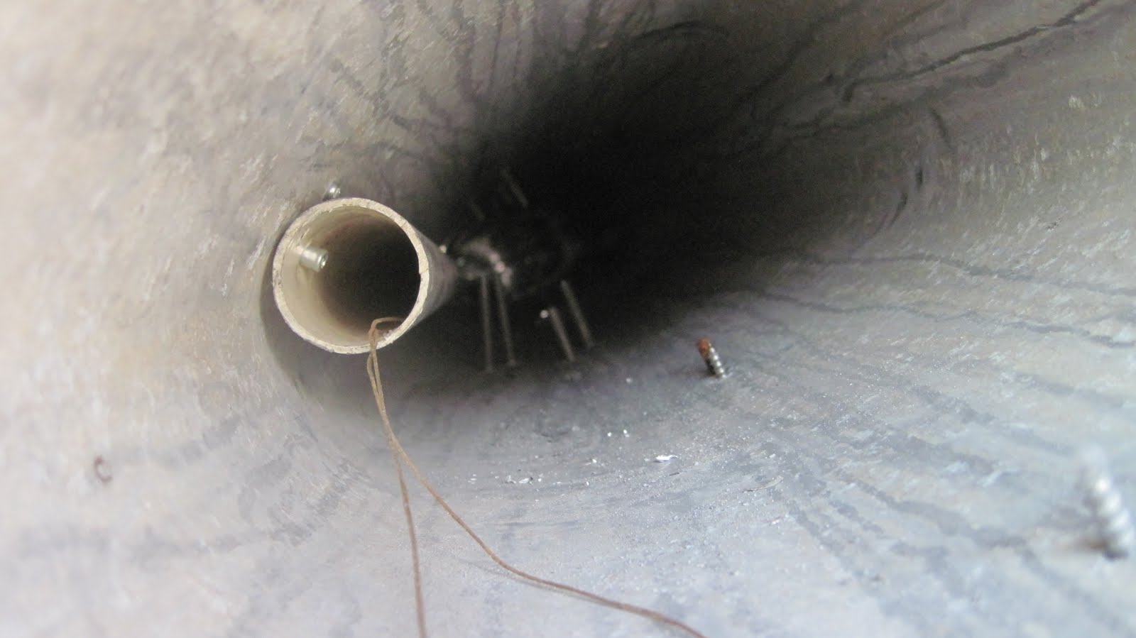

This is probably what is done most often, pop rivets into PVC tube. As much as I hate having to go this way this might be it for my 24 foot mast. The rivets, as you can see in the pic, aren't too intrusive. I would probably only use two 8 foot sections and they wont be connected, that way the break will be around where my steaming/deck flood light is located and the wire can exit the tube there.

When that friction fit to the internal extrusion fails the conduit will drop and slice your wiring. Been there. Rivet the conduit.
