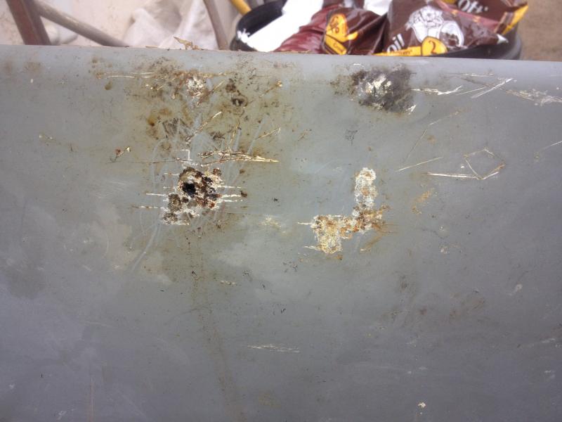

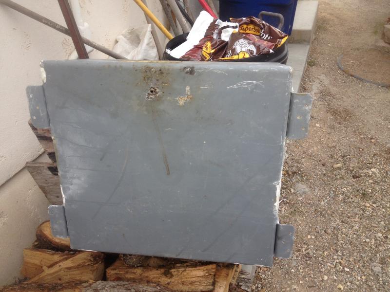

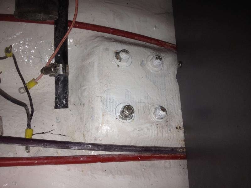

I previously posted about a leaking fuel tank on a 1996 Catalina 30. After removing the tank I found that the forward portion of the tank was resting on four stainless bolts with nuts attached. I believe this is the connection for the prop shaft support. The aluminum tank was destroyed by electrolysis by contacting this stainless. This is the original tank so either something is missing that would prevent this contact or this is a major manufacturing defect that all owners need to be aware of. See attached pictures of the bottom of the fuel tank.
