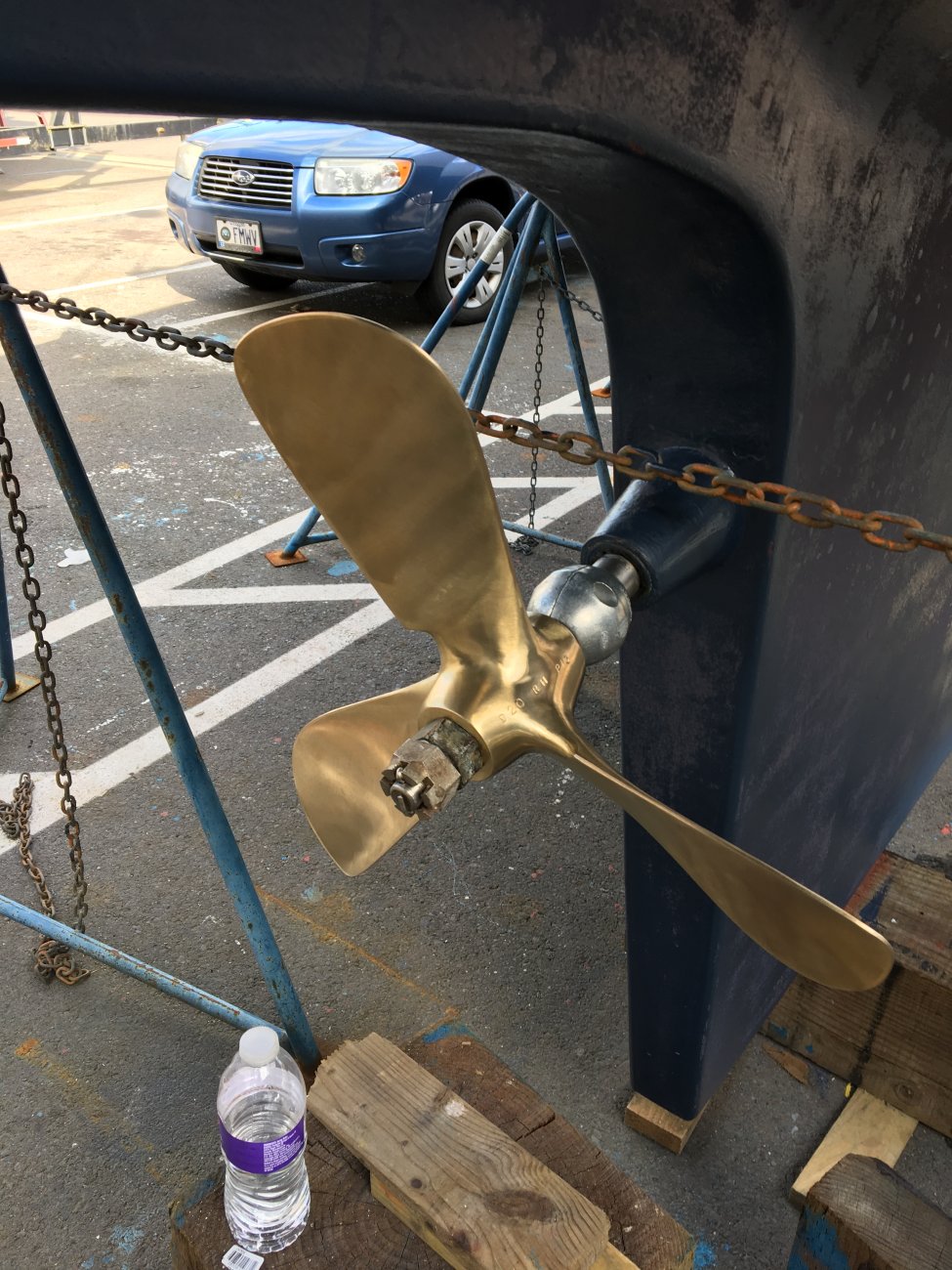

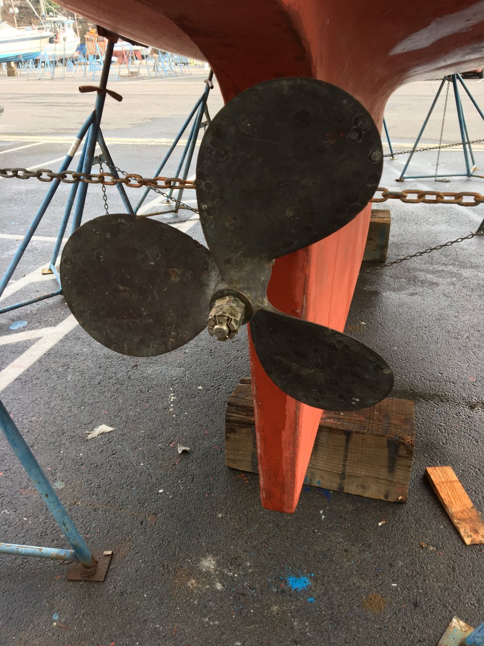

24,844
@rugger. Welcome to the forum.
Prop walk is a feature of most props on boats. Sailors learn to use this as a tool. Each boat design has a little bit of difference in effect. The design features - Keel, Rudder, hull shape, prop size, prop design, prop pitch. - all combine to give you the amount of prop walk you are experiencing.
You can change some of these design elements and modify the amount of prop walk you experience. Namely the prop, but not the others, unless you get a different boat.
Here are are pictures of two props. One is more efficient and contributes less prop walk.
E3647FEA-8EF9-4D07-B6A9-45CE4CA2C282.jpeg BFA683E5-7675-4B35-8AF6-0D7DCF49B079.jpeg
