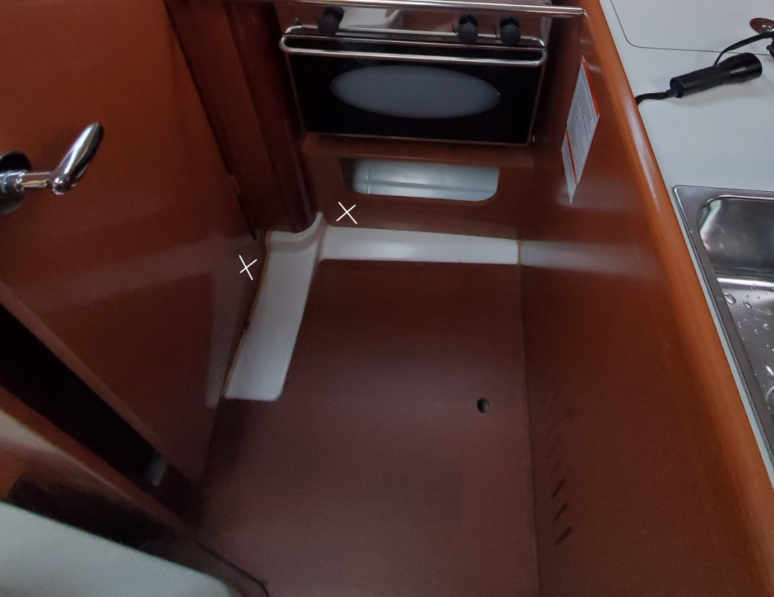

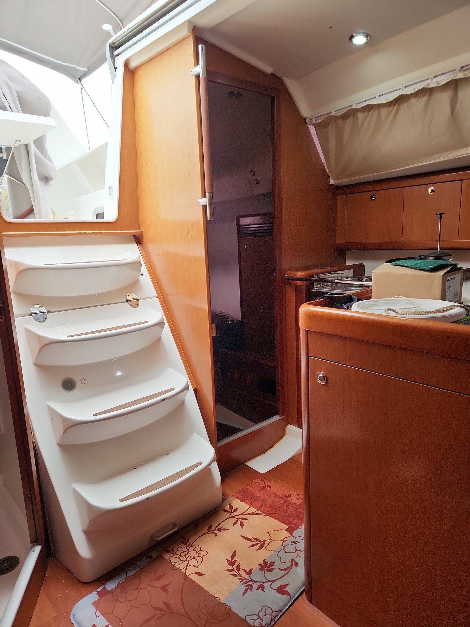

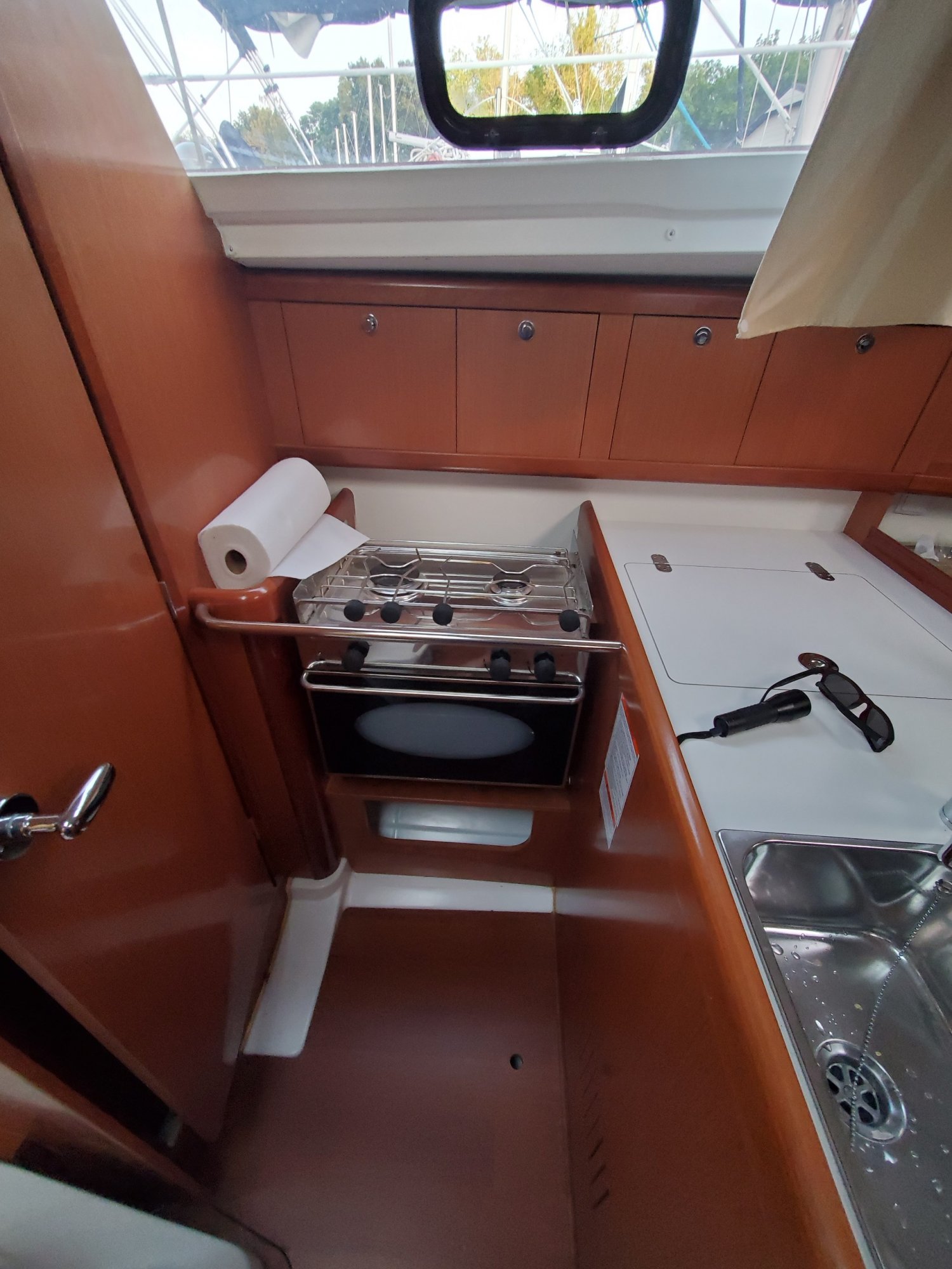

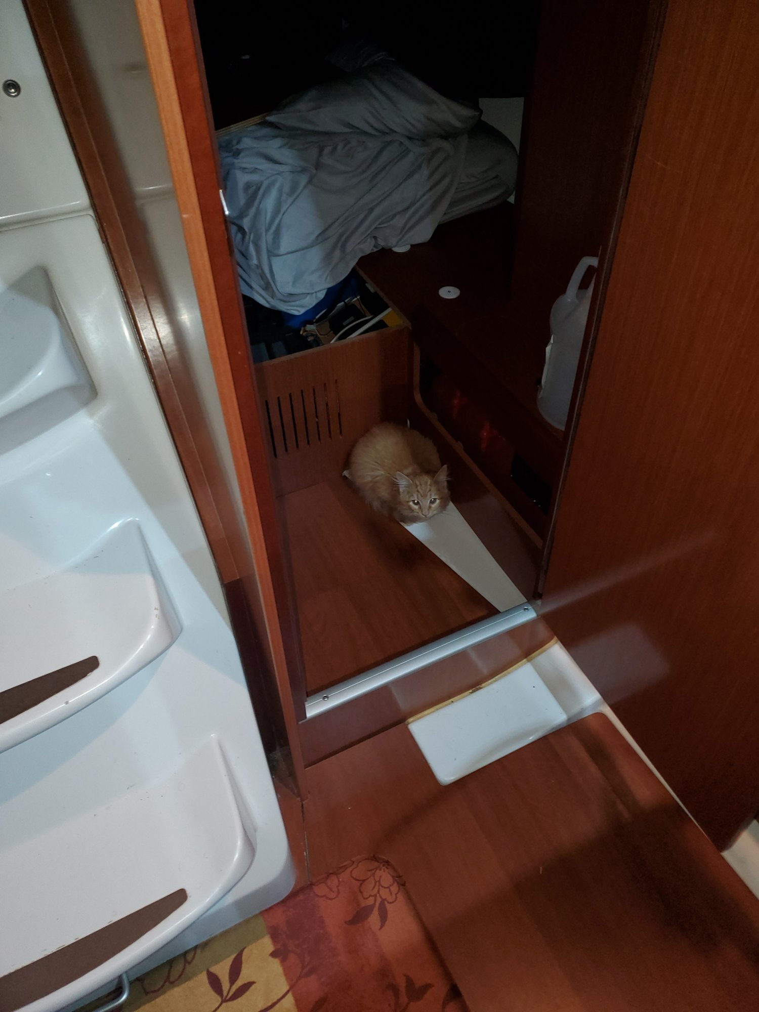

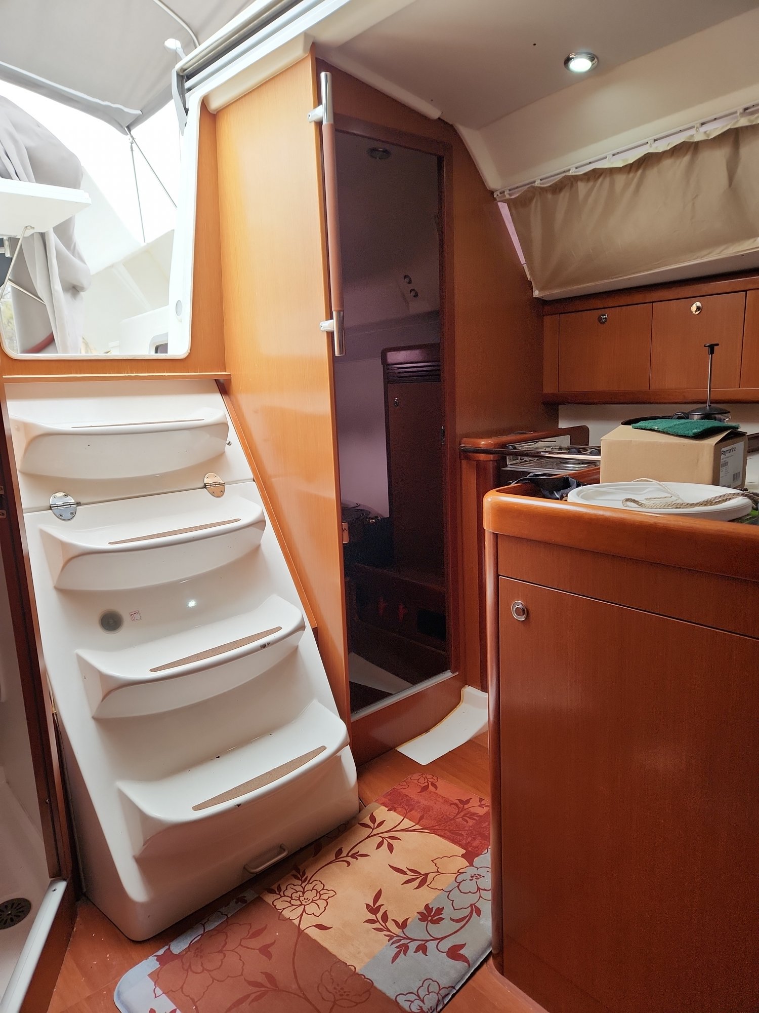

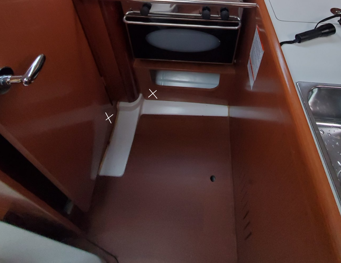

I remember reading a how-to on this subject, made it seem easy. A few days ago I decided to try it. The problem is that the aft cabin door opens into the galley. To hold it open we tied it to the stove but if you wanted to use the stove or needed something from the galley it had to untied and retied. There is room for the door to open into the rear cabin, I think the European boats are made this way. I was super easy, almost like it was designed to be installed either way. I like it much better. I still need to find a catch to hold the door open like the v-berth. I have pictures of the reversed door, I'll try to find some of the original and post them.

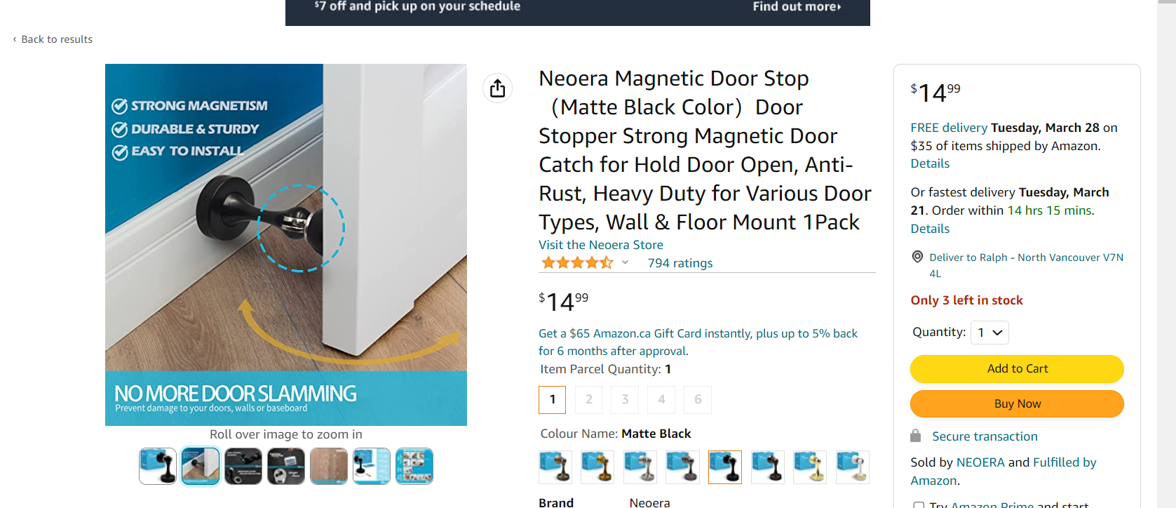

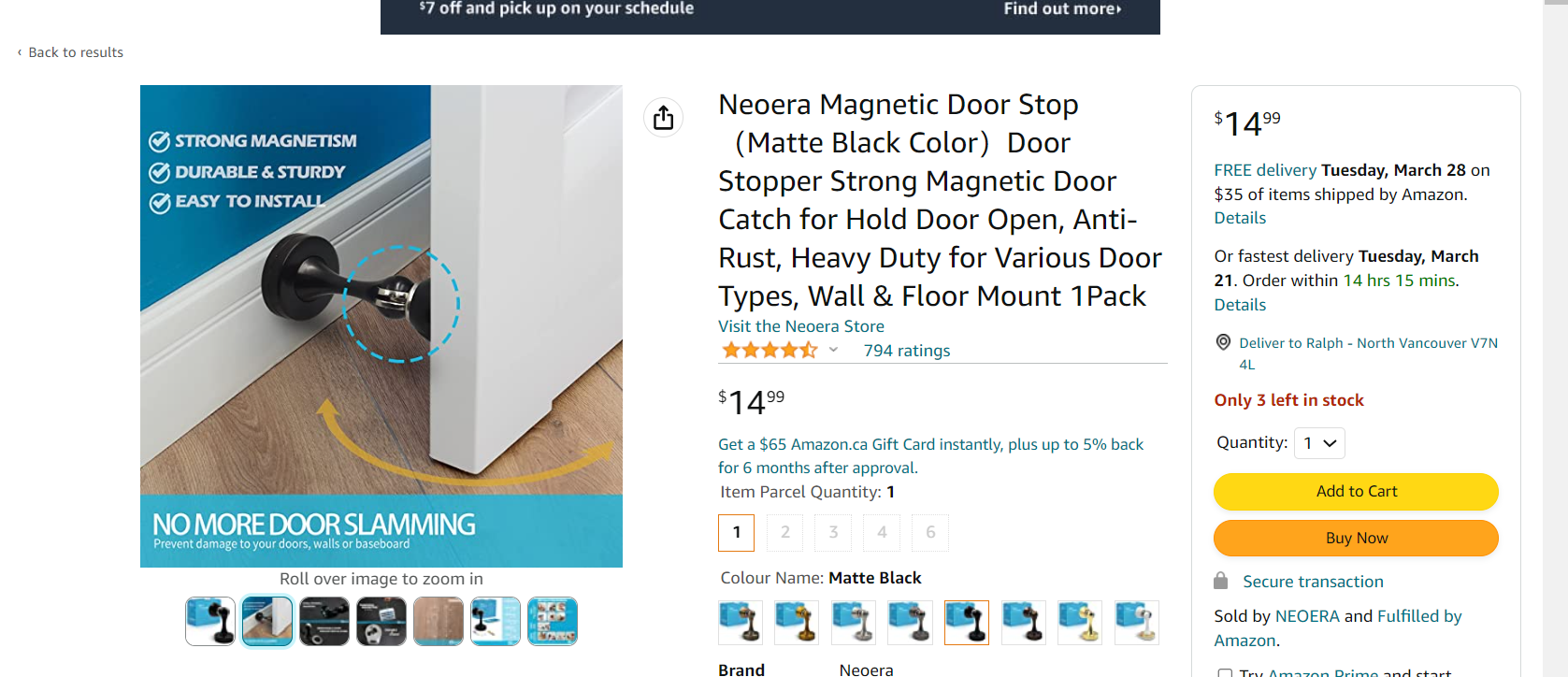

Any chance of using something like this rather than paying an arm and a leg for a genooine Beneteau part ?
Maybe get away with mounting in down here :
If the dimensions of the door holder are not too long.
EDIT. I just noticed the door holder can be floor mounted so as long as it's not a tripping hazard, it may do the trick.

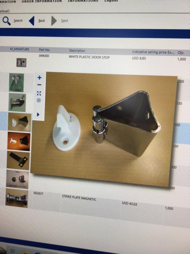

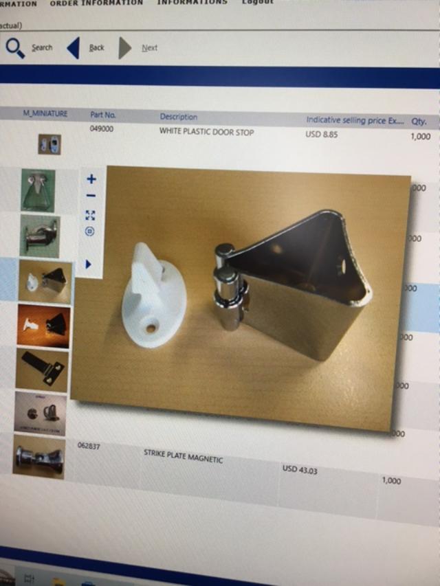

I could not find the door stop / pinch bracket specific for my 343; however, I did find three that were listed in "common" parts section of the catalog.
Door stop (large) 012915, $22.07
Door stop ? 048950, $7.45
Door stop (small) 953928, $8.15
If you decide to order from Beneteau, you will have to order from any Beneteau dealer of your choice, so you may ask them for your specific needs. At least, you now have part numbers, if you can't access the parts catalog. I usually order thru Annapolis yacht sales because they are quick to respond and ship quickly. (AYS is not my local dealer).
As @Davidasailor26 mentioned, the pinch bracket is very tight; however, it holds securely while underway and the door does not pop open.thumbnail.jpg

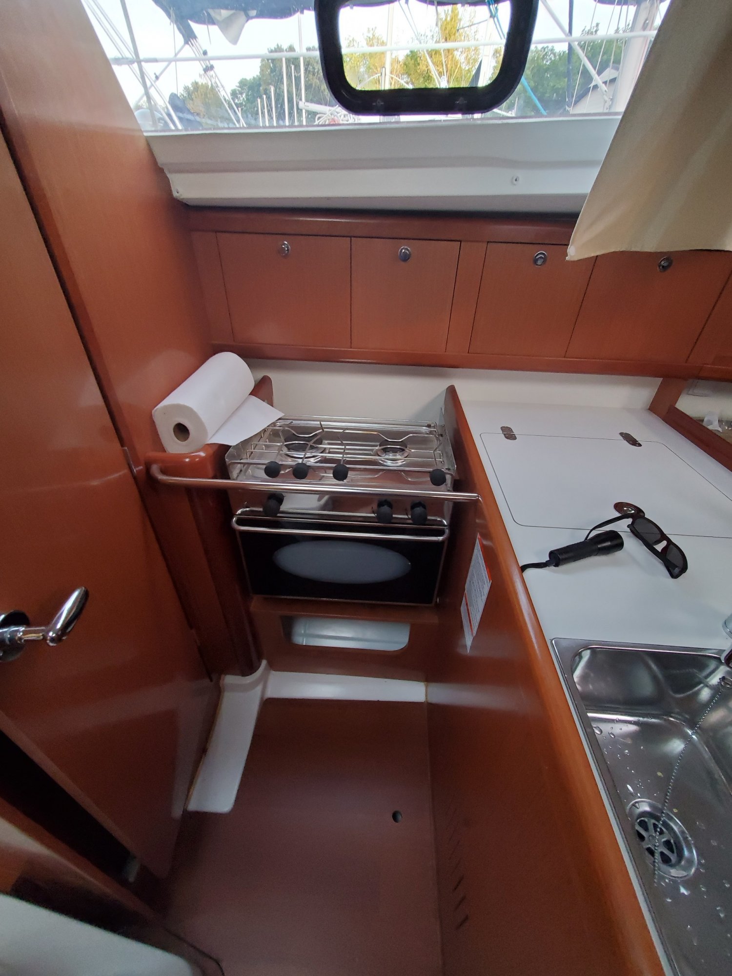

I'll look onto that, but I have already reversed the door. That's a before picture.
