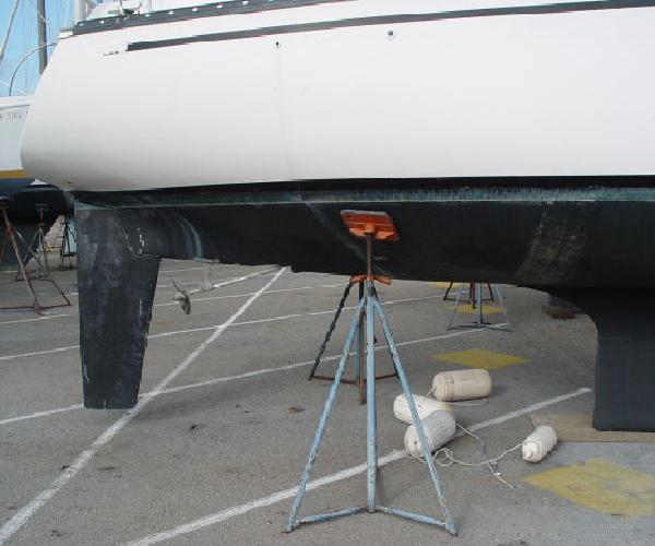

Dear Capnjeffw:
Yes, the thought about modifying the skeg section of the hull had occurred. But discarded because:
- Lot of work...and probably beyond capability of even a try-just-about-anything DIY'er (that would be me).
- Probably very expensive.
- Lots of things are happening in the area such as cutlass bearing, prop shaft exiting the hull, and rudder post. (Attached is a pic of the stern section of the hull I had from the purchase survey -- sorry about the quality). And there would be concerns about affect on general structural strength of the hull. Would need the services of a yacht engineer?
- Would the mod adversely affect the handling characteristics under sail power?
- Wouldn’t be 100% certain that the modification will make a major difference… so would be an expensive experiment.
Summary: The cost/benefit trade-off favors continued coping with the pronounced prop walk until trying the cheaper/easier alternative of a smaller diameter and 3-blade prop to be installed when I next haul out. If that doesn't help, then I'll just need to get better at dealing with this boat's severe prop walk.

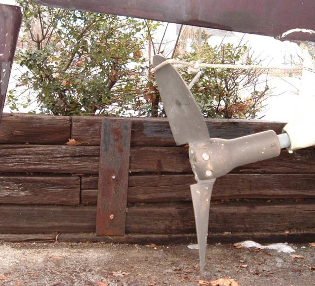

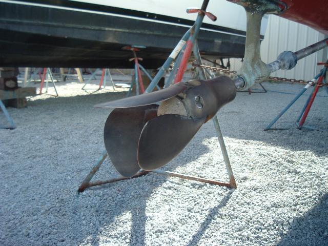

Jun 2, 2004
5,802
Your prop, strut, and rudder appear identical to my H37C. And it looks like plenty of clearance but as you state, not a real good picture. I also had the 2QM20 when I switched to a 2-blade Flex-O-Fold which significantly reduced prop walk. You can call them and discuss why it works so well. Now with my new 3YM30 and 3-blade Flex-O-Fold I have even less. Still if I run it up to 3000 rpm it will start to creep to port. So I goose it, go to neutral, and then she will follow the rudder. I still have the 2-blade somewhere. Also have the 14x14 3-blade that I bought when I lost the new one in the Erie Canal. I have to tell you there is a tremendous difference with the folder, both motoring and sailing.
