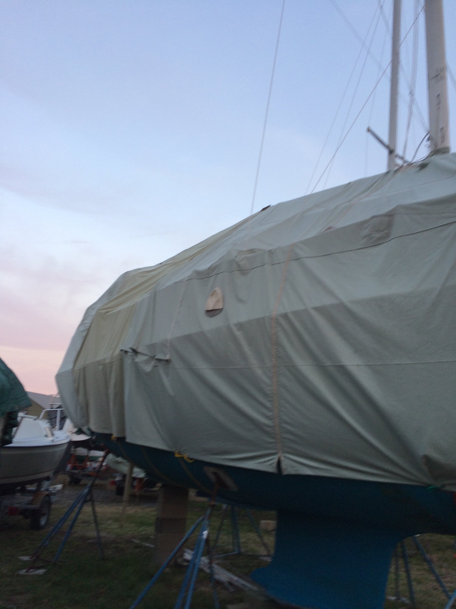

Several years ago I reused my Fairclough cover, originally for my H290, for my H33. I added a section in the middle(now 4 pieces) and the cutouts for the shrouds needed very little modification. Also added a ridge support. The cover is made of Sunforger fabric, is now over 14 years old and has required some resewing and patching in wear areas but has held up well. I had the same epiphany as quadrille38 a few years ago and now build the frame in the slip and load the cover aboard before hauling. I also learned to roll the cover for storage in such a way that in the fall I just put it on the ridge and unroll it and let it drape in place.
