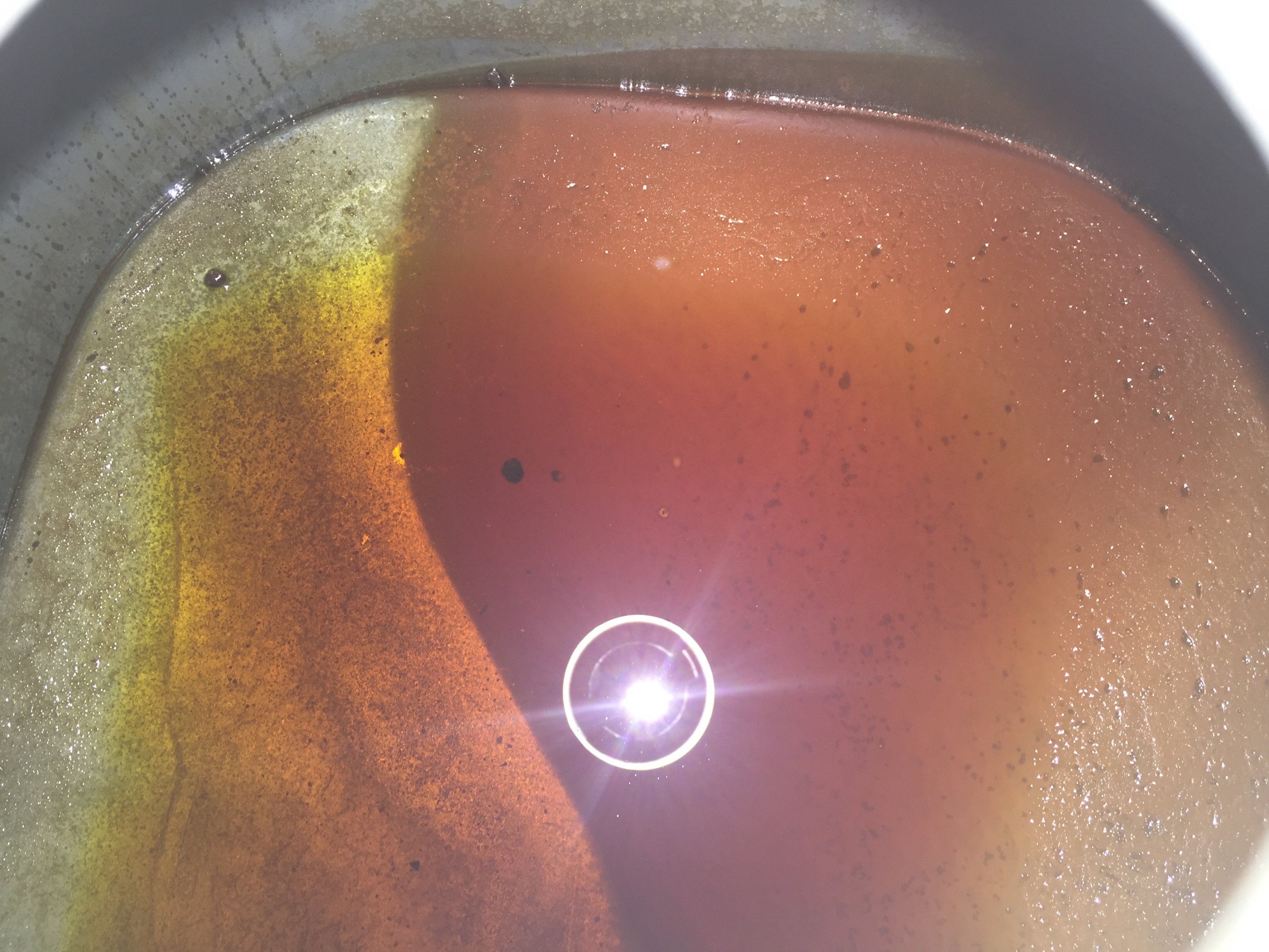

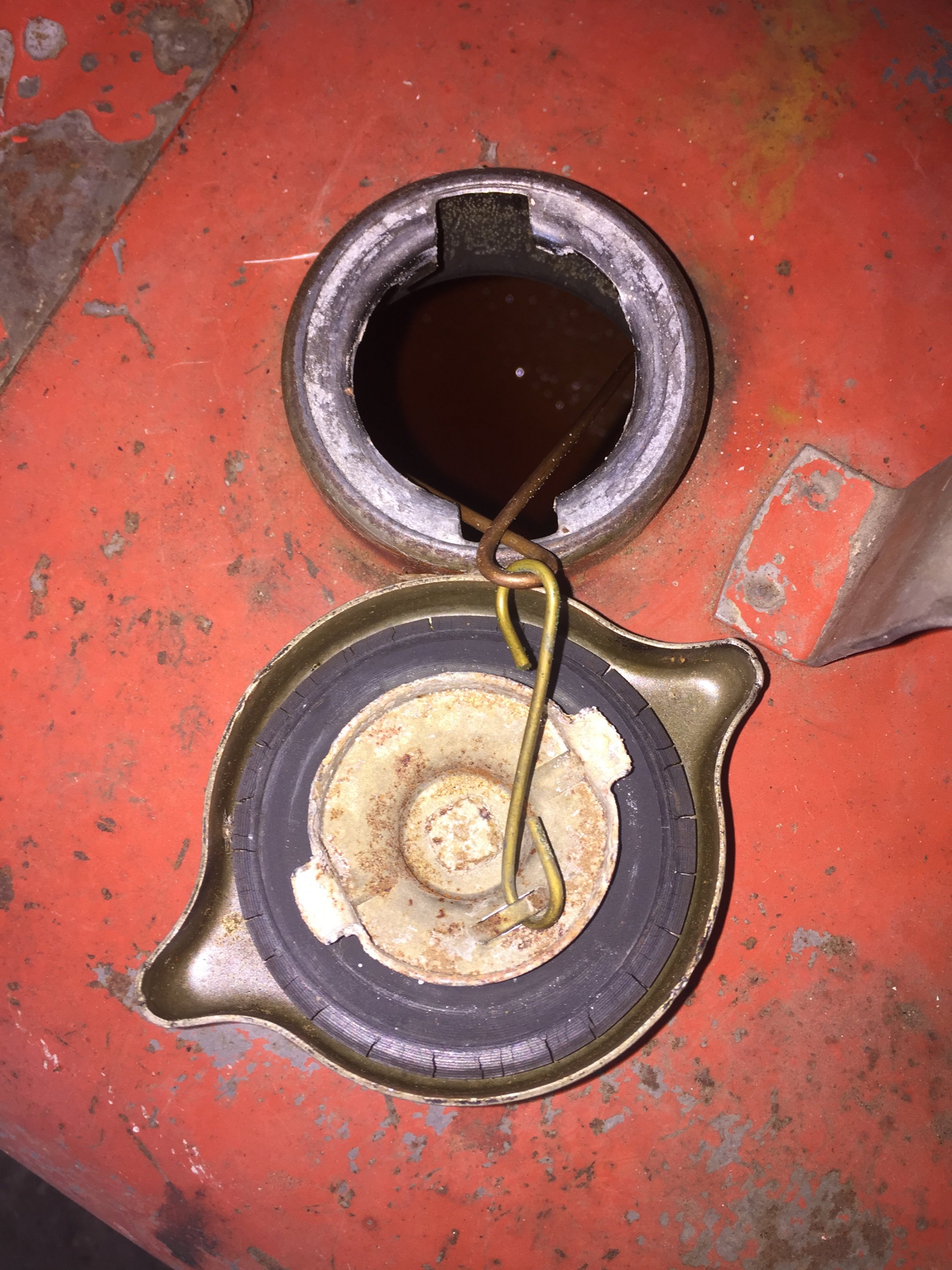

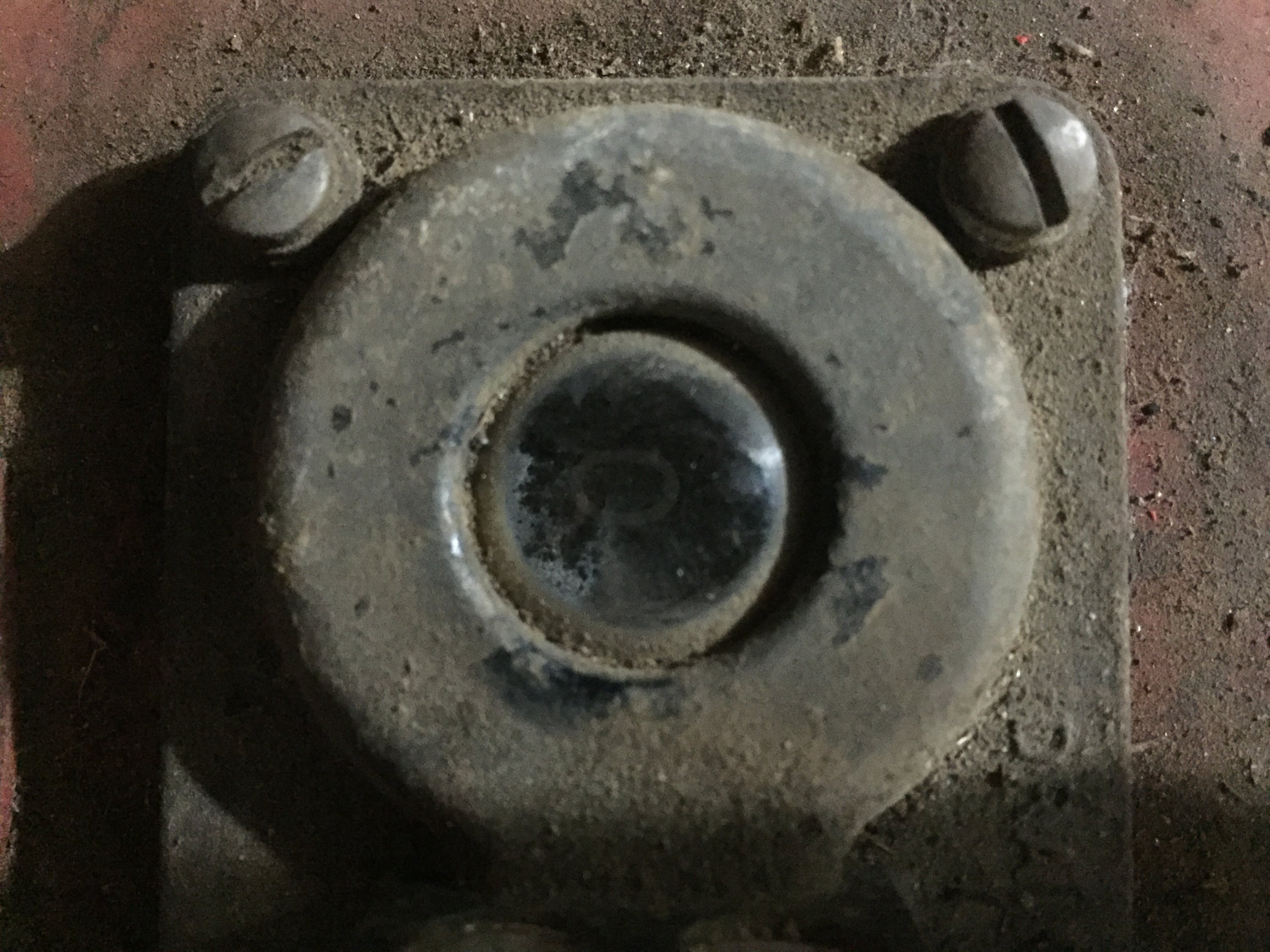

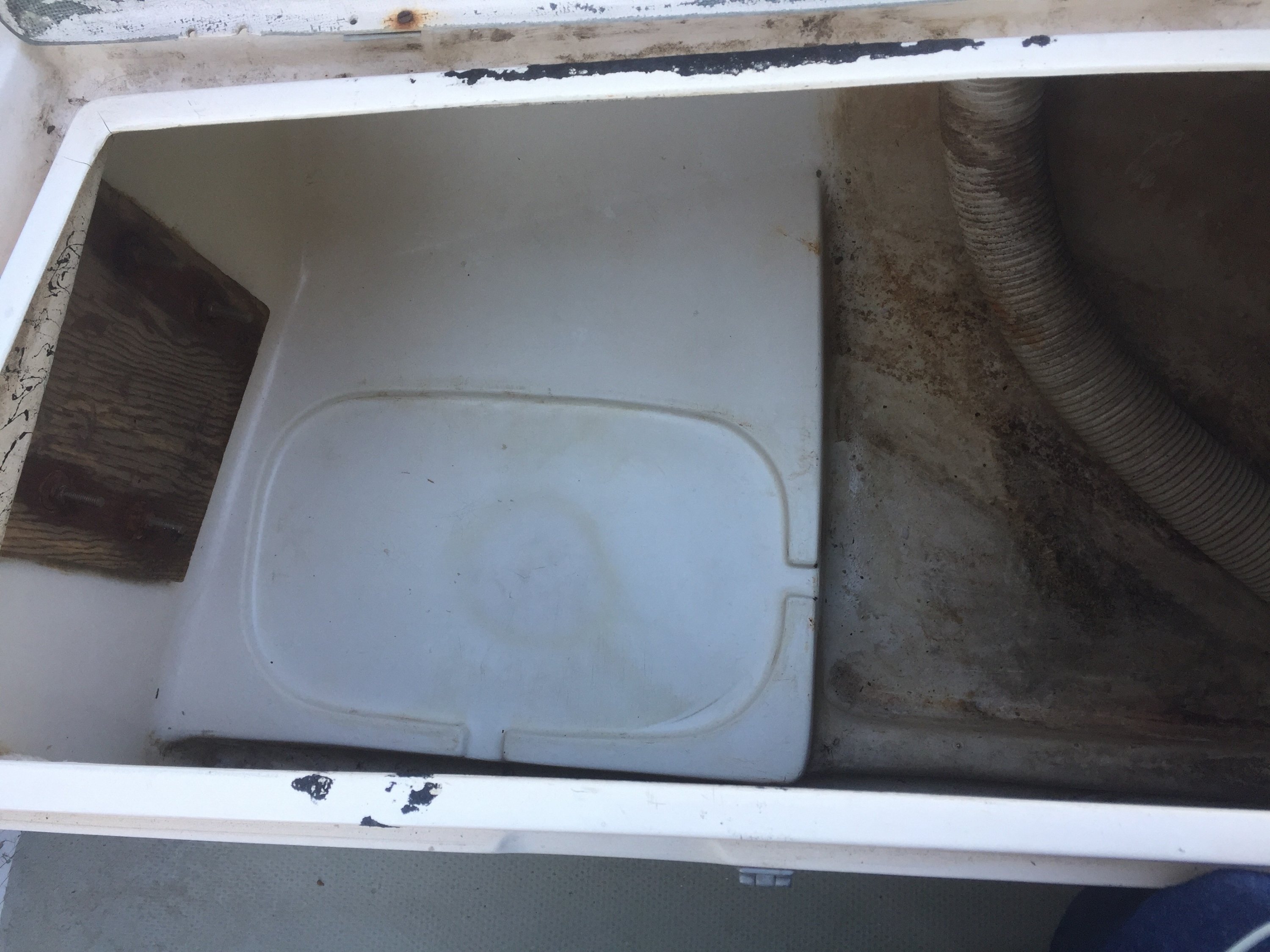

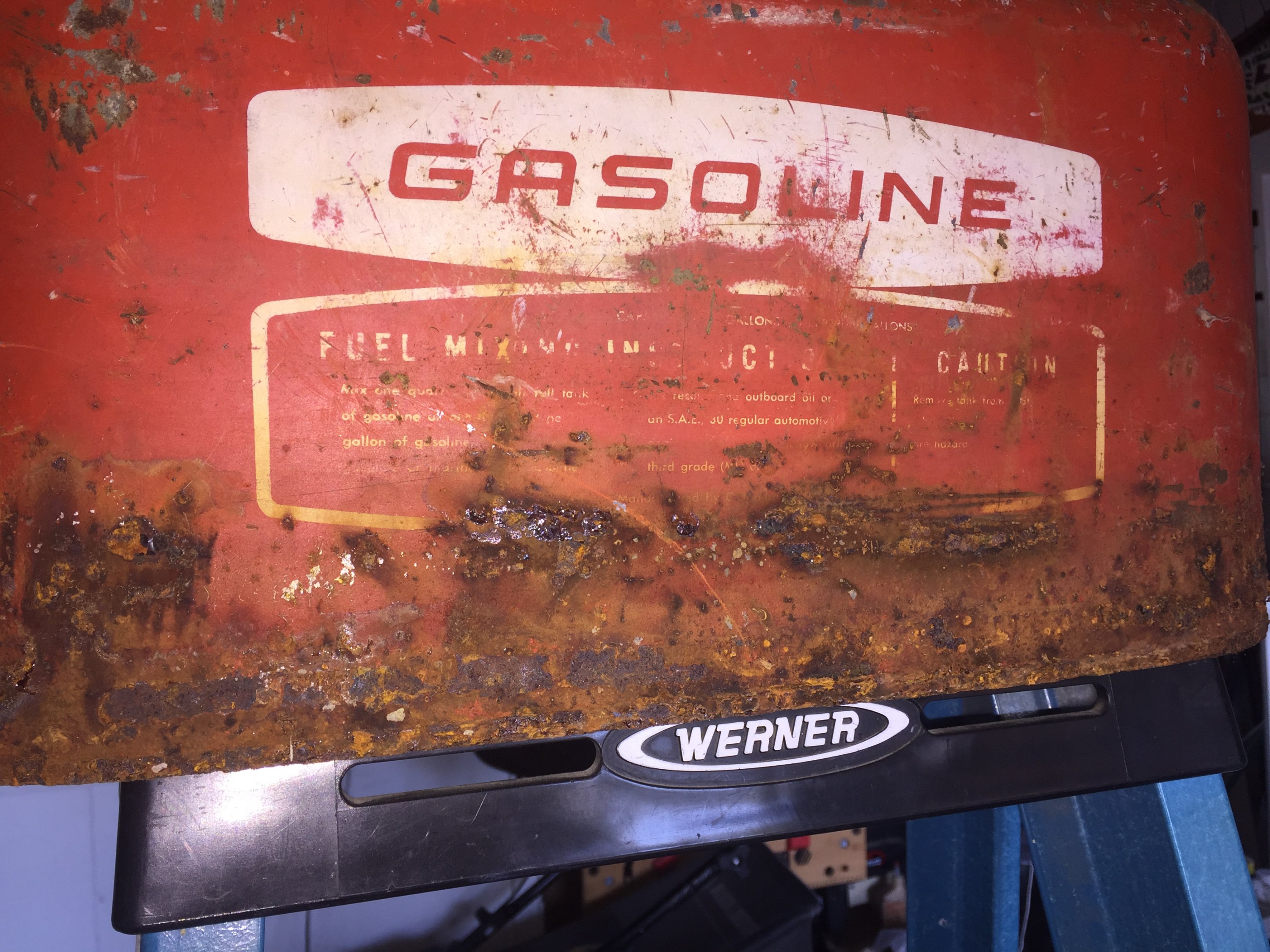

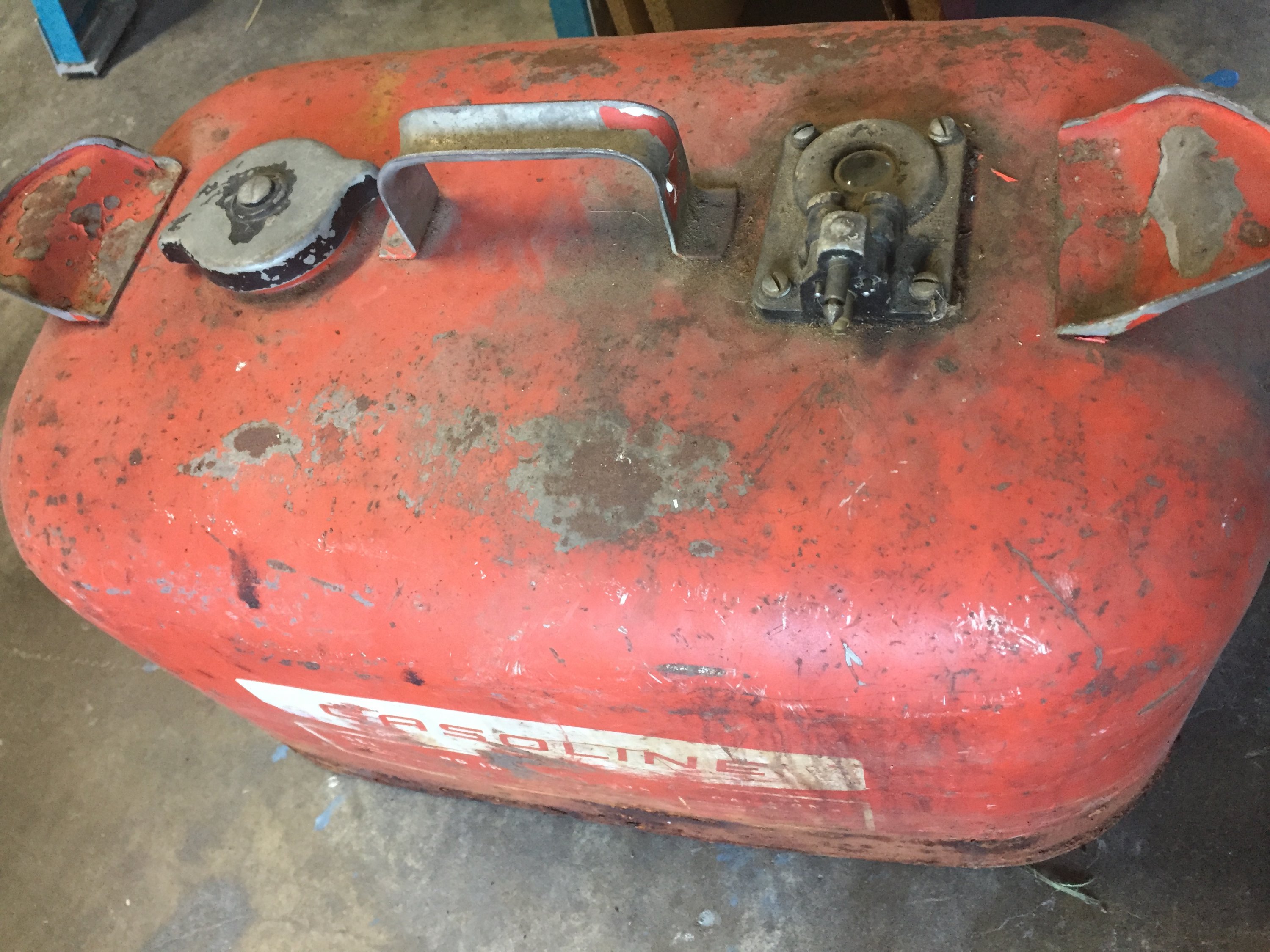

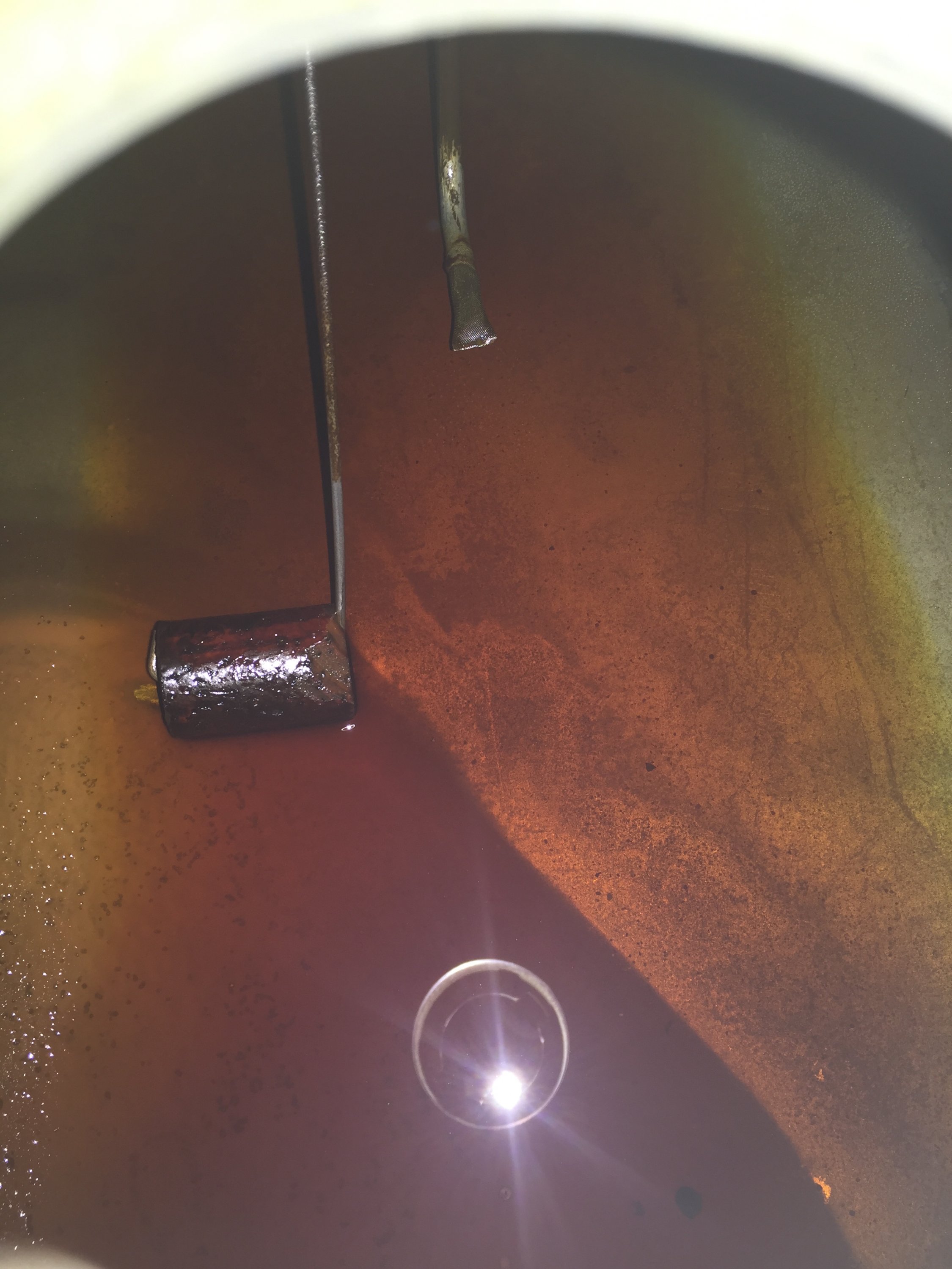

CaptDon01,
Just dug this old gas tank out of the port compartment. It was all the way forward near the dinette seat. Is it the original tank?

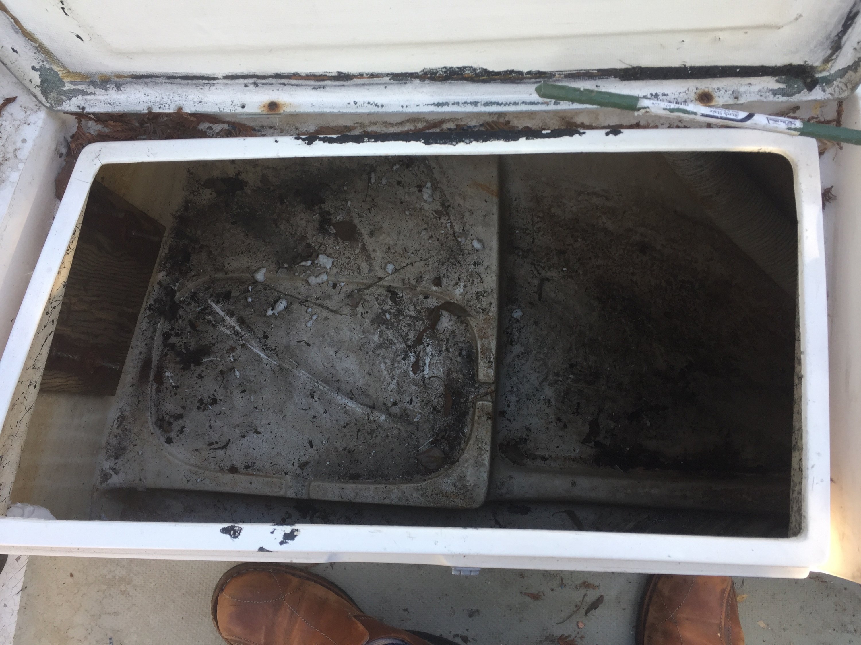

I didn't try it in the area recesses for the tank, but it appears to be close to the dimension-wise. Here is a before and after (cleaning) of the tank area. Also a pic of the compartment. I have some cleaning to do!

Sacto Dave, post: 1329103, CaptDon01, Just dug this old gas tank out of the port compartment. It was all the way forward near the dinette seat. Is it the original tank?
Looks like what I experienced many years ago when I finally could get to my C-22 after the Great Midwest Flood of 1993. The old metal fuel tank rusted through and the fuel leaked into the hold. The tanks were supplied by the outboard manufacture, not Catalina Yachts, but the popular engines were the Johnson and Evinrude's, which used the oval tanks that fitted into the liner in the cockpit locker. By the time I got to my boat months later and discovered the failed fuel tank, all that was left was an oily film. Placing the fuel tank in the portside cockpit locker was just a bad design.
Don
Likes: Sacto Dave

Looks like what I experienced many years ago when I finally could get to my C-22 after the Great Midwest Flood of 1993. The tanks were supplied by the outboard manufacture, not Catalina Yachts, but the popular engines were the Johnson and Evinrude's, which used the oval tanks that fitted into the liner in the cockpit locker.
Don
Sorry to make you relive that experience, Don. I just picked up a '99 5hp 4s Evinrude that looks brand new. Tried to have a tank, hose and bulb included, no go. Looks like I can get a new tank around $100. Thought about cleaning and painting the old tank, I think it looks cool.

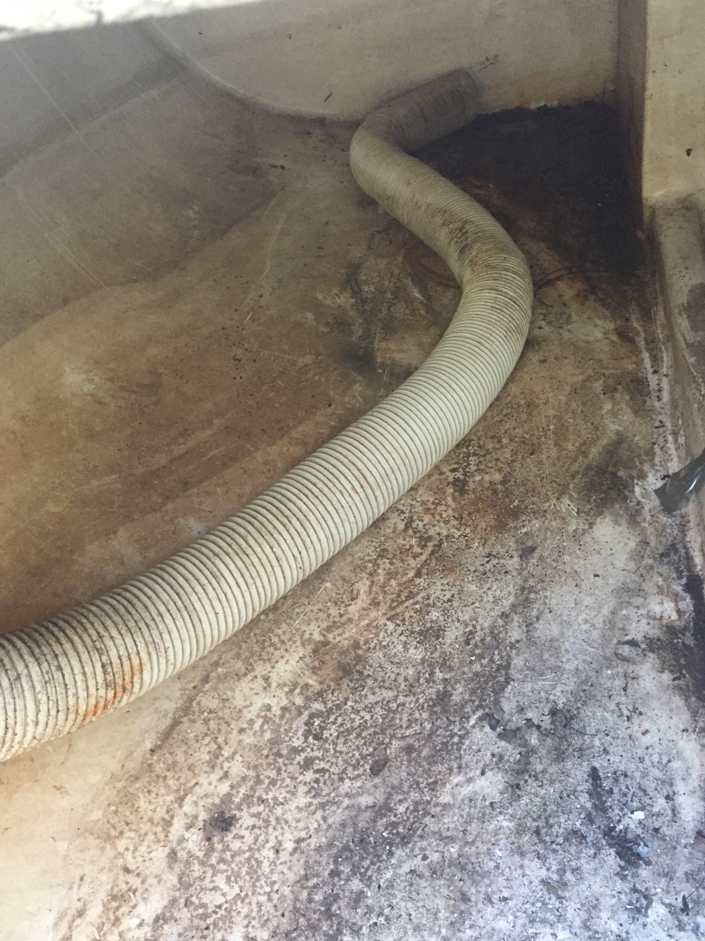

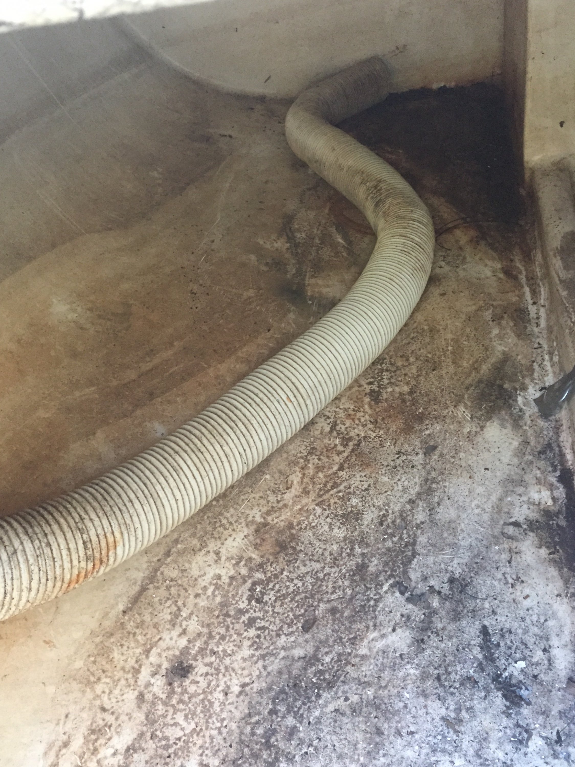

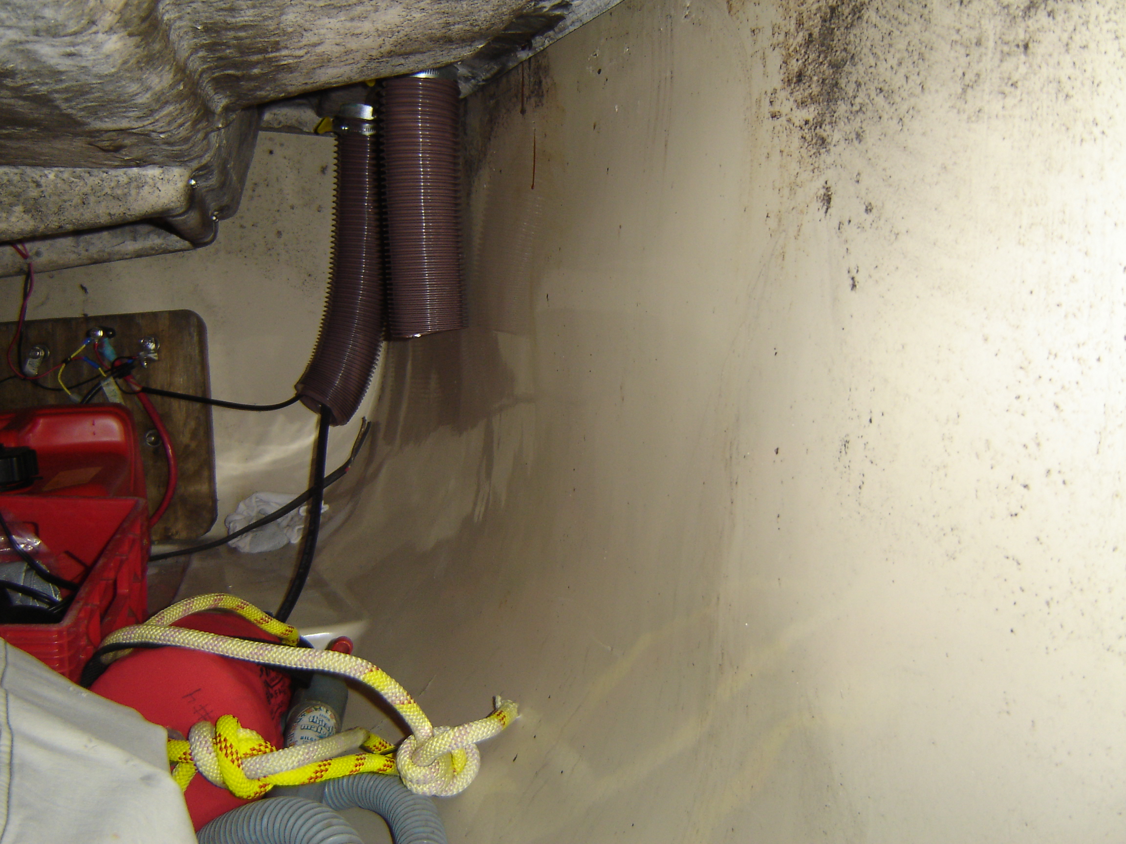

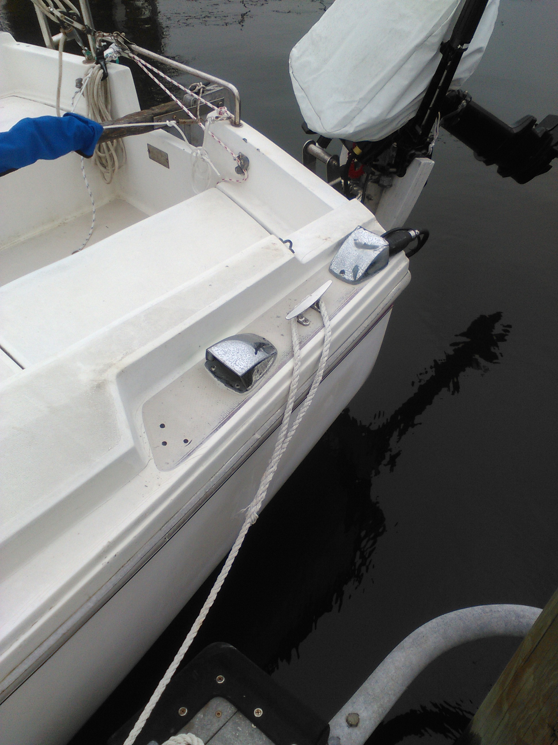

This is what it should look like with the cowls and vent tubing as designed and meeting the CG regs on tube length for inlet and outlet. My new 3 gal tank doesn't make any smell but the older 6 does, maybe older gasket on tank and both are equipped with through cap vents.
Likes: Sacto Dave

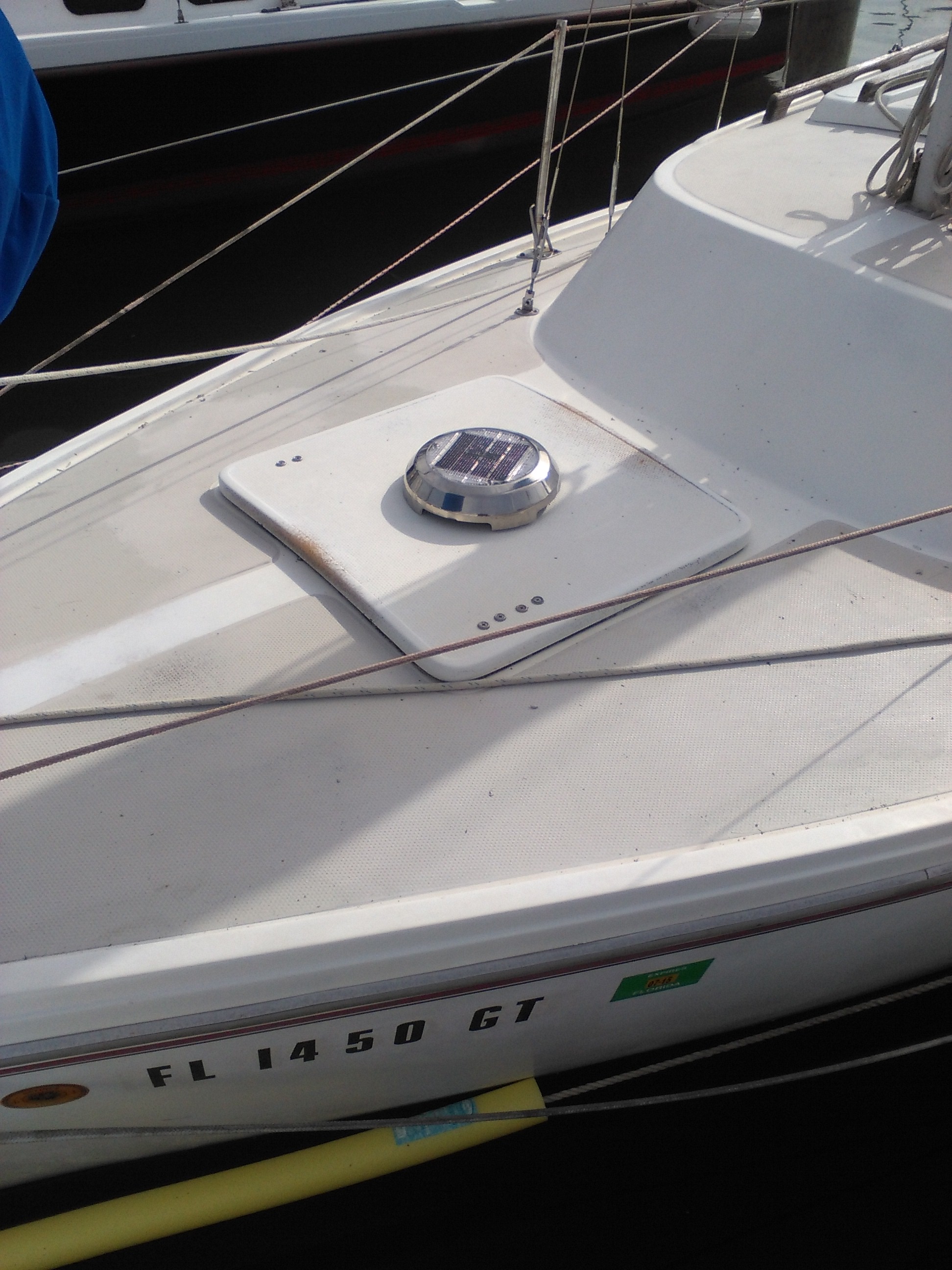

Jun 15, 2016
212
Catalina 22 Lake Thunderbird
Thanks @Jacktar I was wondering. I'm about to add the cowl vent. I need to get another. I only bought one. I also am adding a solar vent over the v-berth to run as you said. My boat has no ventilation on it at all. Thanks for the pic of how the hoses should be set up.
