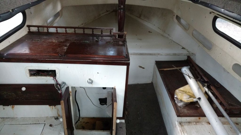

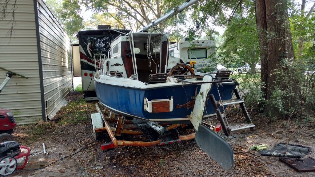

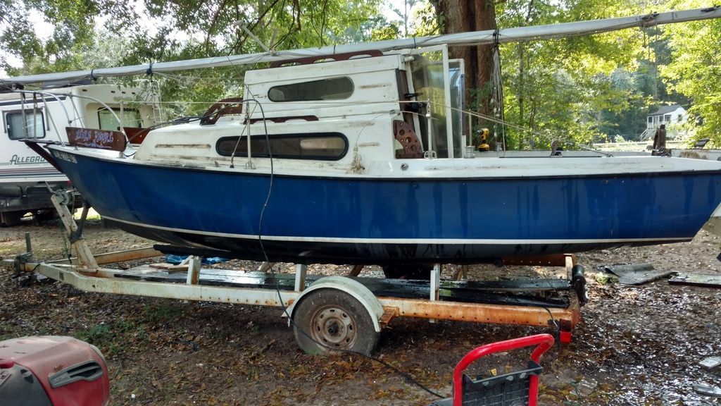

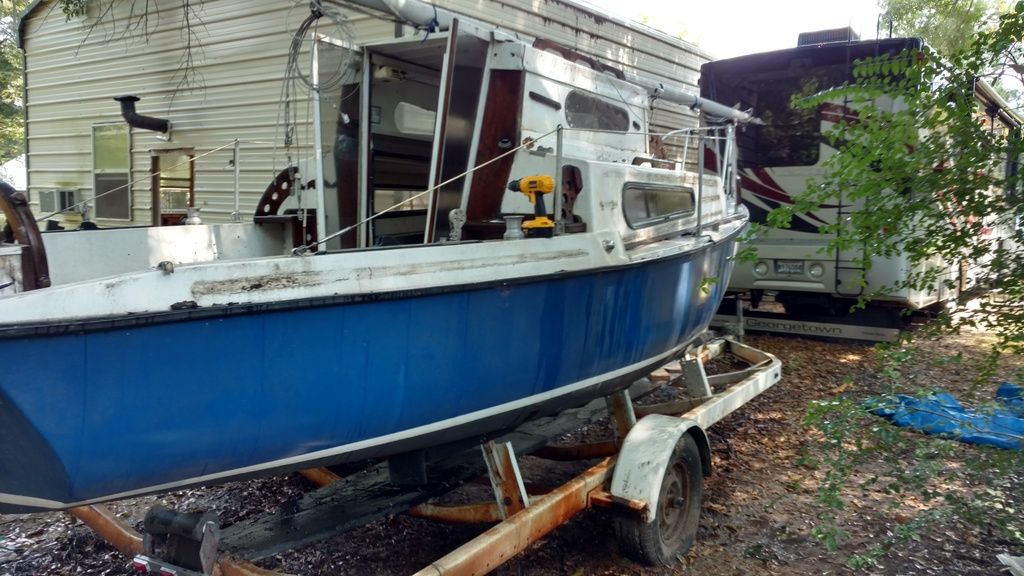

The first thing is to inspect that addition to the cabin roof and make sure it did not weaken something. Did they just raise the pop top and seal it in permanent? Having lived in Mobile Al in the '70s I saw a lot of South Coast boats out of their factory in Shreveport and never one like that.
Oct 5, 2016
21
South coast 22 LA
Yeah, Pops has a bad back so he made it where he can stand up in the cabin. He is the head architectural engineer for a shell plant down here, so I would imagine it is structurally sound. I am going to remove it nonetheless though. He did some fiberglass trimming to make it happen and nothing is going to fit back like it did so I we are going to have to do some tweaking for sure.
Oct 5, 2016
21
South coast 22 LA

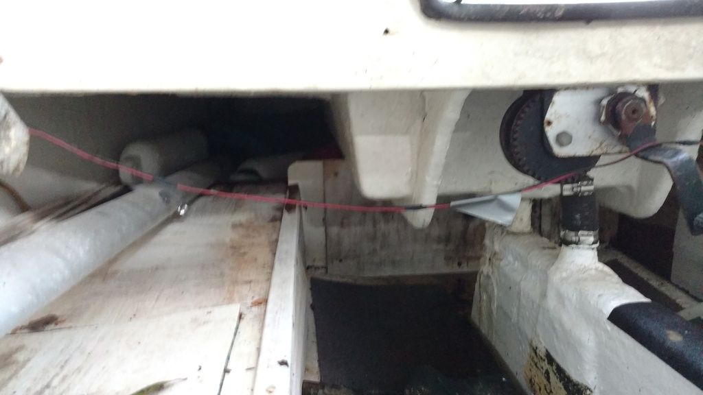

If you notice, pops rigged up a wheel on this puppy instead of a tiller. Are there any advantages to a tiller over a wheel or vice versa? I was thinking of going back with the tiller, but a wheel does have some serious cool factor. thoughts?
Aug 3, 2012
2,542
Tillers have more "feel," are faster to control, can be controlled from a multitude of positions in the cockpit, especially with a tiller extender, sometimes have more "throw" for the rudder angle, don't require an emergency steering wheel if it breaks :) ...
Wheels can take less room in the cockpit, can give you more leverage depending on the design, can require less pressure depending on sailboat balance, are less awkward when there are lots of passengers in the cockpit, are less awkward when needing to handle lines in the cockpit, are steered like a car, so there is no reverse controlling needed like with tillers, the centrally mounted pedestal guard (I see your wheel is transom mount) can give you a nice place to hang things, mount instruments, or mount a cockpit table.
I am sure others will come up with many other great thoughts!

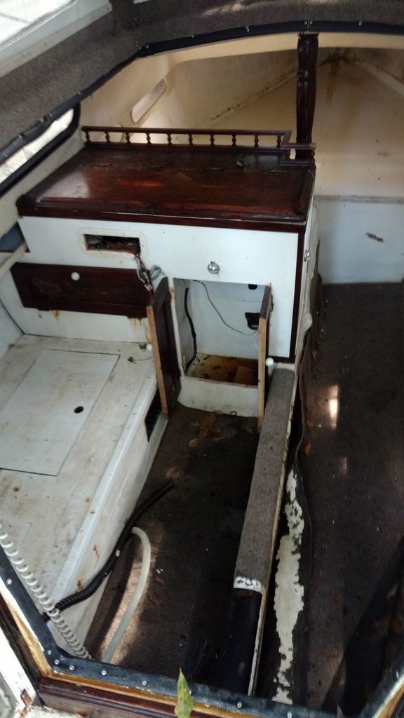

Have you thought about what you want to do with the interior yet? If you find that you need to rip out all of the old wood, you then have to option to redesign your interior. But much of the berths etc also function as stiffeners for the hull so need to put something back along the hull. When manufacturers made these pocket cruisers, they tried to make them look like a living room... but when you actually go on extended cruises in them you quickly learn what you really need. You need convenient storage. For example, on my Mac 22, I eventually removed the galley completely. I never cooked in the boat but always out in the cockpit. The galley sink just became a place to stash my wallet and keys when I was sailing and it took up way to much room. The extra room from the galley extraction allowed for an extra berth and for me to make some storage mins under the port side under-cockpit area. If I were redesigning the V22 again, I would think of the berths exclusively as areas to sit and maybe play a hand of cards etc at anchor, the area under the cockpit exclusively as storage and I'd build in hooks to hang eno hammocks for sleeping. Lastly, I'd buy a bbq grill for the stern rail in the cockpit. And I'd think of the cabin as a place to get out of the rain, hold stores and to sleep. Cooking is done in the cockpit and so is most of your sitting around.

I found a long since dead squirrel on the V berth cushions, so I think I am going to recover them all on the interior for sure, and maybe even the exterior too. Do I need to get any specific kinds of fabric? Is there anything affordable that I can get at a Hobby Lobby type place?
12,968
Squirrel... you got lucky. :cowbell: I found a rats nest in the floatation foam and a hornets nest (as in Winne-the-poo) under the galley sink...:yikes: you never know what you will find in an old boat.

One of the first thing to check is the bulkheads that the side chain plates attach to. Originally they are plywood and due to normal leaking they rot. When one let's go the mast will go over the side. I have been there and done that. Now I would recommend replacement with chain plates like the MacGregor that attach through the side of the hull. I have had SC22, Mac Classic and now have a M26S.

I feel like you have some other issues to check while you worry about fabric...
I think others are suggesting this too.
Bulkheads
Chainplates
Deck core
Rudder
Keel
Stays
Shrouds
Sheets
Sails
Lines
Mast
Boom
Blocks
Winches
Turnbuckles
Shackles
Traveler
Cleats
Clevis pins
Split rings
Are these on your list?
How about the trailer?
