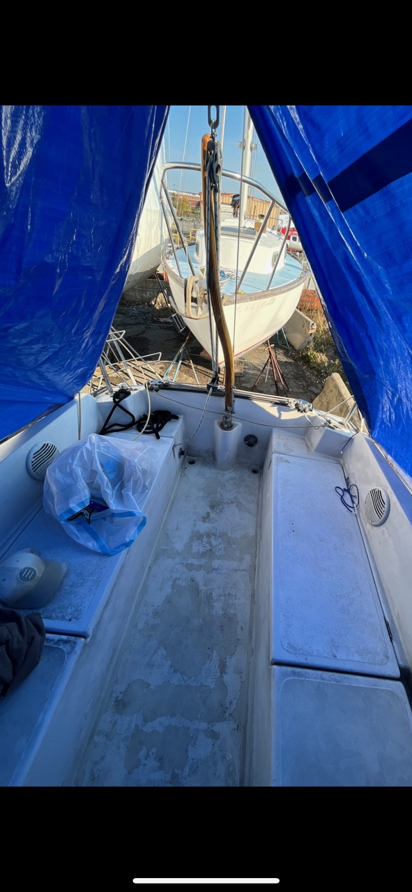

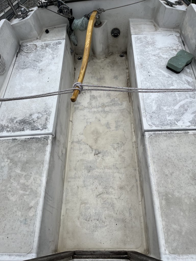

Paint flaking and tiny surface level spider cracking. There is a non slip like sandpaper texture on the benches and floor. Should I remove this somehow before gel coating cracks and just paint everything? What is proper order of steps to make a nice clean cockpit start to finish.
There is no core rot problem. Thanks

Gelcoat cracks and crazing typical do not extend into the fiberglass, so it is unlikely the core in the lids has become wet.
The first step is to remove all the flaking paint and thoroughly clean.
Hot off the press is Andy Miller's latest video on painting gelcoat nonskid. This video will give you a good idea on how to proceed. Boatworks Today is one the most valuable resources online.

@dlochner Thanks, Probably clean it/ power wash and then light sand to put a part 1 top surface coat on. Im guess I can do this same process on the entire top deck of the boat? Might be dumb question but if it's a thin layer of paint and sanding down to the gel coat cause any gel coat damage if sanding too deep/hard to the gel coat.

Also will sanding on the non-skid wear and smooth the non skid popcorn/sandpaper texture?
Gelcoat is only cosmetic, it is not a structural component. Yes it is possible to sand through the gelcoat and yes, sanding the non-skid will smooth out the non-skid making it skid. Painting over the nonskid will also fill in the non-skid. Andy goes over this in the video I shared.
To do the job properly, clean and sand everything smooth, then use a fairing compound to remove gouges and uneven spots, then prime, and paint.

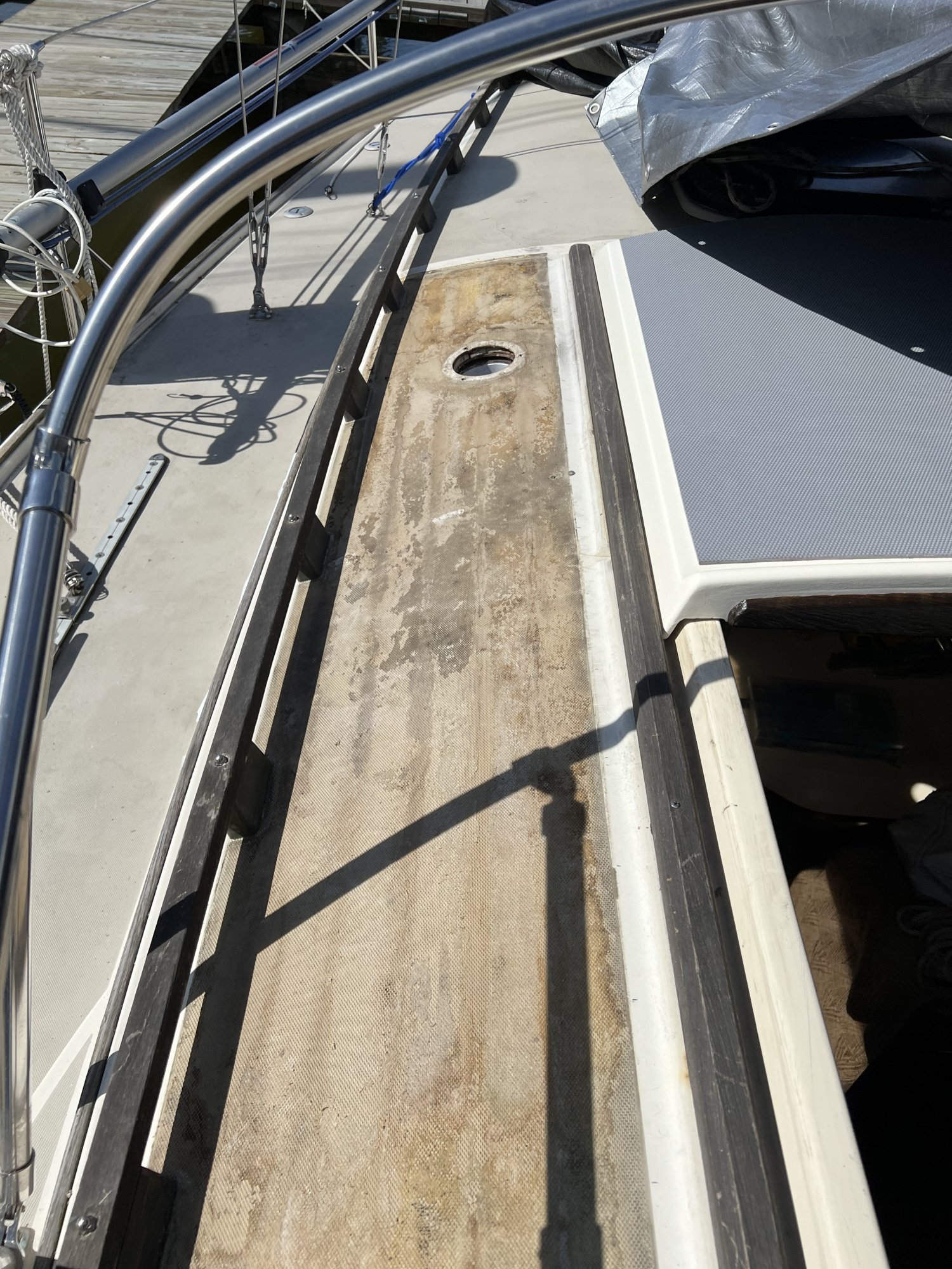

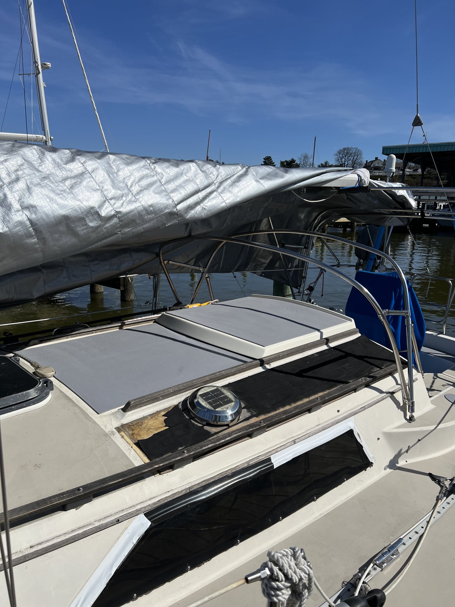

My first application of faux teak lasted total of three years before being removed. It was a cheap product and not SEADEK, just to be clear. After the second year, the UV broke the genuine simulated teak wood by turning it into dust. What was left over was the black underlay. It was also not waterproof (it soaked up the moisture) as the product was not closed cell. I am in the midst of replacing the old with real 5mm thick gray non slip SEADEK. I have tested a sample swatch for over a year now and find it not to be affected by UV. Here in the picture below you can see the old and the new side by side.
and a picture of the cabin top after removing the old faux teak and removing the glue. Feel free to PM me for any questions.
