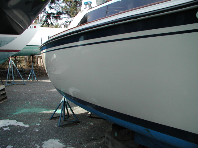

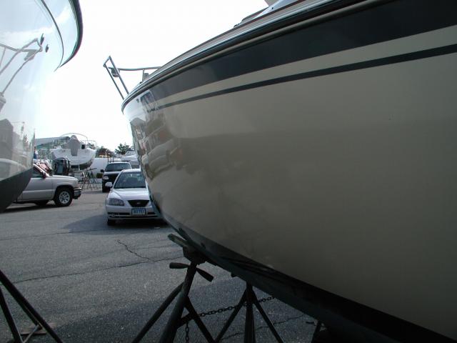

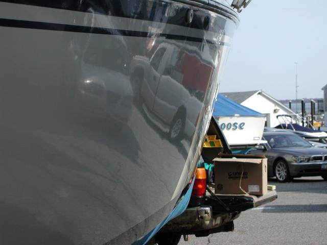

This '84 hull which had some pretty bad water line and up brown stains and had just an OK shine came out great after doing the full Monte...acid wash, compound and glaze. If fact after I saw the results down below I did the same to all but the non skid above. Another thanks to Mainsail and others for guiding us to nirvana.
The Marykate On & Off gel is so easy to use a caveman could do it. The rest gets your upper body , uh um...entire body into shape in a whole different way. :eek: It is well worth the pain!
The pics are after wax but it looked THE SAME before the wax. As was said "don't count on the wax for the shine". I used:
Marykate On & Off gel.
3M Marine Rubbing Compound - wool compounding pad.
3M Finesse It II - foam pad.
Collinite 885 - hand applicator - hand removed with microfiber towel.
And of course the venerable Makita 9227 polisher.
The wide shot shows the hull down to the waterline and the incredible job the Marykate did. The other two are just fun for me to look at...the gelcoat really came back nicely.

Looks great, I use the same system and I am still always amazed at how well it looks

Rob:
It looks so good. I don't wan to hijack your thread but- For what purpose is the throughhull on starboard side at pinstripe (just below rub rail)?

Mick222, hermit - Yup, holding tank vent. The V is essentially converted to a head with a Sealand 975 MSD 5gal. Cusions are still set up in there though.
