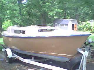

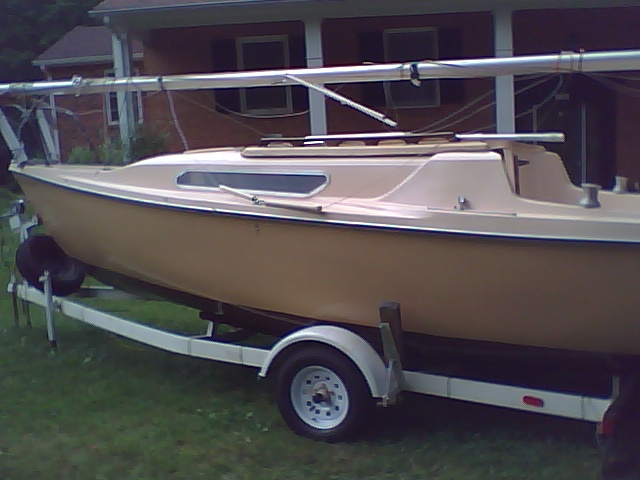

I restored a Mac 22 years ago. I removed all of the ports and repainted then I used butyl tape to seal the windows. Purchased it from @Maine Sail.
Good stuff, easy to use.
