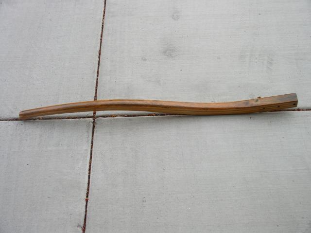

I started restoring my tiller off my 1984 Catalina 25, March 17th, 2009. As you can see from the first pic, discoloration and water seepage has penetrated the varnish over the last 3 years.

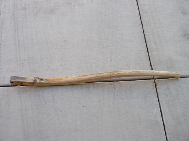

After all varnish is removed, I then use a 80 grit sandpaper (by hand) sanding with the grain only, to remove old stain. After satisfied all stain is removed (the discoloration is still present) down to bare wood, I then prepare a 50/50 bleach mixed in a steel bowl (used for salads) and used a paint brush to brush on towards the grain, saturating the wood. I did this a total of 3 times waiting for the wood to dry in between in the sun. I then used wood cleaner and a brush to get any bleach or dirt out of the wood. I let it sit in the sun to dry. See pic 2.
