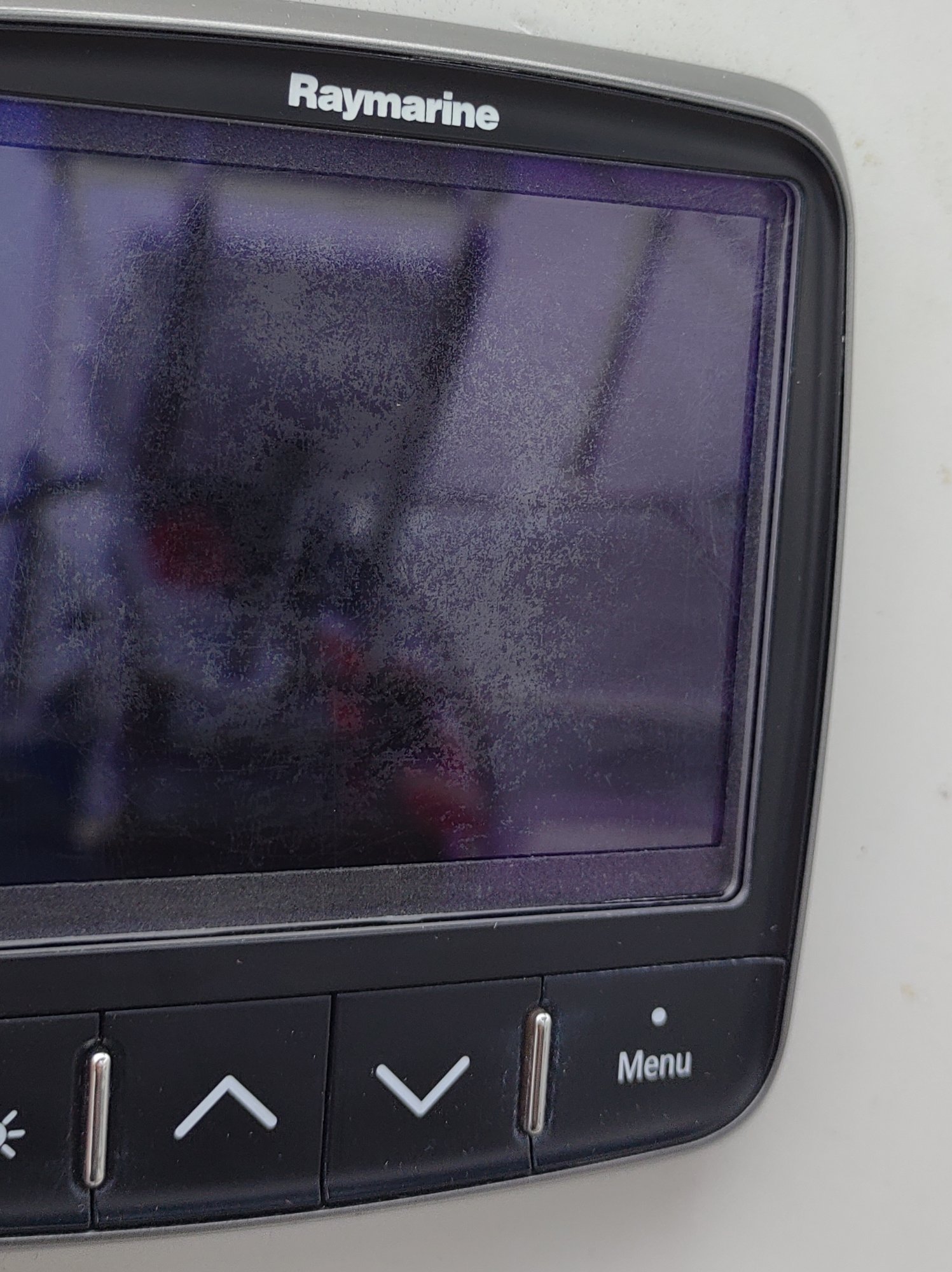

I had the same issue with a I70 multi function display that is about nine years old but was on the binacle most of it's life covered with the raymarine cover and a sunbrella wheel cover. in the spring of 2020 I put it on the cockpit bulkhead near the companionway. I always still use the raymarine cover but apparently I did a cleaning with the wrong cleaner and it messed up the finish of the screen as well. I really didn't think really too harsh but it somehow got under the cover.
I originally thought I might use something like a headlight restorer but am curious if anyone had full success with the suggested Novus cleaner and which one?

For what it's worth, I tried the Novus product and it unfortunately didn't work on my I70 instrument display. My instrument display looks the same after following the directions carefully.
I asked Raymarine customer support before using and got the following response:
Subject
I70 screen restoration
Thanks for contacting raymarine
Is possible to try the fine scratch restorer but if the damage on the screen is not on the surface it may need
assistance of specialized personnel to dissemble the screen
you can check for repair services on your area if necessary here:
