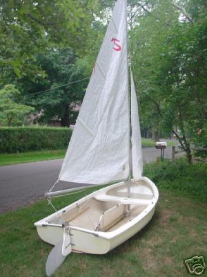

I scanned quickly through this site and it looks like it might be a Sprite. http://www.iheartodays.com/model_information.html
http://www.iheartodays.com/model_sprite.html

For parts, give Rudy Nickerson at D&R Marine a call (508) 644-3001 He was the Parts Dept. Manager at O'DAY from 1973 to 1989 (Sprite was last made in about 1970)

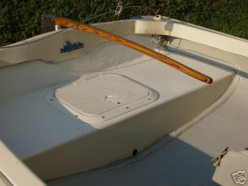

I'll include a couple of Sprite pics here for reference.
