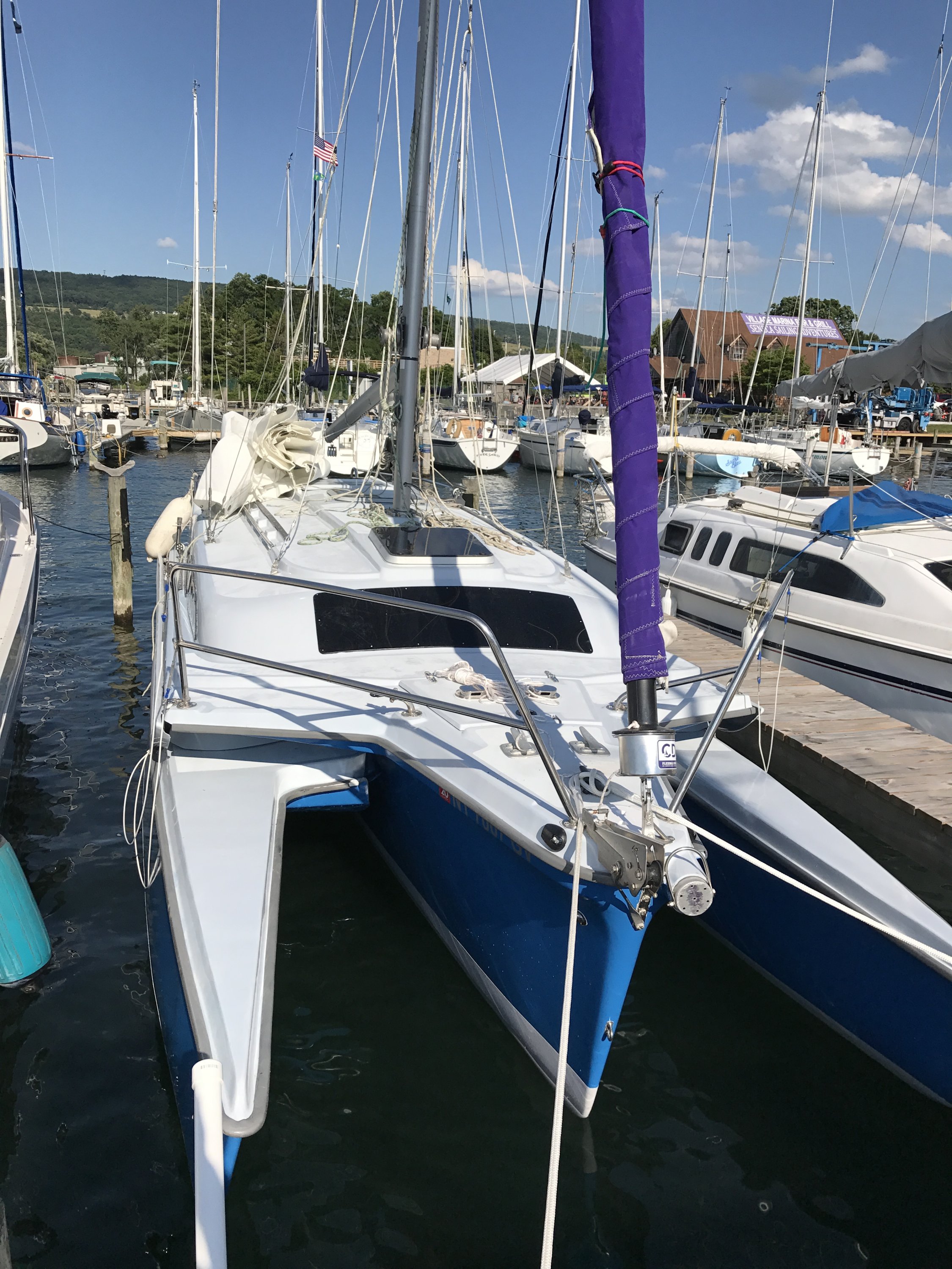

I got my new-to-me Telstar in the water yesterday! Ah! 8 months of grinding, filling, fairing, reinforcing, laminating, wiring, and painting, oh and BUYING, are done, for now!

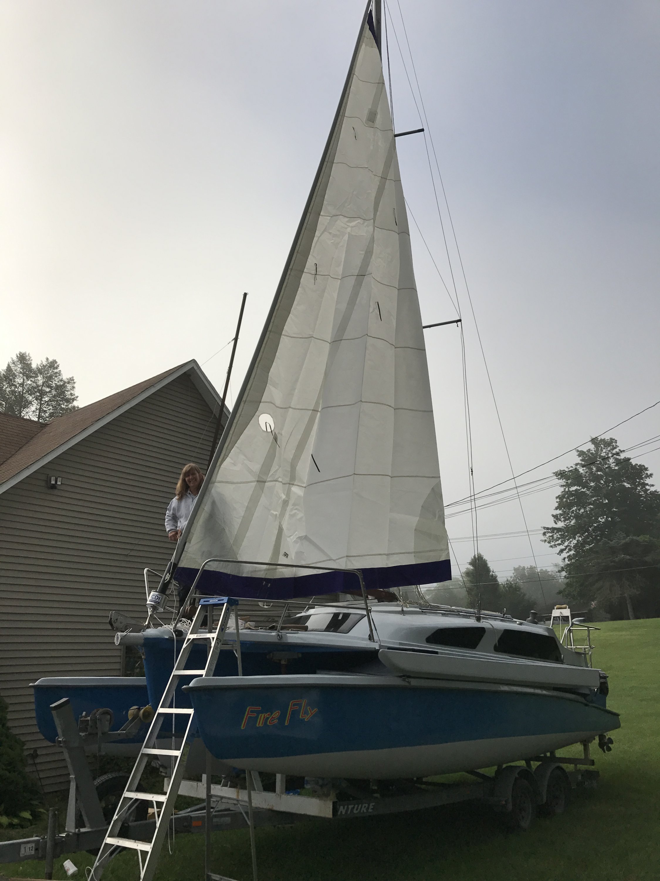

We put the mast on and stepped it to rig the genoa at home. We then unstepped the mast and took the boat to Watkins Glen. We stepped the mast on land and launched the boat. My wife did the interior.
Here she is... Firefly.

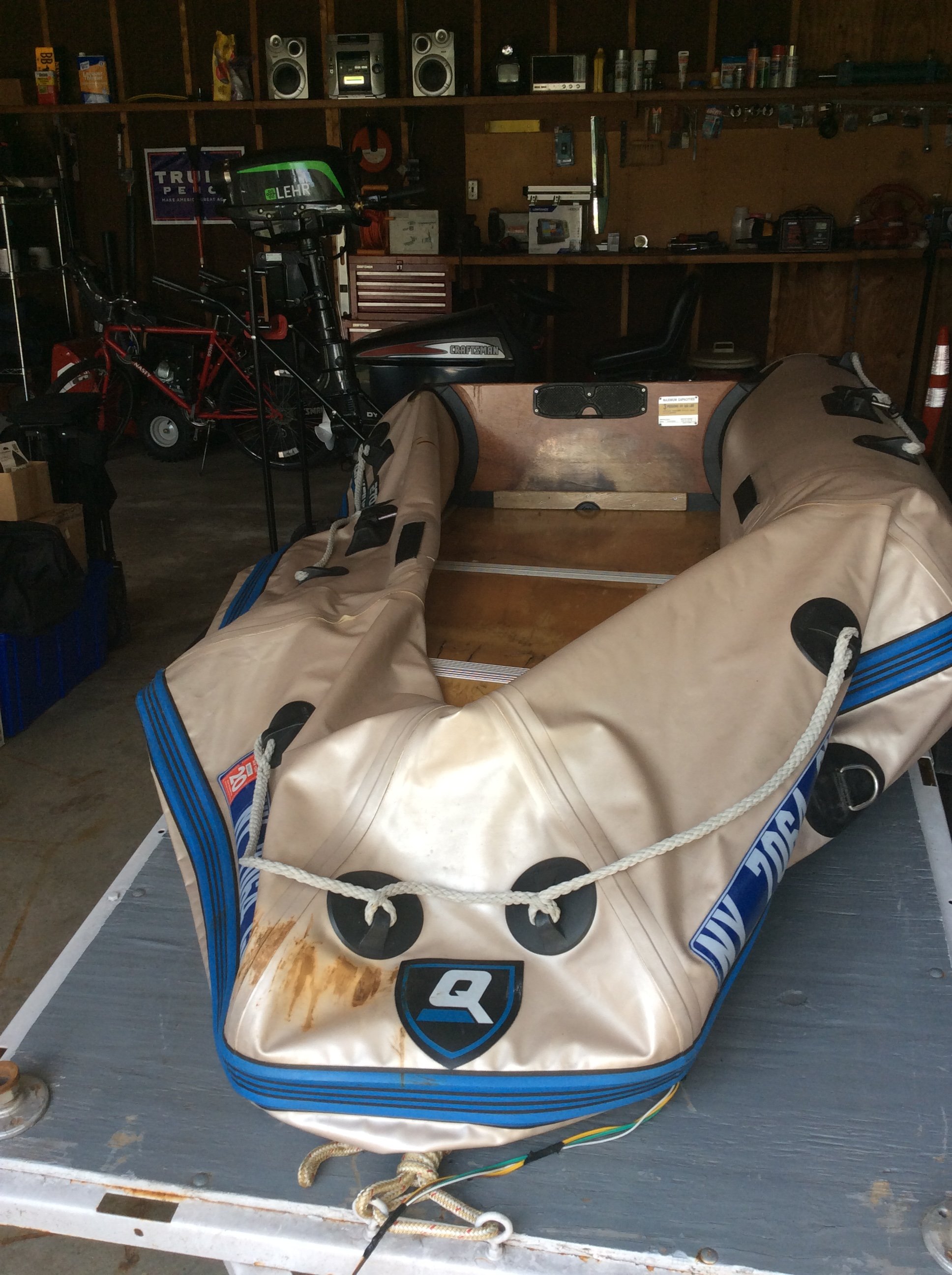

Nicely done Andrew...nicely done! We spent Sunday and Monday on Cayuga. 5-10 knots of breeze (except for that 4:30 pm Sunday shelf cloud and downpour). Our sails were down before the blow arrived and made it back to the slip by 5:30 for the shrimp and burger barbecue. We saw some awesome sunsets, had happy admirals, and didn't have to work too hard with my No. 1 crew. The only casualty was the heavily used Craigslist Dink we bought last year. A seam blew out in the parking lot of Wegmans, before I even had a chance to get it wet. Rigid dinks from now on. Looking at a Watertender 9.4 now.

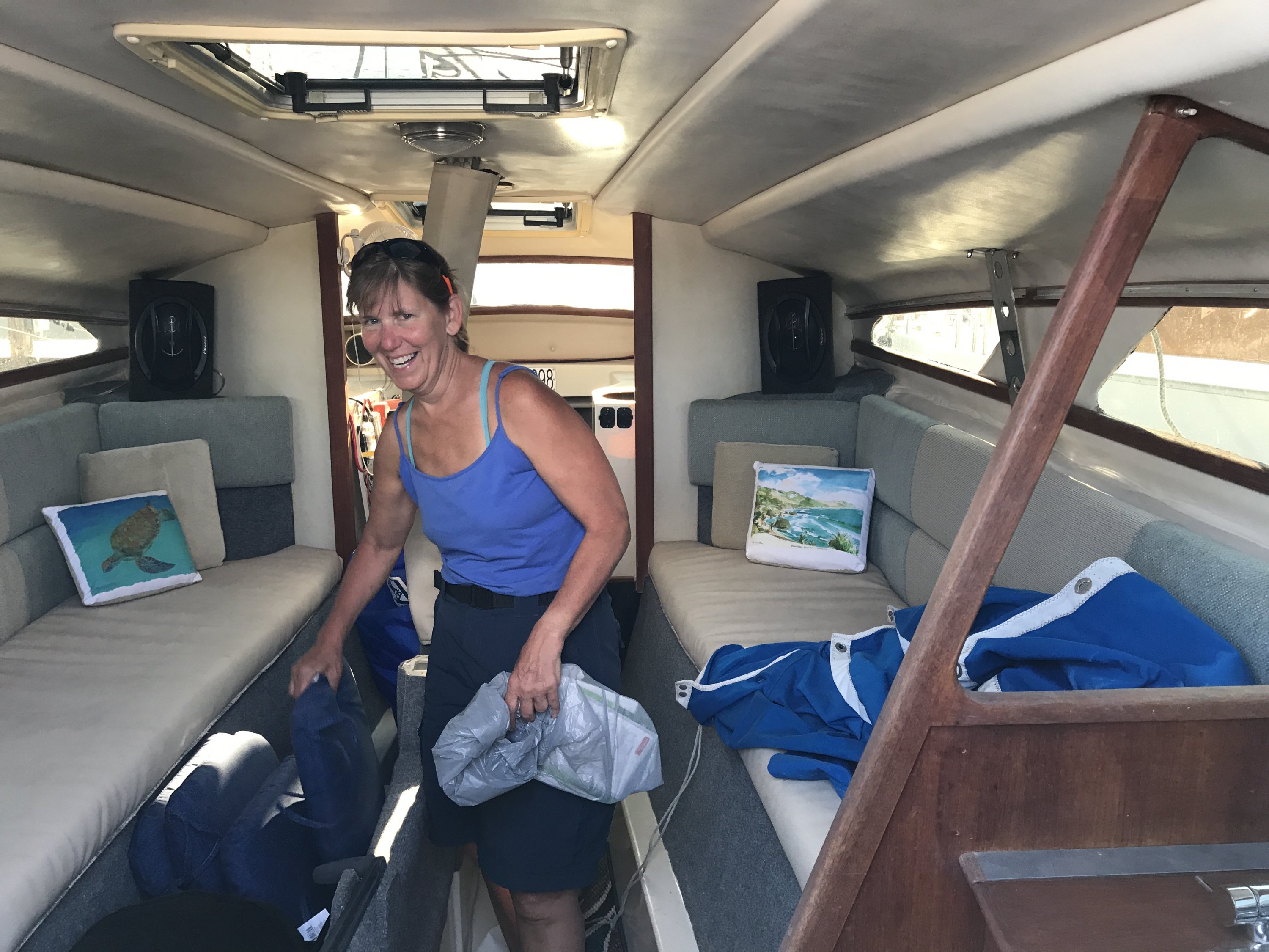

Right at 6' headroom. Everyone expects a really small cabin when they see it, but then they are surprised! It come with a marine head that we removed. I did lots of cool upgrades.

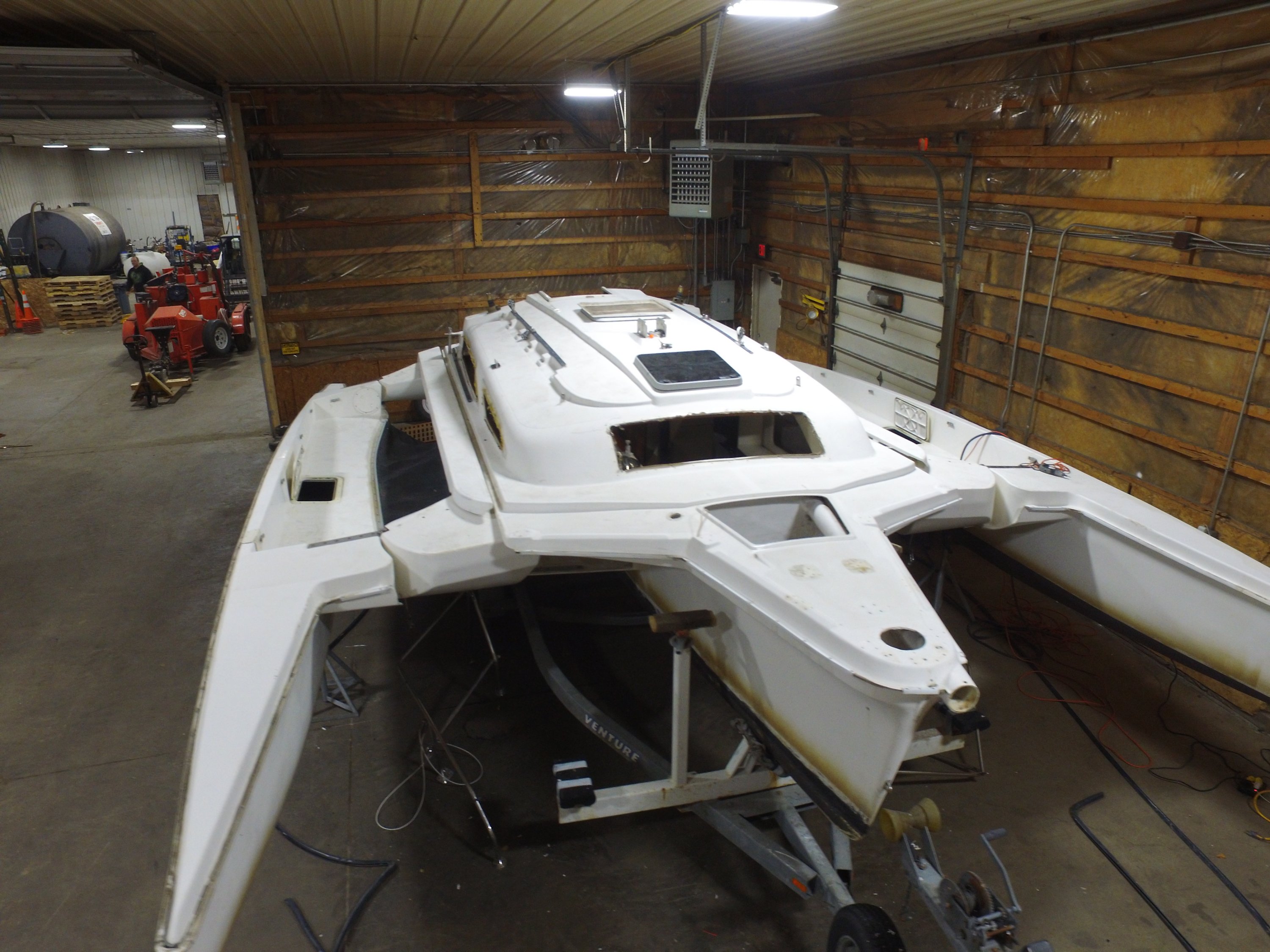

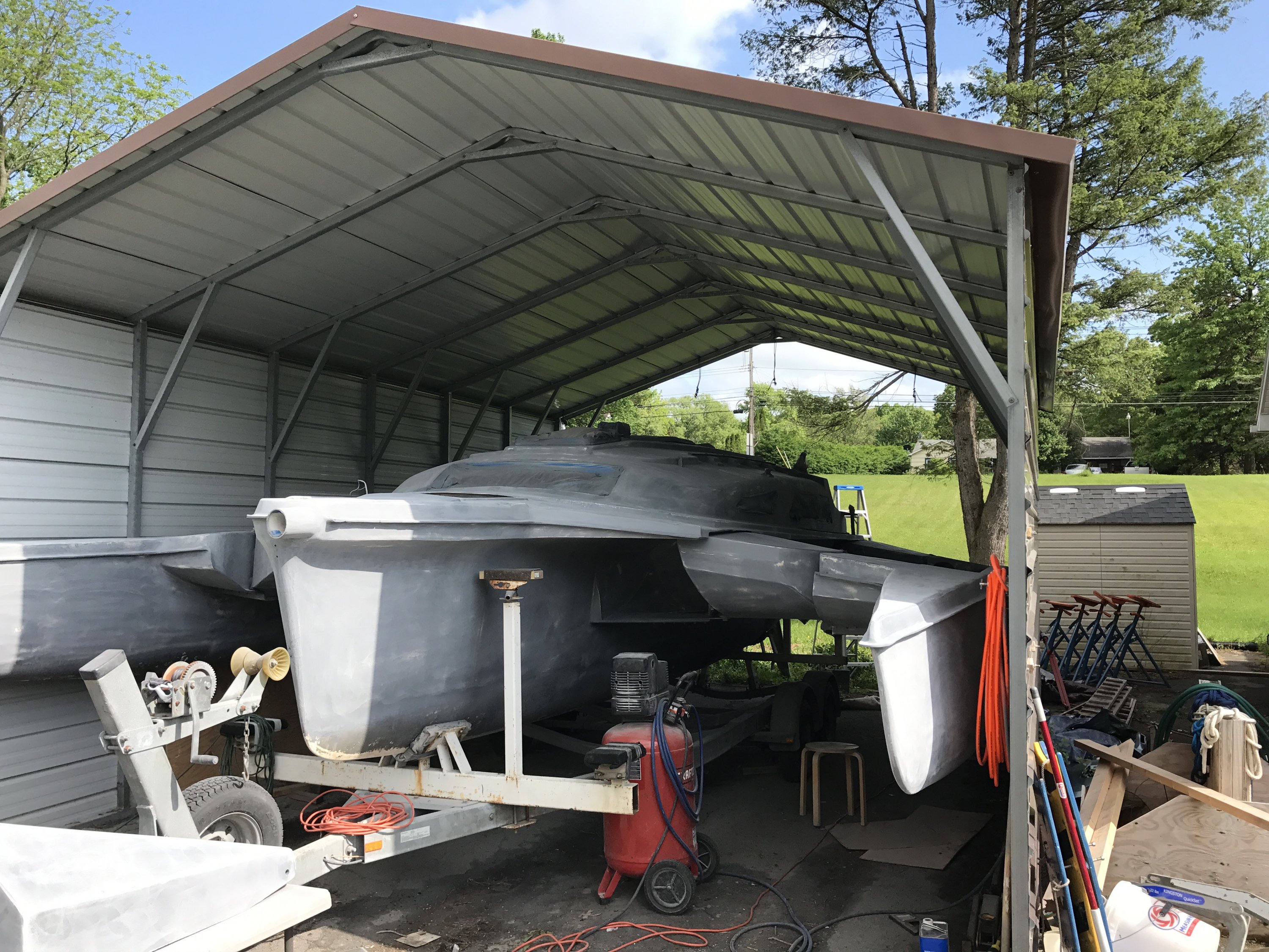

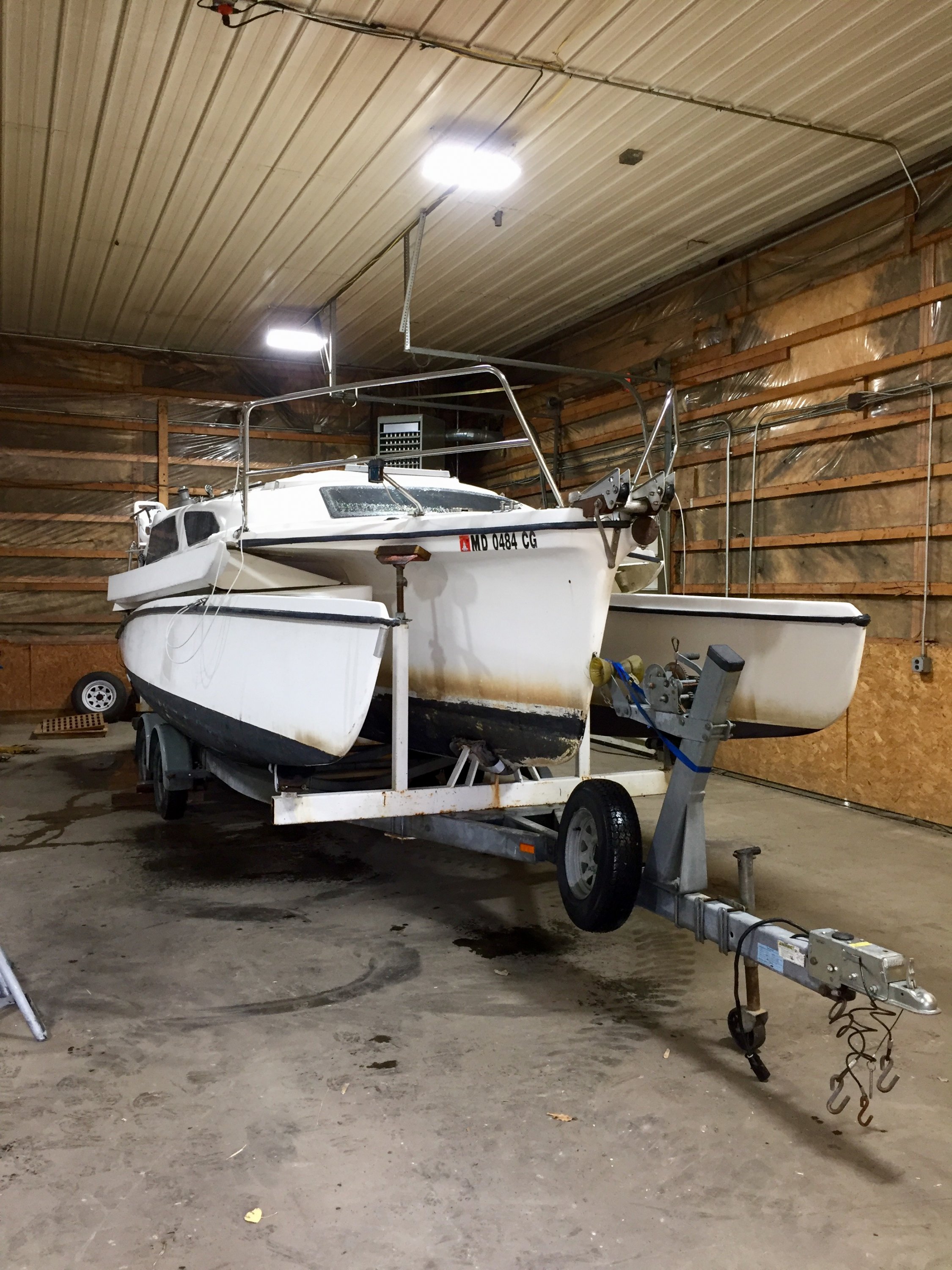

Here are some photos of the restoration:
The first is a "before."

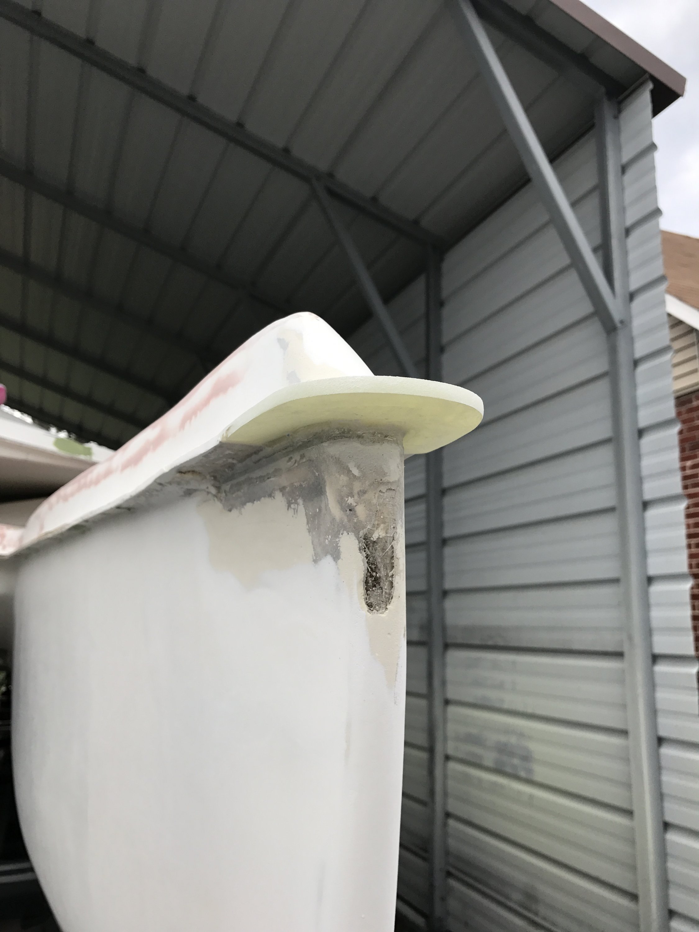

Then we stripped the hardware.

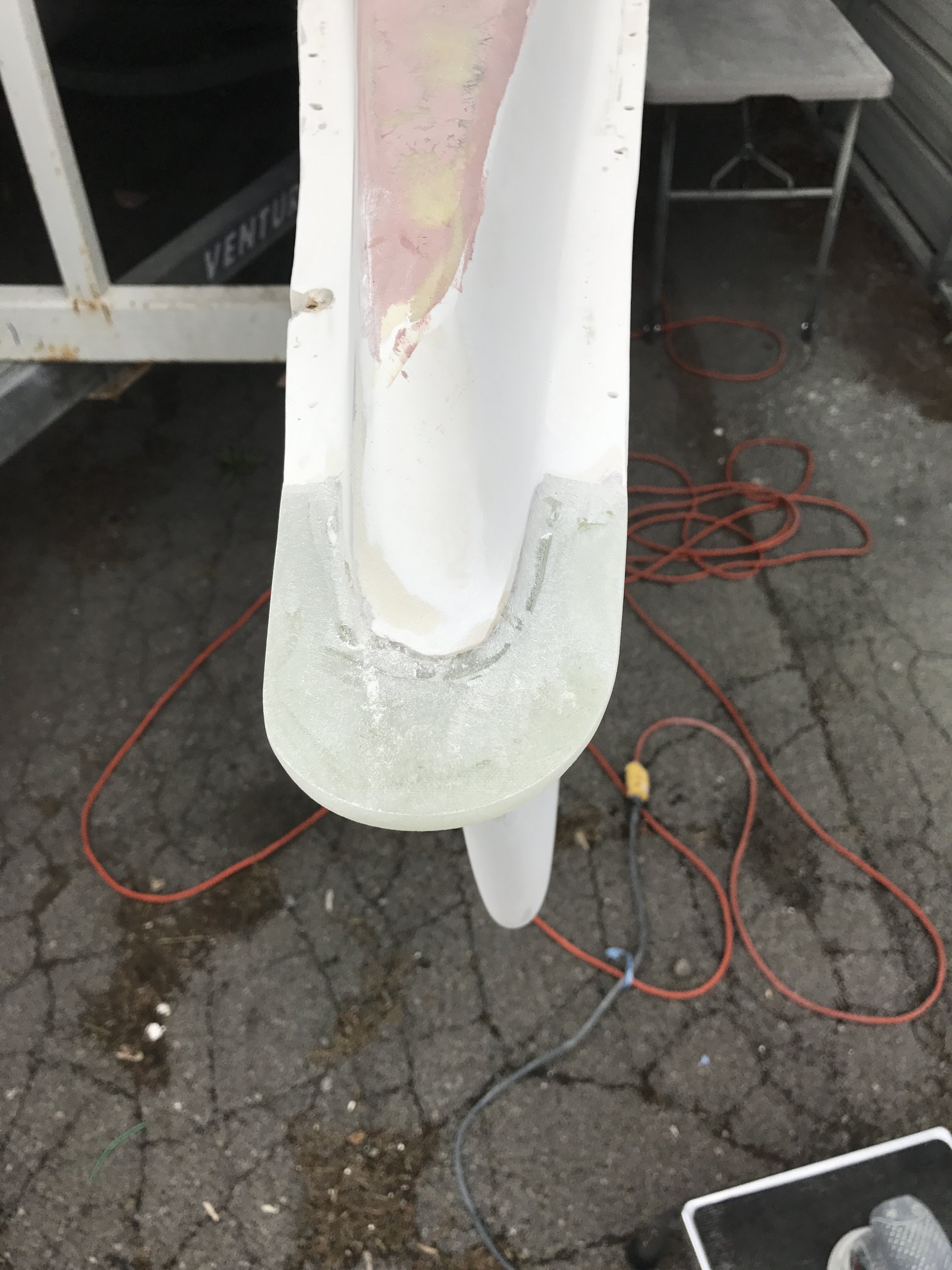

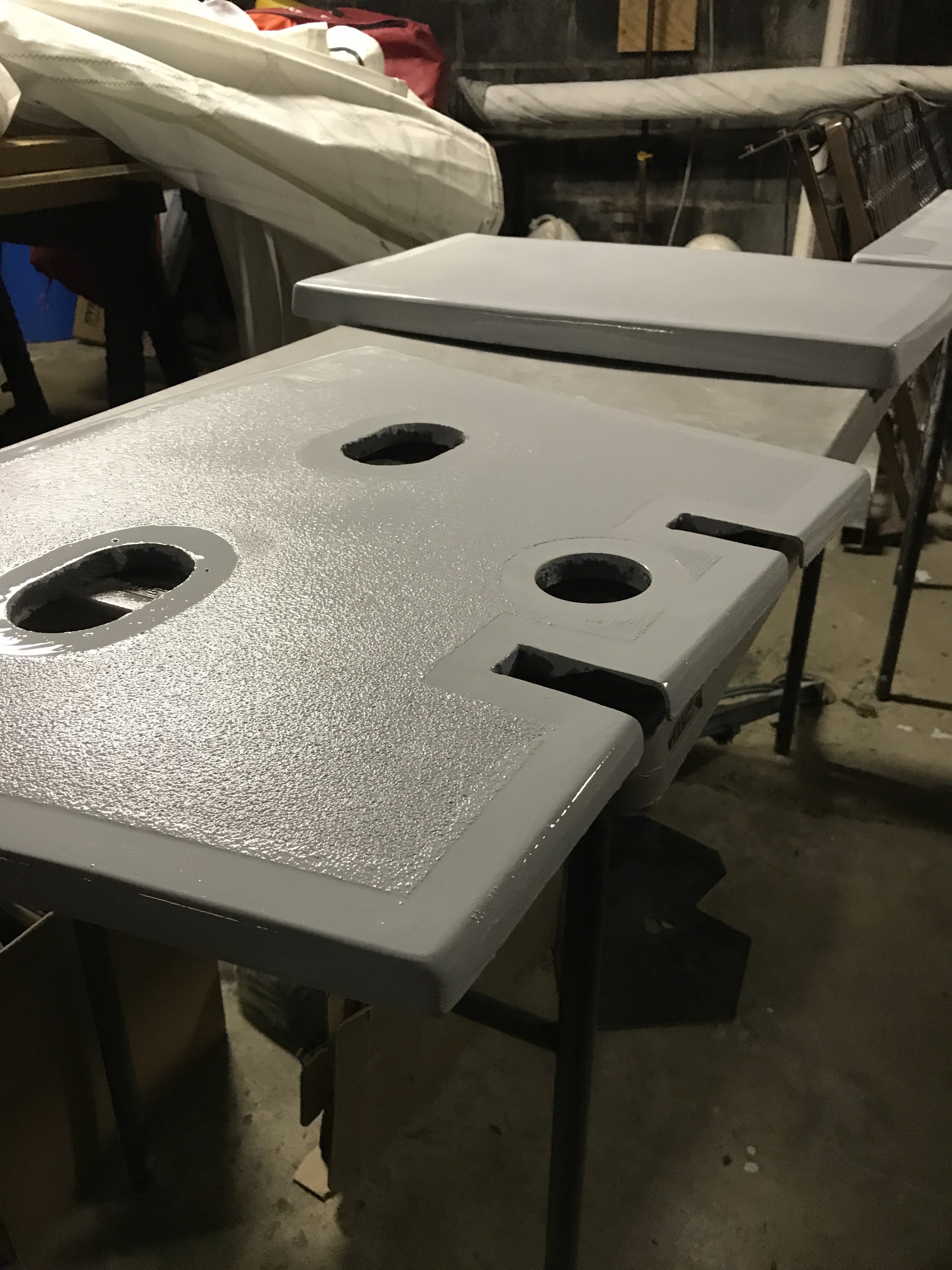

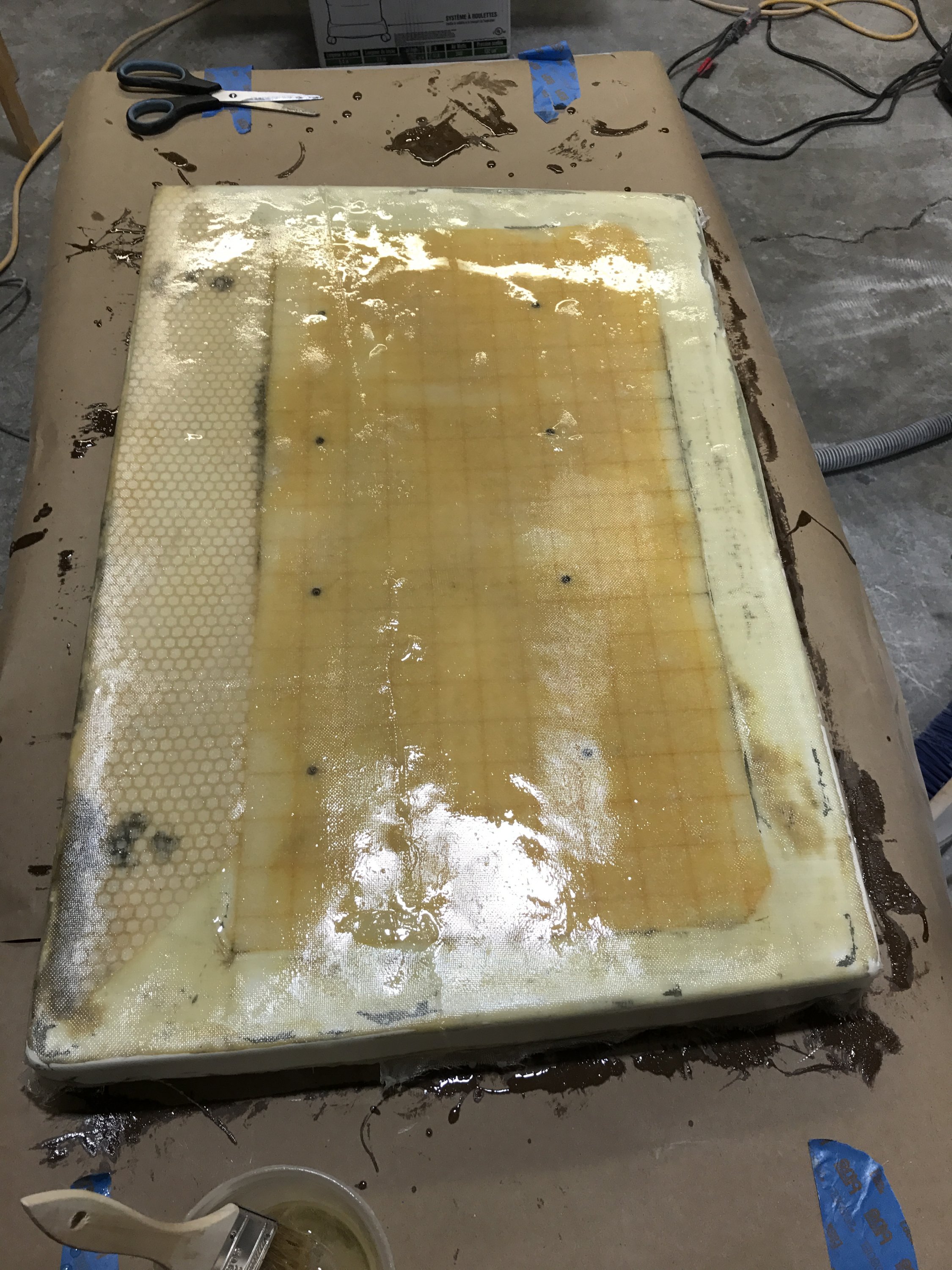

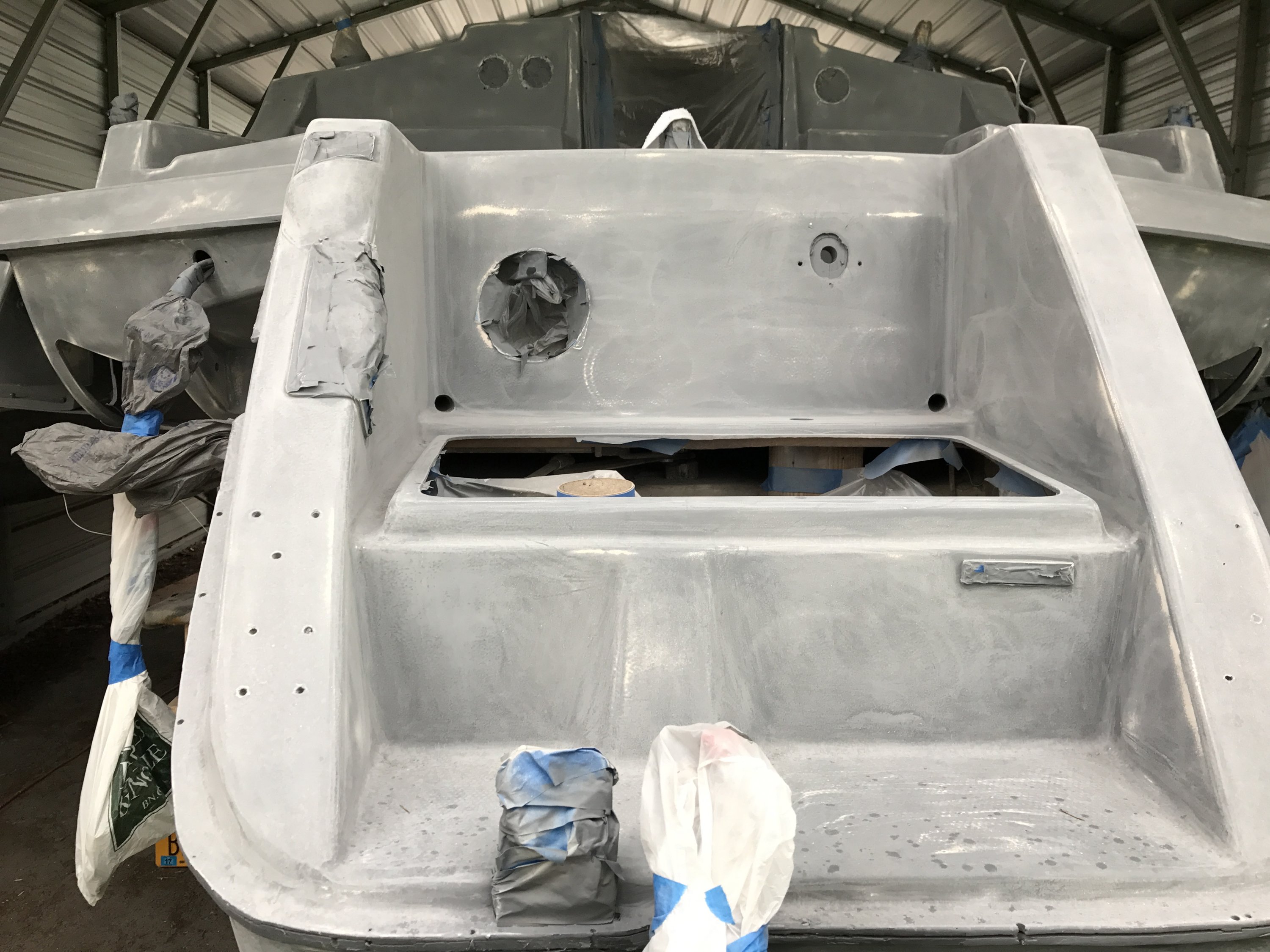

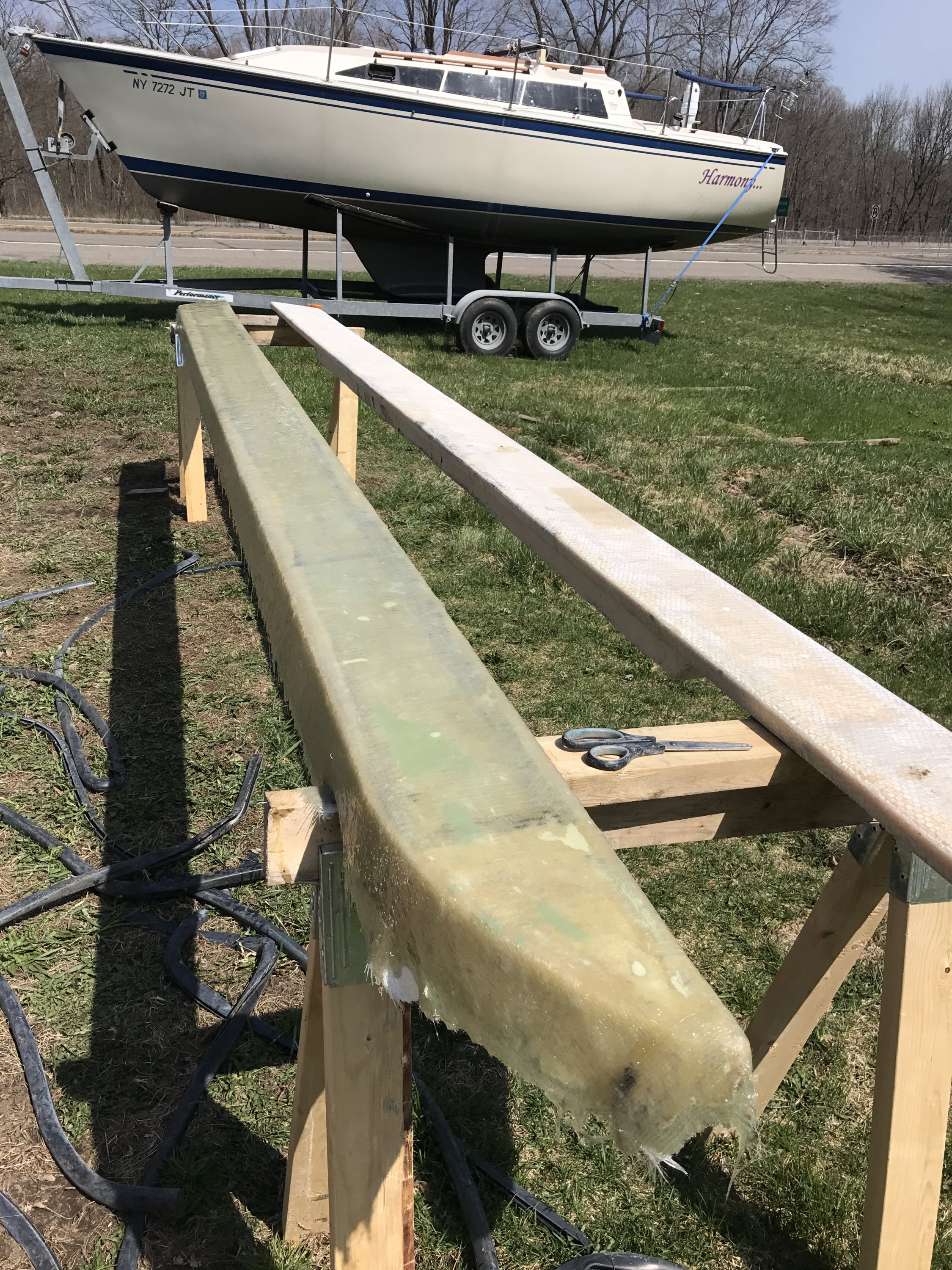

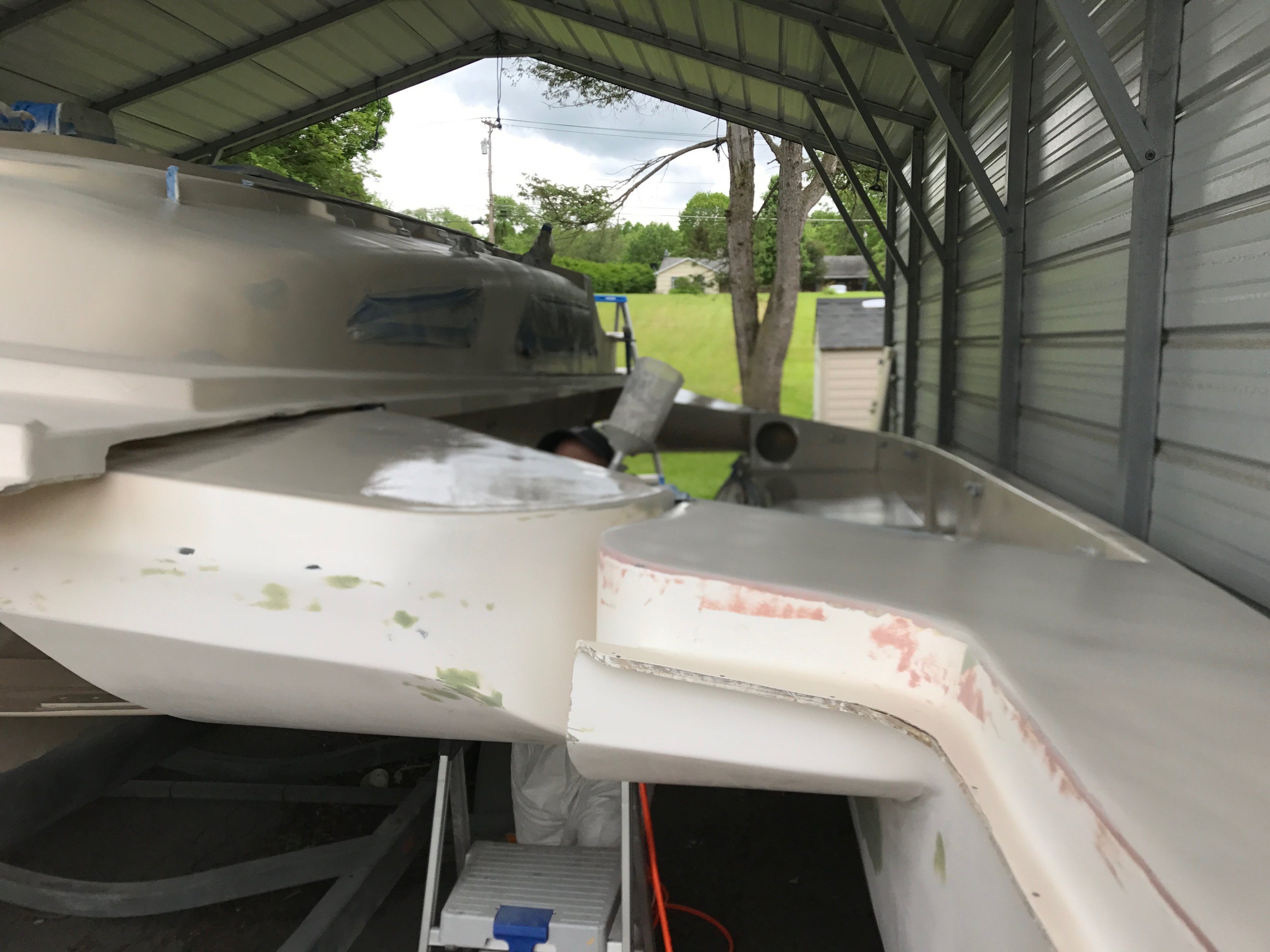

We reinforced the "wings," the salon-top decks, the fore and aft outrigger decks, the underside hull-deck joint on the outriggers, and the hatches with fiberglass. The decks and joints were reinforced with biaxial mat. The hatches were reinforced with several layers of lighter cloth.

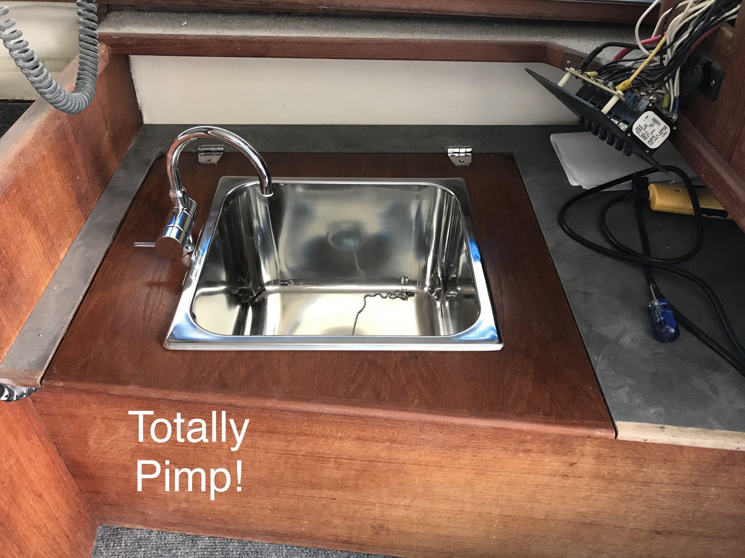

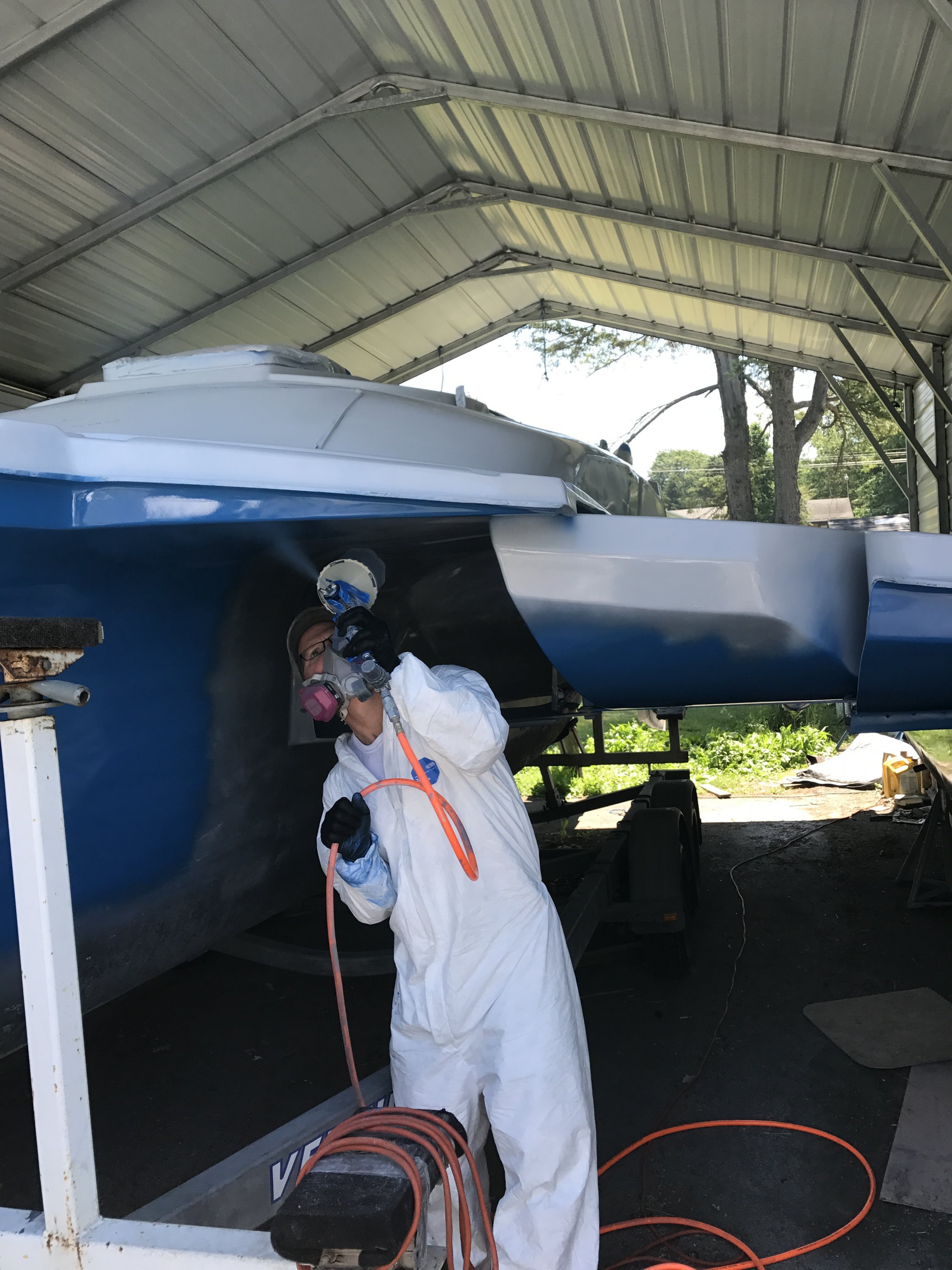

We rebuilt the hull-deck joint on the port outrigger. We moved the sink to the opposite side of the boat. We moved the batteries forward to a less used area. We removed the marine head in favor of a portapotty. We replaced all the plexi. We used 1/2" plexi for the hatches and 1/4" plexi for the portlights. We filled and faired all the spider cracks in the entire boat. We sprayed awlgrip high-build primer, sealer primer, and topcoat. We plan to wet sand it next year and spray more coats of topcoat and clearcoat.

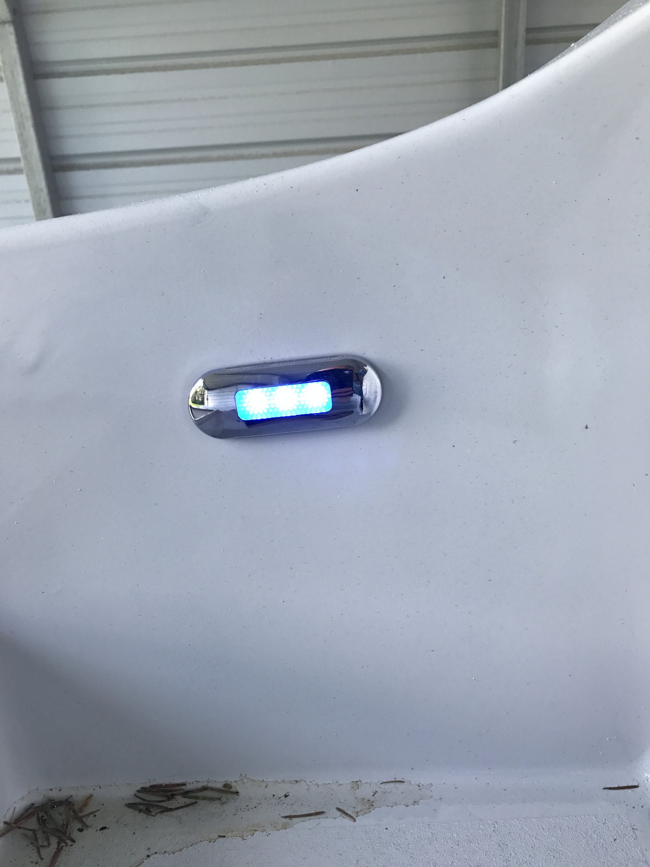

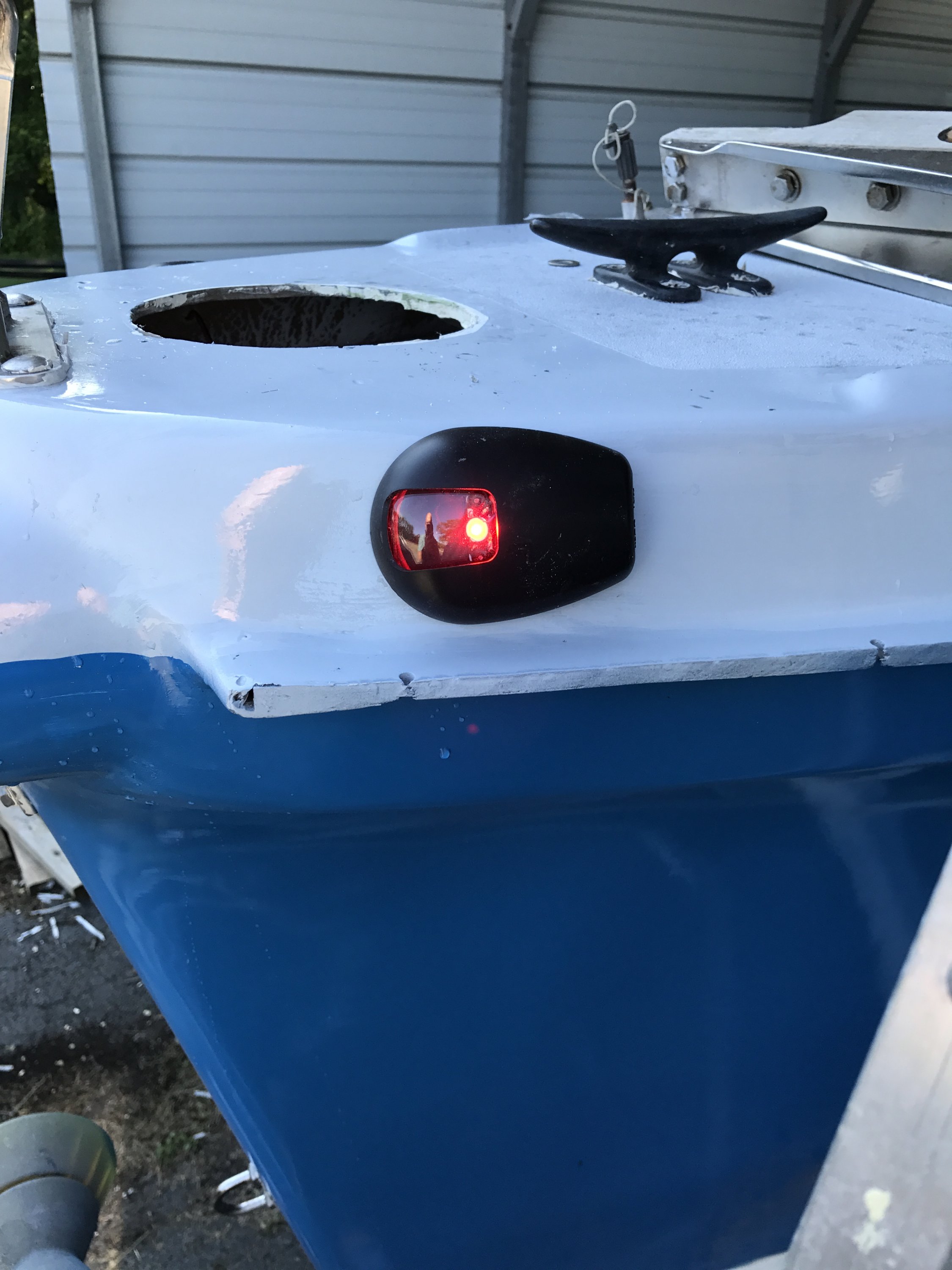

We installed:
Stereo with interior and cockpit speakers
Courtesy LED lights in the cockpit
A sub switch panel to separately switch accessory lighting
A water pump
Water bladder
Water deck fill
LED nav lights
Charger / inverter
4 ipod chargers
New hull liner
New cushions
New sink
New portable waste water tank
New CDI furler
New forestay
