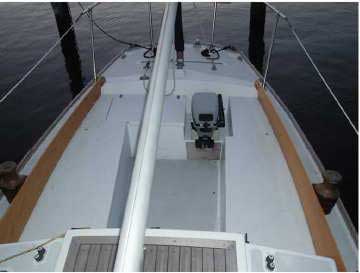

I'm still baffled by the hole in the bottom ... how could it be used for an outboard mount when the opening is below the waterline? Besides, why would there be a mount for an outboard when the boat has an inboard engine?
10,079
Pretty sure that the hole is an outboard well. The hole has a box glassed in the top all the way up to the cover on the cockpit seat.. The water can rise to level in the box but not get into the boat unless it gets as high as the cockpit seat.... There usually was a plug provided to make a flush fit with the outside of the hull once the outboard was lifted out and secured. Wouldn't a British Seagull look fine sitting in there! The outboard well probably was original before someone added the old diesel. The position of the throttle on the floor and the shift coming out of the engine box look very home done to me, as do the cuts in the floorboards. In some places, you can still see the ledge where the removable bilge board sat. Note that any rainwater and seawater in the cockpit will end up in the bilge since there is not a seal or a levee to keep it out of the engine bay. Again, looks home done..
Attached is a shot from a South Coast 23 cockpit which shows the outboard well. This boat is from the same timeframe..
