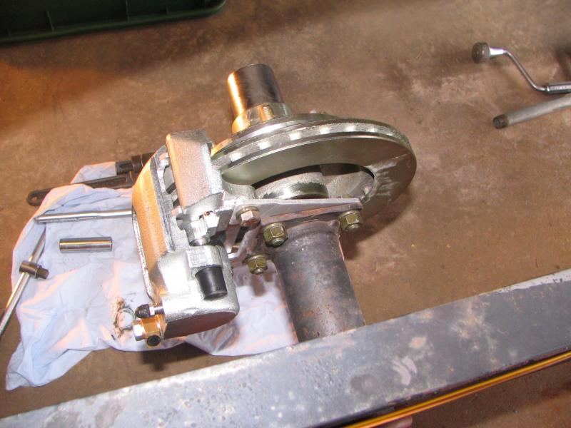

I bought the surge disc kit with everything needed, if the axle has the bracket on it, here....
http://www.blackbearsportinggoods.com/ProductDetails.asp?ProductCode=ELLTIED82101&click=12
The kit is $418 now, but was $380 a couple weeks ago and seems to go up and down with them. Also it looks like they are out-of-stock now,

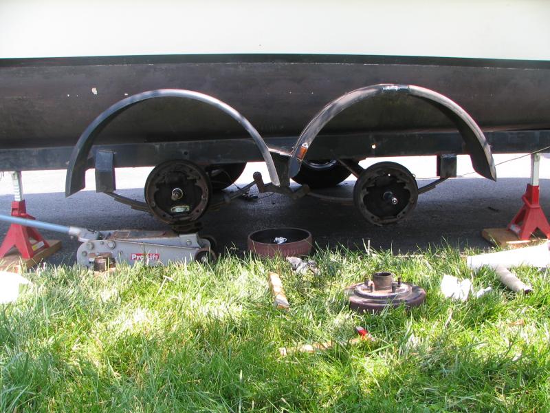

I'm with Sumner on this one. I put disc brakes on the rear axle of my 26X OEM steel trailer (PO moved original axle and added a second one). I may add discs to the front axle this spring, as I'm planning on taking it to the Carolinas this fall, and pulling with a Toyota Highlander, while fine for power, might benefit from the extra braking.
I used a kit from etrailer, with a new coupler (exactly like the OEM coupler, only not rusted, and with a disc brake master cylinder, which has smaller bore for higher pressure), rotors, bearings, seals, and brake lines. Oh, and it came with a reverse lockout solenoid valve, which I connect to the running lights when I need to back up (disconnected normally).
It was under $400 for a single axle kit, and about $600 for tandem axle. Cheaper to buy for both axles at that time, but what can I say?
Having brakes on both axles will result in less trailer force to the ball, resulting in less braking force required of the tow vehicle brakes, but that may not matter much with a robust vehicle. My vehicle could probably benefit from having the extra brakes on the trailer, at least during panic stops. While I'm plenty careful on the road, it's the unexpected you have to expect, so I'll probably spend the bucks and do the work.
Oh, and I'll never bother with drums again if I can at all help it. :dance:

I put a kit of surge-drum brakes on mine. It was $351 for the kit. If I had it to do again, I'd pay the extra $50 and put the disks on instead. Maintenance is a big thing. Also you can wash disks easier and actually inspect them as needed. Disks are the way to go.

The kit I got came with all....
...flexible lines and I was able to make them reach the rear axle. So far one year into having the lines and brakes everything is fine. Down the road I'm not sure if I'll replace the flexible lines with rigid. I was surprised that the flexible lines can handle the pressure over the distances require, but they seem to work fine. At least they are one less thing to corrode, but maybe subject to rot like tires. Guess nothing lasts forever :cry:,
I have a suspicion that in a real world test with the same trailer that moving the brakes from one axle to the other wouldn't amount to much difference in stopping distance. One thing I do know that the difference between stopping distance between having any type of working brakes on the trailer and none at all is probably very measurable :),
