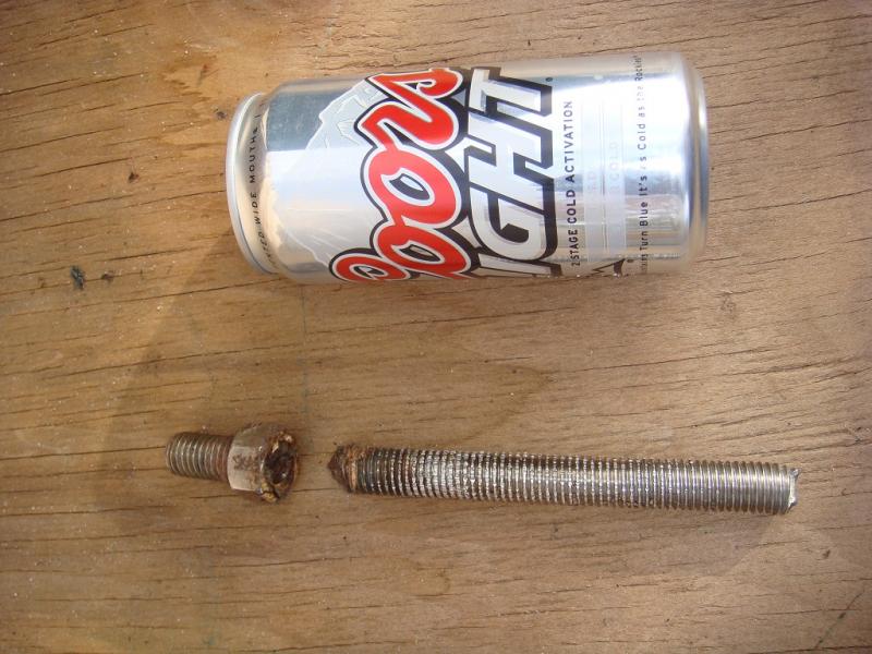

We just dropped the keel. The bolts were long enough to have an almost 2 inch gap between keel and boat. My boat is a 1980, and it seems to be the polyester putty. One of the bolts broke off. The one in the front. It was badly corroded. My question is if these bolts were in the keel when it was poored, or if these bolts are lag bolts. We need to remove the one that broke, and replace it. If we can't remove it, we will have to drill a new lag bolt.
Thank you so much for your input!!!

We used a pipe wrensh, just to see if we could unscrew the bolt from the keel. It worked!! We were able to unscrew the bolt using a pipe wrensh in the gap between boat and keel. It took a while, since there is about 5" of bolt inside the keel. It turned up inside the cabin floor.
Checking the other bolts, we found the rear bolt close to failing as well. We removed it the same way. BTW - the first bolt that failed was the front bolt.
The bolt in the rear was much longer. It is 14" all in all, and about 11" is in the keel.

I would love to see photos of the corroded keel bolts!!!

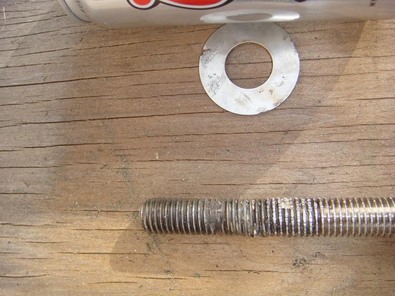

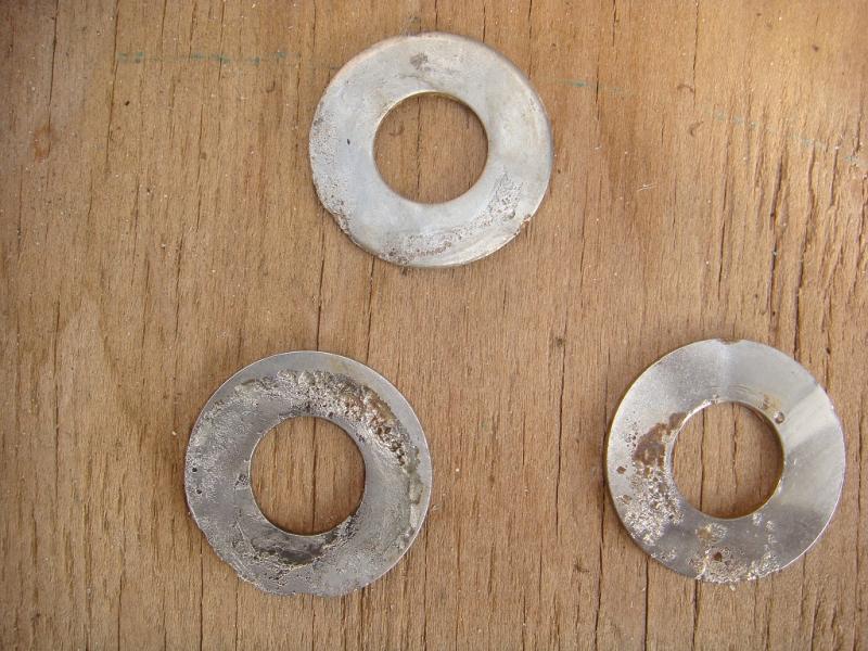

I finally have some pics to share with you. Please pay close attention to the size comparison tool!!!
I think the electrolosys happened because the SS bolts, and the SS washers are different grade of stainless.

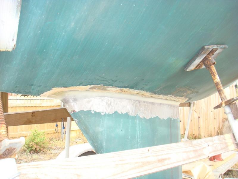

It looks like the polyester "mish mash" has cracked quite a bit, it also looks like you may have a new style keel with an old style keel recess. The old recess was smaller in all dimensions than the top of the new keel, it appears "mish mash" was used to fill in the difference. I would recommend at the very least to remove loose or cracked polyester filler down to the laminate.

Oh - one more question - would it make sense to fabricate aluminum backing plates for the bilge to distribute the weight of the keel better. The laminate is not very thick, and the washers seem not adequate. It would be just a few hours work....

I'd rather see stainless backing plates bridging two bolts, the corrosion you showed in the photo is crevice corrosion, it occurs due to lack of oxygen, the washers should be thicker than those shown in the photo. Your plan for raising the keel is pretty much how it was done at the factory. Sighting the keel along the stem to be sure its not cocked to one side as the bolts are tightened. We at Seidelmann wrapped the bolts with butyl tape if memory serves, Hunter puts a large bead of 5200 around each bolt and butters the rest of the top of the keel with a mixture of West Epoxy/microfiber/cabosil.
There are standard torque specifications for given size course thread bolts and I would let the epoxy cure before final tightening.

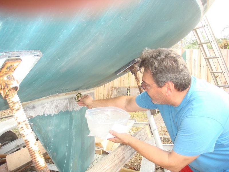

Betterlate than never. Here are some pictures of the keel back up. They show the seem on both sides of the keel. The brown paperback in front was used to pack "mish mash" in the fromt cavity where the depth sounder was. It was not working so we removed it. The two pictures of the inside show the backing plates we installed.
Next order of business is to grind everything down, about two inches above, and four inches below the seem. Then fairing in the seem, and applying a few layers of glass.
If there is any interest, I'll kepp you updated, and post pictures. Let me know...
:) Ernst

After pulling up the keel, and making sure it is straight, the "mish mash" hardened. It took a bit since we used a tropical hardener to gain some time due to the amount we mixed up. We had a couple of cold nights, so it took a while. Saturday morning I ground off the bottom paint from the boat above the keel, and on the keel. Next thing was to fair in the keel with another batch of epoxy paste. This time without glass strands. Using a cap of a salsa glass, we layed in a nice smooth beed. Next step is to do some sanding, and lay 3 layers of glass. We cut 6", 4" and 2" strips of glass to connect the boat to the keel. That should be it, except for primer, and bottom paint. Here are some pics...
:) Ernst
