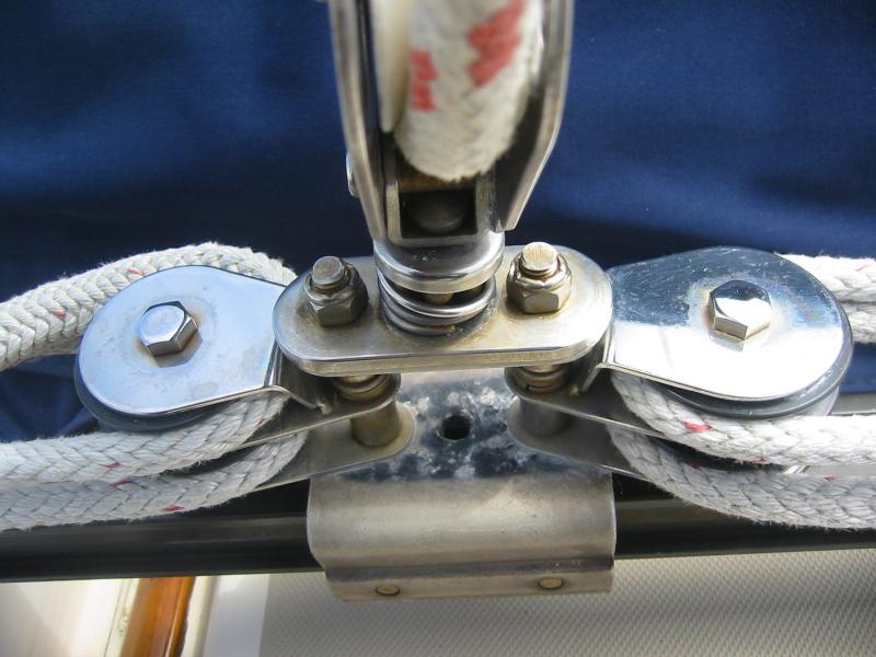

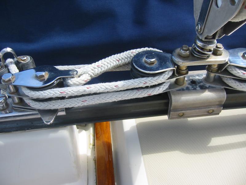

I don't know how the traveler on my 1985 31 compares to the 1977 25 but I was able to add these blocks to my existing traveler car. Got them and the ends from Garhauer

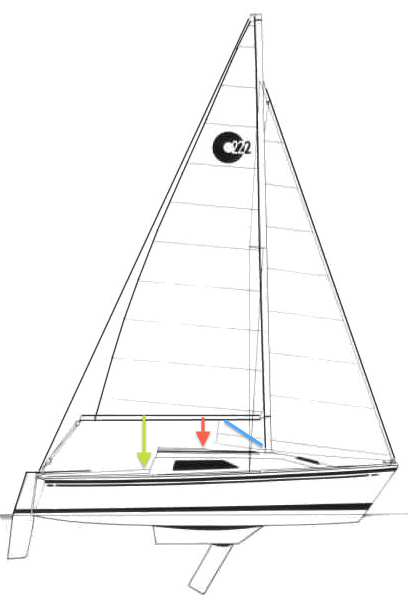

222 Traveller position considerations.
I've made some annotations to the sailboatdata.com line drawing of the 222. The blue line is an approximation of the vang. The red arrow shows a cabin top traveller point, which to me looks too close to the mast along the boom. And the green arrow shows how a traveller across the bridge deck is pretty ideal looking. Of course, the problem with such a traveller is that now you give up cockpit seating amenities. You'd no longer be able to sit with your back leaning against the house and your feet down the seat. And you couldn't lay on the seats full length. And, of course, a ding against bridge deck travellers is that there's another obstacle to getting in and out of the cabin while under sail, unless you raise the traveller or drop it down past the edge of the companionway. I have heard folks who have a bridge deck traveller say that it isn't as big a problem as you think it is....
So, part of the purpose of a traveller is being able to control leech tension, and thusly sail twist, while at the same time being able to adjust angle of attach while still maintaining (mostly) the same leech tension/twist. (I say mostly, because you'd need a curved traveller track to match the arc of the boom to exactly maintain leech tension, but I digress...) If you had the boom attachment point out of line with the traveller, say, aft of the traveller position, now you've got the main sheet pulling the boom down at an angle. This would make it less efficient at doing that, and introduce a vector of force pushing the boom forward. Ahhh, but for small deviations of position, and smaller angles from 90º, this forward vector is probably negligible and ignorable...
Brian

Re: 222 Traveller position considerations.
Brian -- Thanks for the additional analysis. I appreciate your help. However, I'm still really hoping to find an alternative to mounting the traveler in the cockpit -- for the reasons you mentioned.
I'd like to toss another idea at you for thought. But first, I took your drawing and went on the boat and made some measurements to the points you identified. The measurements are from the aft edge of the mast and relate to distances along the boom to the positions you identified, and a couple of additional points.
Mast to boom vang attach point = 18"
Mast to aft end of open cabin hatch cover = 38"
Mast to top edge of cabin bulkhead = 70"
Mast to aft edge of cockpit step (mounting position of Joe's traveler) = 88"
The total length of the boom is 128" and the foot of the sail is 114" (this was a "quick" measurement does not match SailData)
Ok, here's a question, and then my idea. What do you think is the minimum distance from the mast to traveler - 1/3 or 1/2 the length of the boom? Or, can placement be measured by the foot of the sail?
Here's my idea. I don't have a problem with the traveler partially blocking the cabin top while sailing, however having to duck under the traveler when not sailing won't work. My thought is, since I have to build "towers" for the traveler to clear the sliding hatch cover, why not mount the towers on tracks that will allow sliding the traveler forward when I want clear access to the cabin. The traveler I have is slightly arched and only attaches with a single through at each end. I think that a track, of the same width as the traveler's track should be structurally sound.
What are your thoughts.
Thanks, again,
Dale
