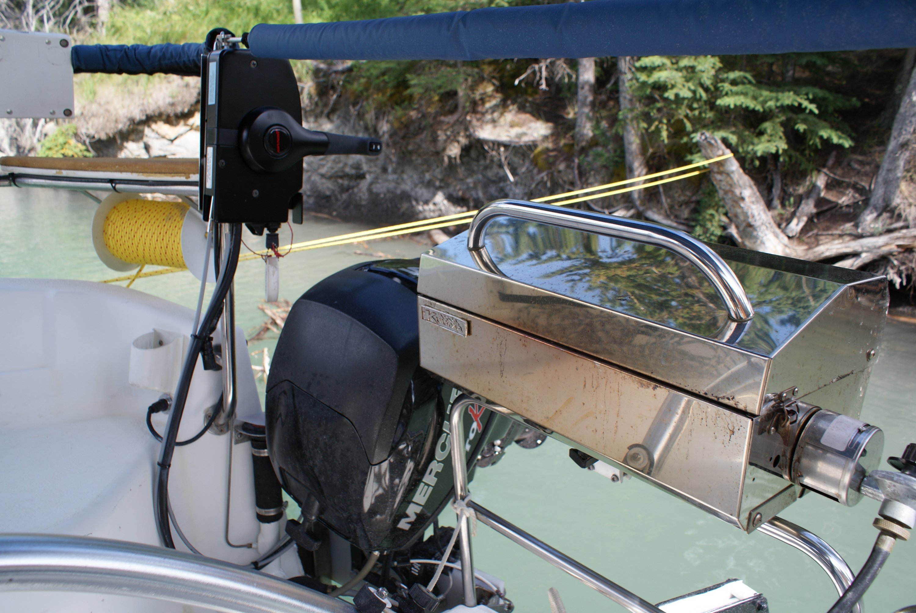

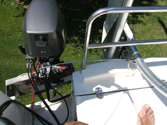

The power tilt and electric start take a lot of work out of boat handling on the dock and at anchor. I have never needed the outboard to steer with the tiller to get into tight or complicated places so I have no experience. Here is a photo of my set-up. I also have a tiller extension so sitting on the rail seat and driving works well. G

Dewhunter ... That's a mounting location for the remote that I haven't seen before. Thanks
What is the cable and plug for at the aft end of your cockpit seat?

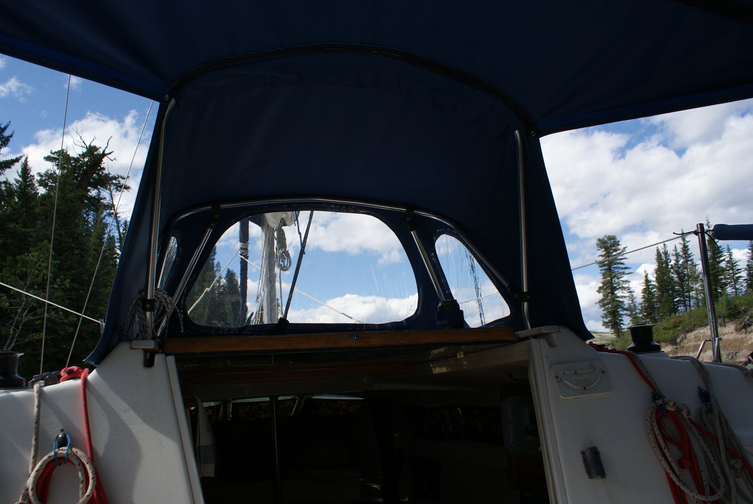

The plug is for cockpit lighting. I made an 16 inch long led light and mounted it to the bimini support hoop to provide light after sundown. I don't have a photo of it, but here's a look forward from under the bimini.

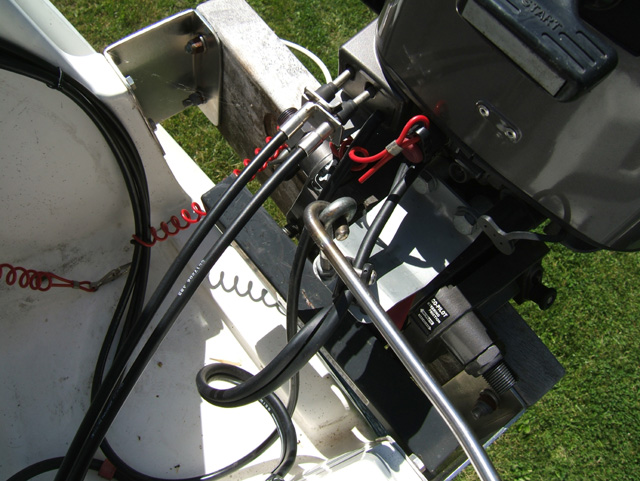

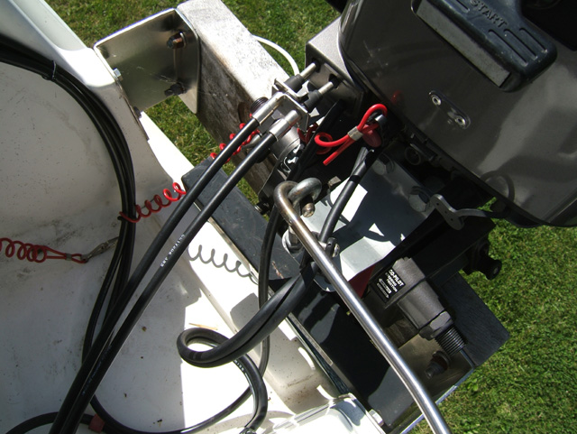

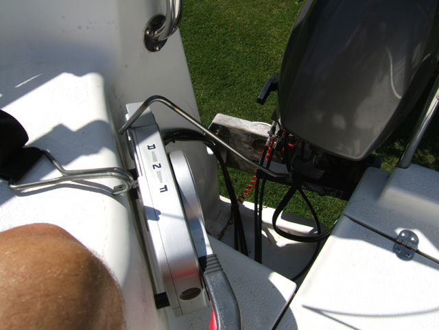

Lucky for me, my motor was stolen before I even got to use it, so I got this Nissan remote unit and connected it to the tiller.

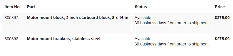

John,
Where did you get those metal brackets that are used to bolt the motor mount board? Did they come with the boat. I need to find a couple of those. My boat has what looks like pieces of cutting board material stacked up, used as spacers.

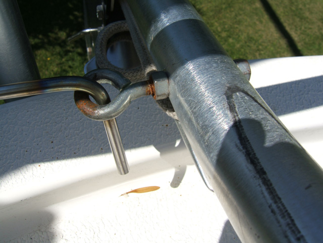

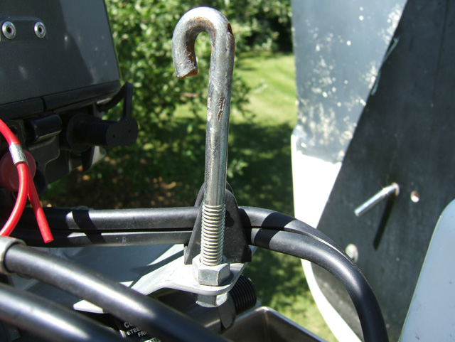

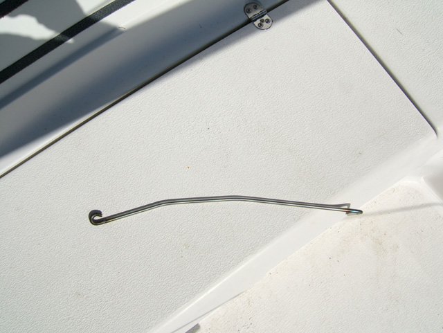

Thanks for the pics John. I've never seen the linkage mounted in front of the motor on an H26.

John... your control lever is shown in a horizontal position. Does it move that far from vertical or did you off set the handle by 90 degrees?

John,
They did come with the boat. I also have blueprints of the metal parts I made for a friend if you want them. You should be able to get a local shop to make them a lot cheaper than that.

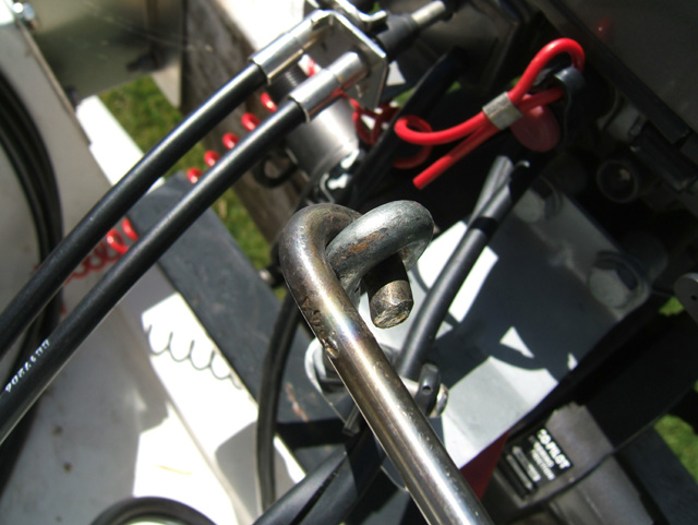

The Nissan/Tohatsu outboard has a bracket on the front to mount the modified eye-bolt to. The slightly opened eyebolt and matching end on the rod slip together and twist around and are as easily removed for trailering or to get out of the way.
Yes, it moves to horizontal in full forward. While sailing, that allows it to be out of the way while sitting on the cockpit seat. All in all it seems to be the best location for the remote. This allows me to operate it with my foot or knee while keeping my hand on the tiller in those times when we have to stand and keep a look-out. As stated, I never had to reach down into the motor well to hit reverse or slow down in a hurry at a slip. I wouldn't want to have to do that.
