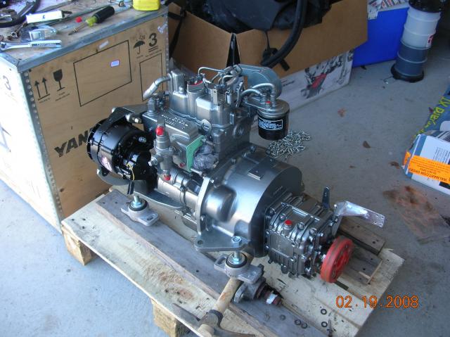

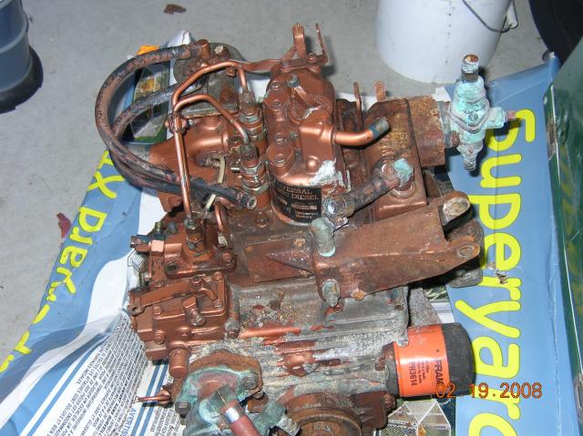

I repowered my 83 oday. It came with the 8411 universal diesel. I found a place back east that sent me the whole shootin match rebuilt with trans for 2500 bucks. I used the marina crane to pull the old one and put the new one back in the spring. It was a great project and I learned alot about my boat. I could have upgraded to the yanmar and gone through the whole reglassing the stringers and all that, but I am more interested in sailing than engineering. It lasted for 20 years, and if i take care of it I think this one will last beyond that. Good luck whatever you decide to do, but I would rebuild what ya got and then take care of it.

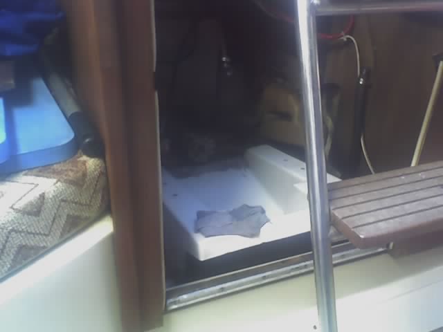

Also, some of you mentioned that it might save on labor to stick with a saildrive vs shaft. The problem with that is the OMC sits right on top of the drive whereas the diesels sit in front of it. So the current hole (maybe 12" by 5") would have to be filled and another one cut a couple feet aft. With the extra labor and the cost of the drive unit, it may be cheaper to go shaft.
