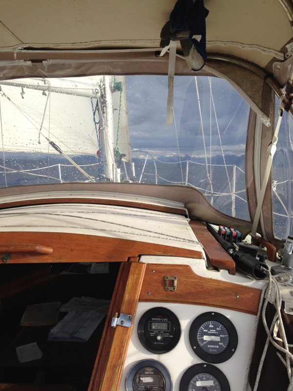

Catalina 30 Sitka
That sure looks a whole lot like my 1976 Catalina 30 #376. I've spent the last couple years battling a old universal m4-30 inboard - spent my vacations at the boat fighting the engine instead of out on the water. Threw in the towel this year and mounted a 25hp suzuki outboard on the back until I can afford a real repower. Just finished a 4 day, 100 mile trip in South East Alaska and the outboard did great! Reliable, economical and far less issue with porpoising than I expected, even in some 12' seas.
I absolutely love this boat. Looks like a very similar year and model in the photos- assuming the basics are solid, I'd go for it!
