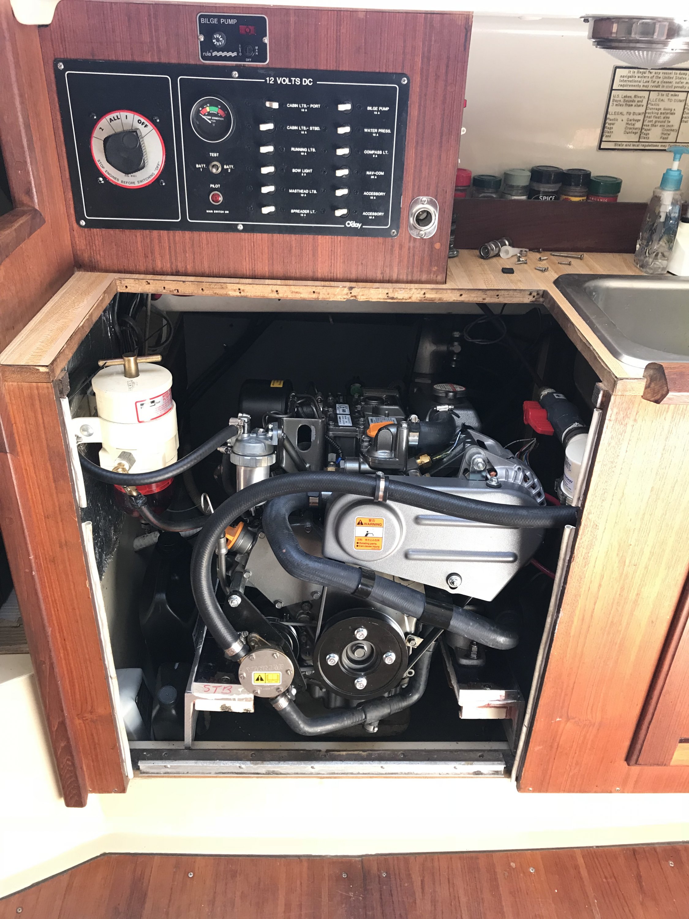

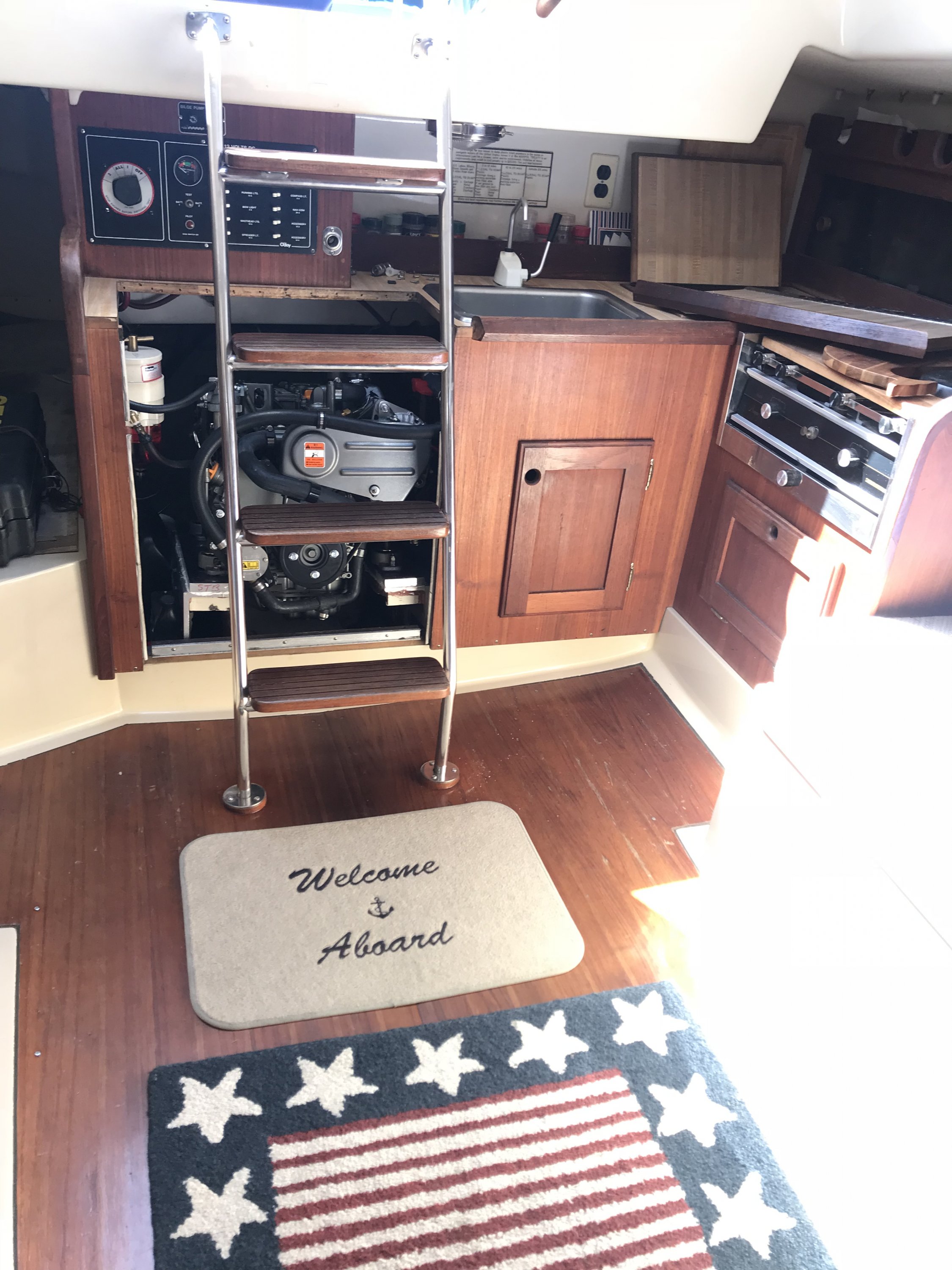

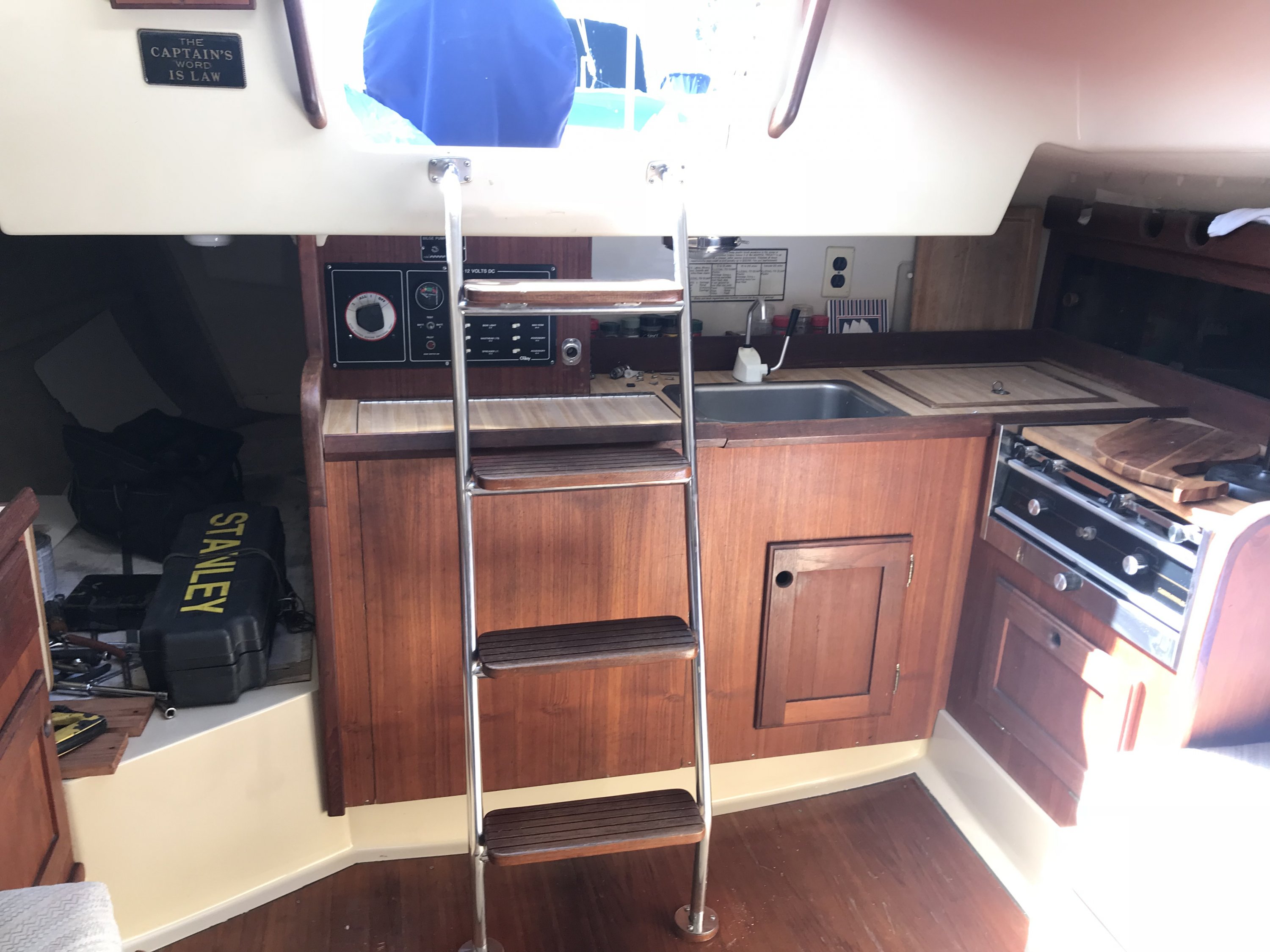

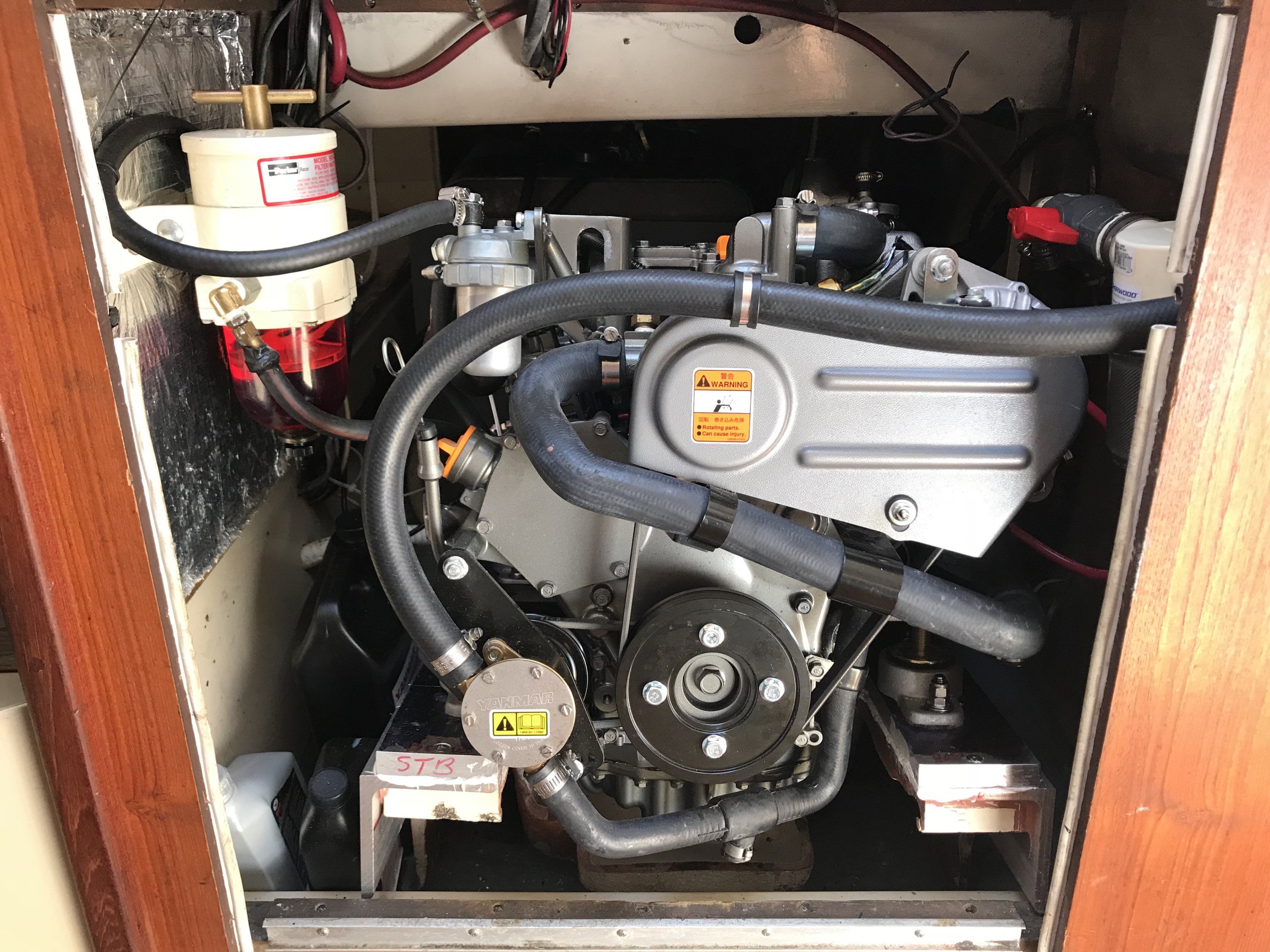

I’m thrilled to say that that my new Yanmar
3YM20G-2.62 engine is finally installed and music to my ears! My mechanic Leonard Greech of Sea Power installed the engine. He really had to do a lot of work on changing the motor mount, but did an amazing job! The engine does not protrude into the cabin and the cabinets are the same. I’m not sure that it would be the right decision for others, but it was right for me and I am so happy!
I’m loving it! Thank you to all of you that told me about your experiences with repowering! Here r a few pics!
I’m loving it! Thank you to all of you that told me about your experiences with repowering! Here r a few pics!View attachment 149829 View attachment 149830 View attachment 149831

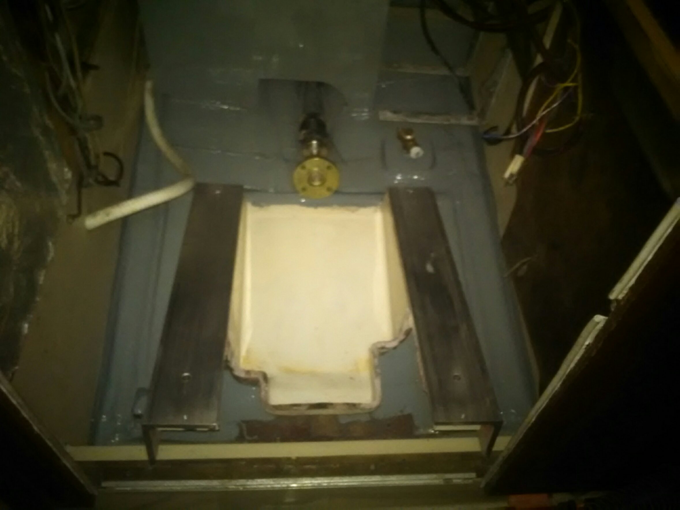

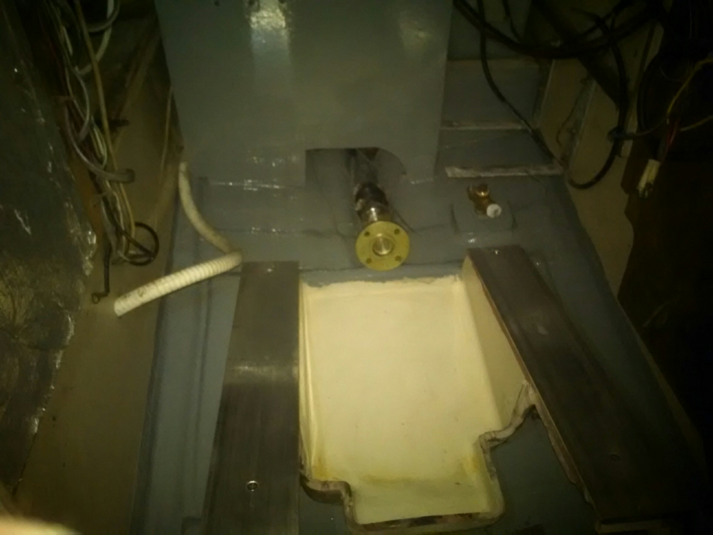

Congratulations O Happy and many years of motoring without problems. Do you have any pics of the engine bed modifications and what were the costs?

Let me see if I have some pics of the engine bed...
You can see in the first picture where he had to cut out the fiberglass quite a bit.
I’m a lady without much knowledge of Diesel engines. My mechanic really tried to educate me throughout the rebuild, and made some really nice changes for my convenance. For instance the fuel filter was on the wall behind the engine and now it is right in the front on the starboard side where I can reach it easily. The sea strainer is on the front port side, also with in easy reach. It is tight thought esp on the port side of the engine.

Nice, I'm a guy and know very little about diesel engines too! About the only pet peeve I have is seeing old wiring that is cut off and seems to serve no purpose. I'd try removing those wires just to make sure you don't have anything still hot from the old install (gray wire upper right, and red and black top left above engine).

One little quibble: current ABYC guidelines call for a flame shield 'bowl' mounted on the bottom of that Racor, because it's mounted beside the engine. And, be sure that all of the wire and hose clamps on the upper engine compartment surfaces are cushioned metal. These advisories are related to newer fire concerns. (We are doing an engine replacement currently and have been getting educated about this stuff.)

Thank you I will ask my mechanic to strip out the old wires, and also fix the possible fire issues that you talked about!
