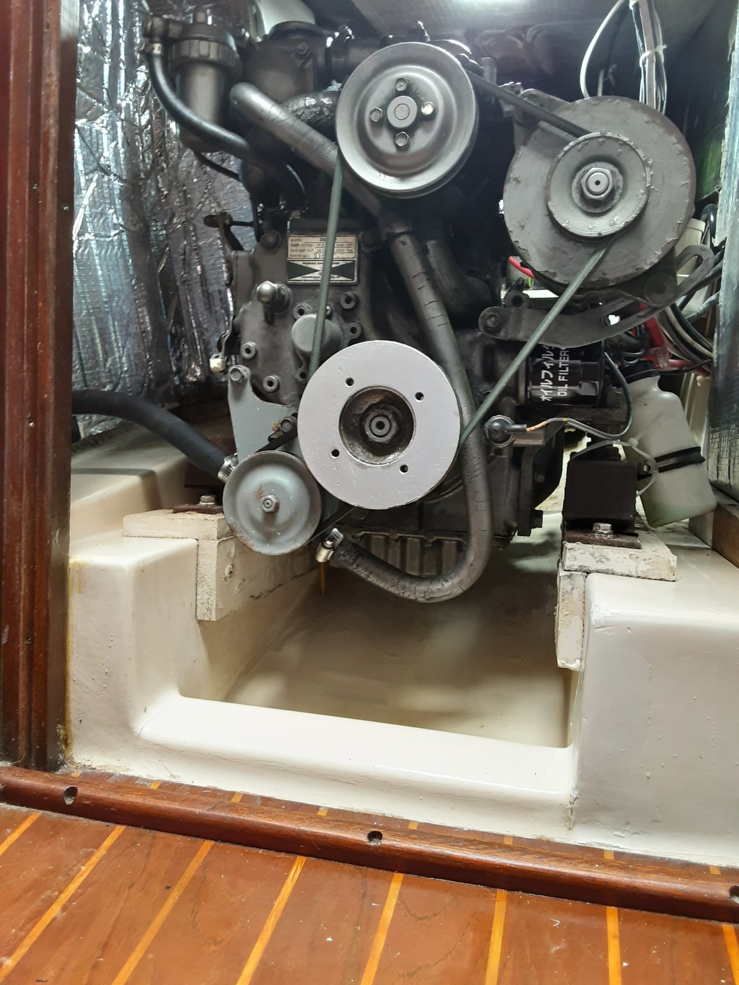

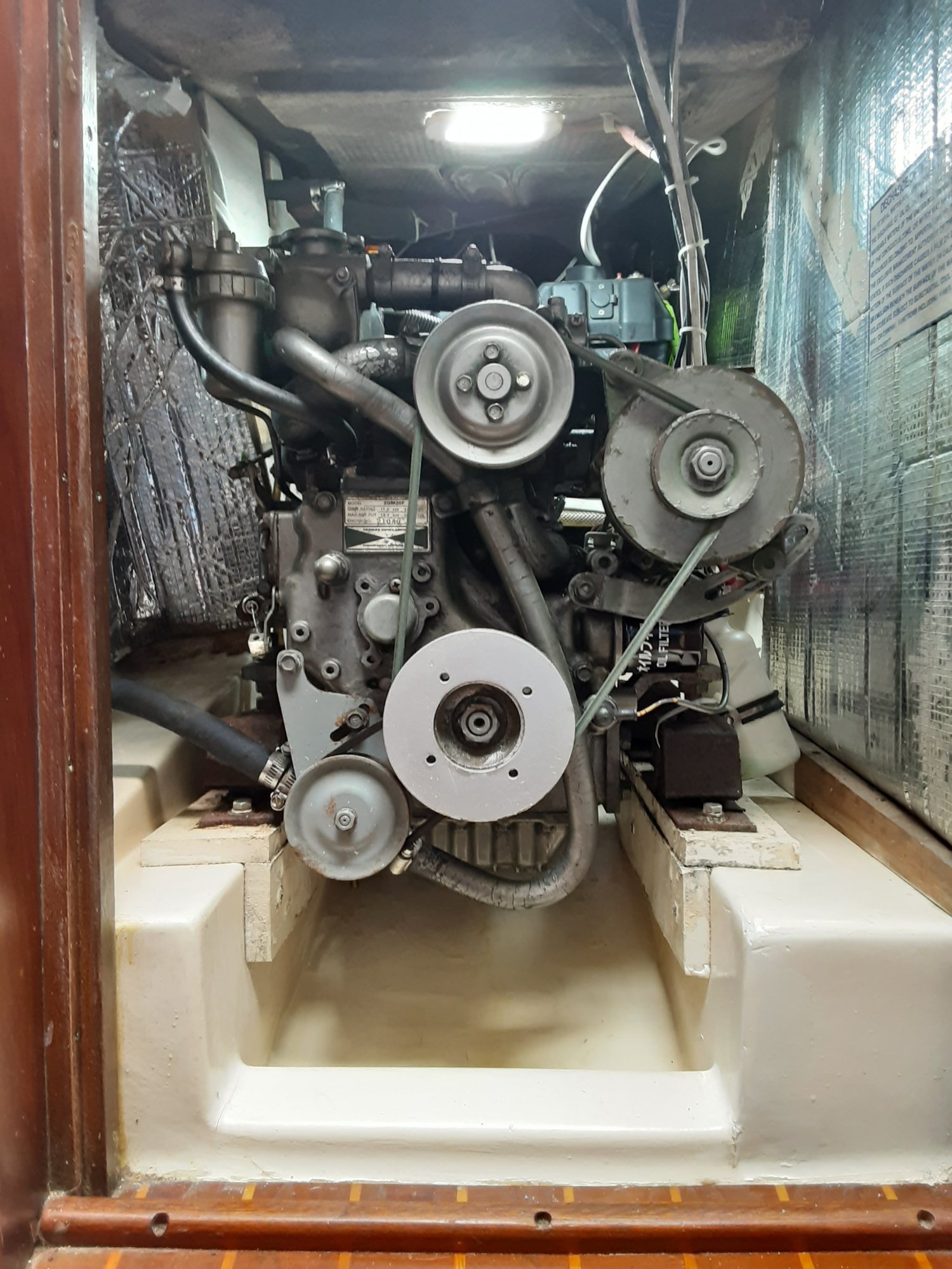

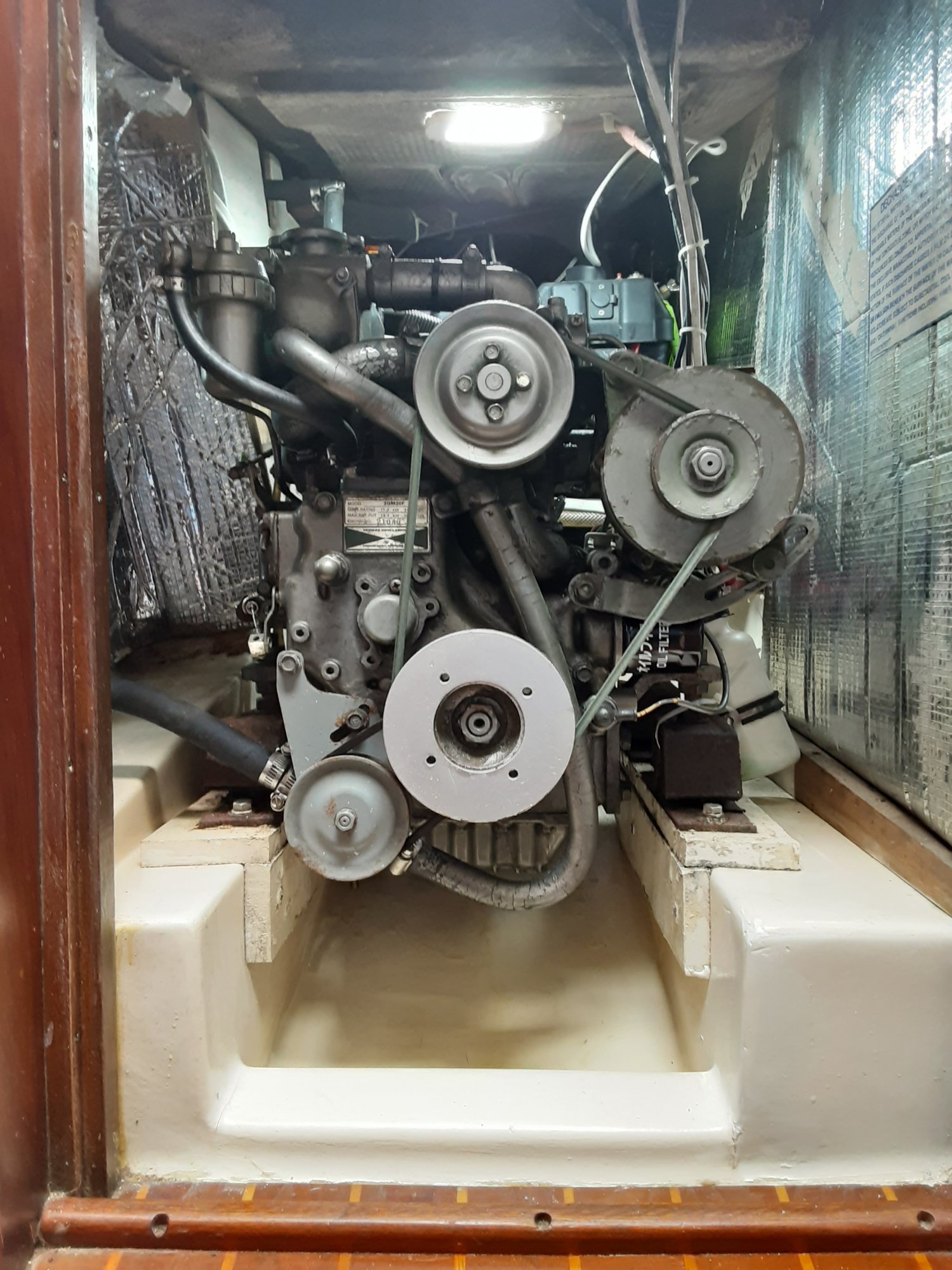

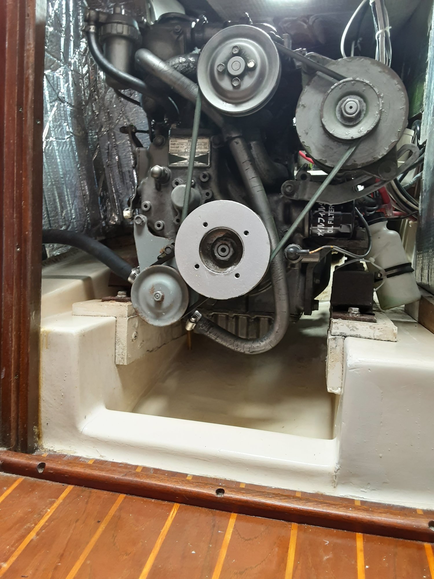

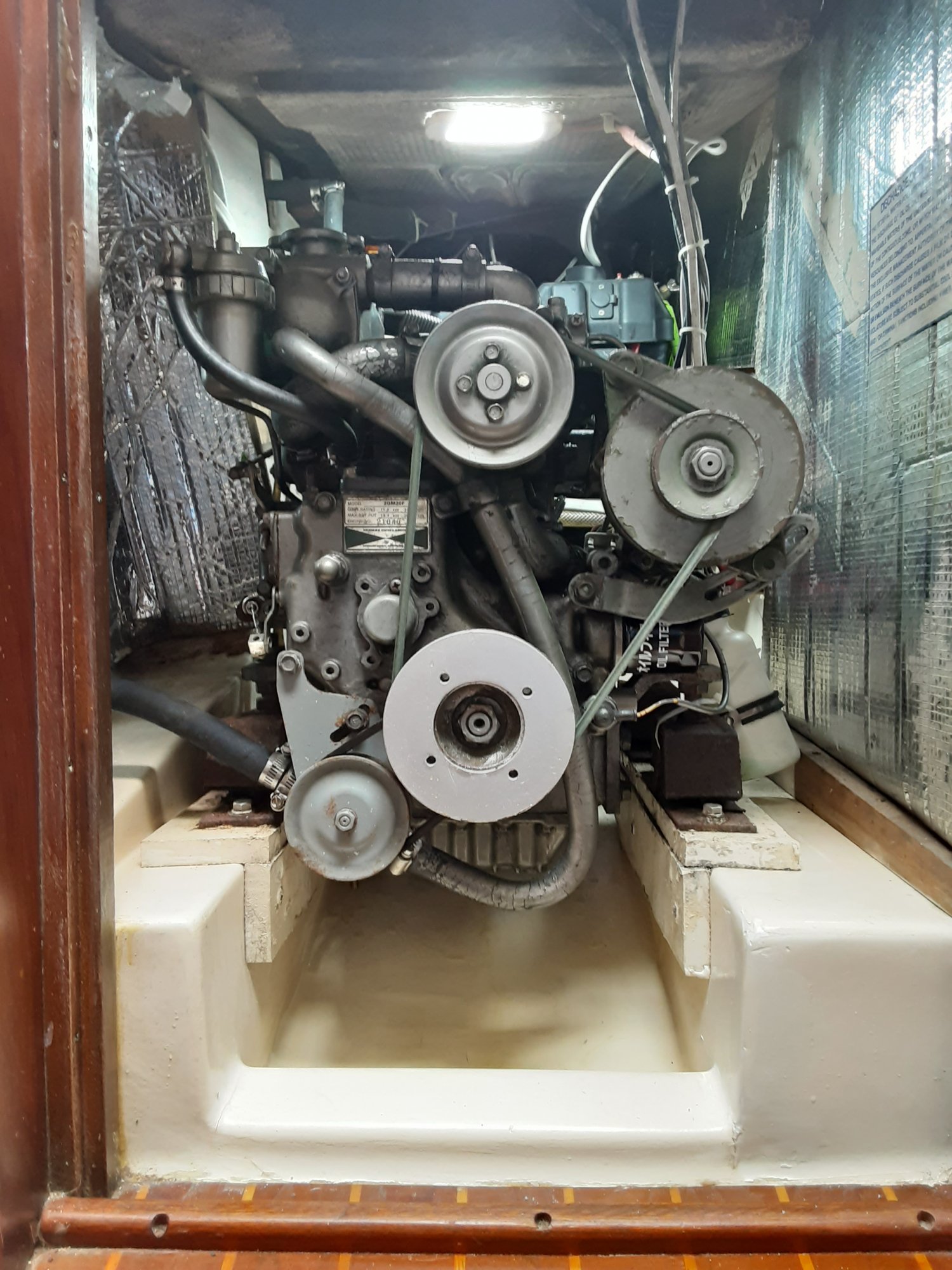

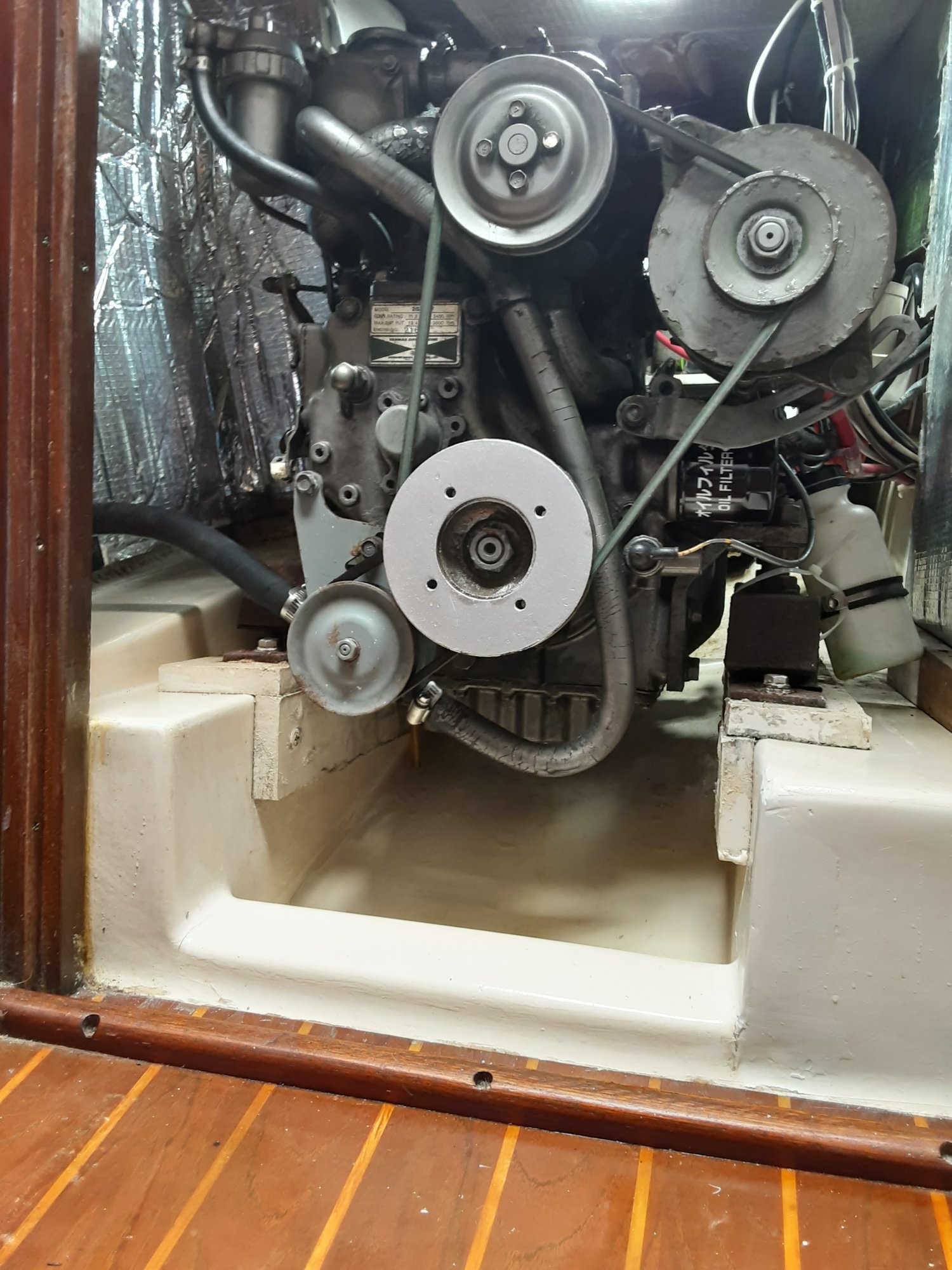

Here are a couple of pics of my 2GM20 install showing the rails I mentioned
May 27, 2004
2,059
No cracking or movement in the past 7 years.
