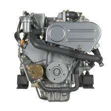

The footprint of the YSM 12 on the H30C is slightly wider than that of the 2GM20 that I repowered with. I don't know the dimensions of the Yanmar 2ym15, but from online pics,
you should be able to do that as well.
MY installer simply put rails in the engine bay to narrow the mount area.
It has worked fine for the past 13 yrs.
The height of your proposed engine will not be a problem.
Save the installer some time and aggravation and you some money:
Remove the bulkhead on the port side of the engine bay and the "step" shelf above the bay.
You'll do a better job, and you'll learn a lot about the construction of your cabinetry.
If your installer says it's not helpful to him to do all that yourself,
ask how he's going to get the old one out and the new one in!

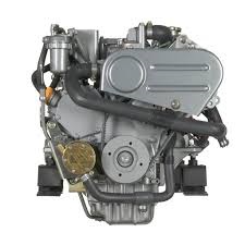

I repowered my H30C with a 2GM20. The footprint and height of the
Yanmar 2ym15 seems to be very similar based on the pics:
But the YSM mounts are wider by a couple of inches.
I installed 'rails' to the inside of the engine bay to handle the difference.
It has worked fine for 13 yrs. The height is not an issue.
Check the clearance of the oil pan with the depth of the bay as well
to ensure shaft alignment room.
I removed the port side bulkhead and the "step platform" (not just the hinged step)
above the bay for installation.
The rest is planning and physics and muscle and more planning.

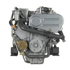

Will definitely look into the rails. Anything that will keep costs down will help. Step and bulkhead you’re outta here!
