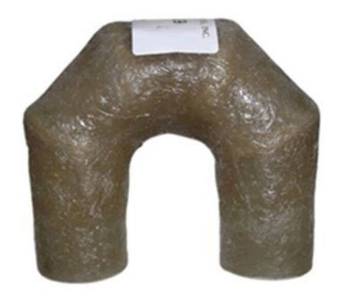

I replaced the 3" exhaust hose on my 2007 41AC last year. I didn't relish the thought of trying to wrestle that hose into a high loop at the through hull so I opted instead to purchase a Centek 180* fiberglass bend. They come in various sizes - the 3" size is #1200199.
I did some homework, and found that the Vetus hose has a very acceptable bend radius. Had a discussion with Vetus, and they confirmed that the hose was fit for my engine. So, I’ve ordered it, and am waiting for delivery.
It was awful pulling out the original hose, and I thought about putting in an adapter. But, the Vetus seems to answer this problem
