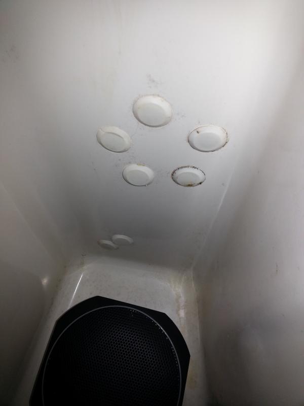

I need to replace the sheet winches on my 23-2. The old winched are through-bolted to the deck, with access to the nuts via small holes in the molded liner, with plastic plugs (see picture). The bolt holes for the new winches will not line up with the old. I was thinking of drilling a large hole in the liner for access, using a hole saw. I could then cover it up with a wood cover or similar. The mounts are down in the the footwells, not out in the open cabin. Any thoughts?
Even w/o a cover hardly anyone will see it, don't you think?

The standard procedure for something like this would be to get an inspection plate at least as big around as the circle of bolts you need to access. Cut out a circular section in the liner as per the plate instructions. (Usually the hole cut is the same as the outside diameter of the plate cover, but check to be sure.) Do whatever work you need to do inside the hull, then install the plate to fill the hole. If you ever need access to that area again, just unscrew the plate cover. Question: are winches a typical problem on the 23-2? I think the 23-2 would be a good boat for us, but I am still looking for one in the Northwest. In the mean time, I am collecting cautionary tales. So far I have heard about shroud tangs and main bulkhead. Anything else I should know about?

Someone please educate me here - why couldn't he from outside drill the mounting holes through the outer hull, and through the inner hull and just use fender washers inside? ( possibly adding a little collar bushing between inner and outer hull, if worried about crushing the two together)

Lance, that would work but I think the bushings would be problematic against the un-even surface of the underside of the deck. Plus the new winches have 6 bolts on a different circle than the original 5, so there would be some inference with the original plugs.
I had not thought of using a standard inspection plate, I will measure & see how that lines up.
