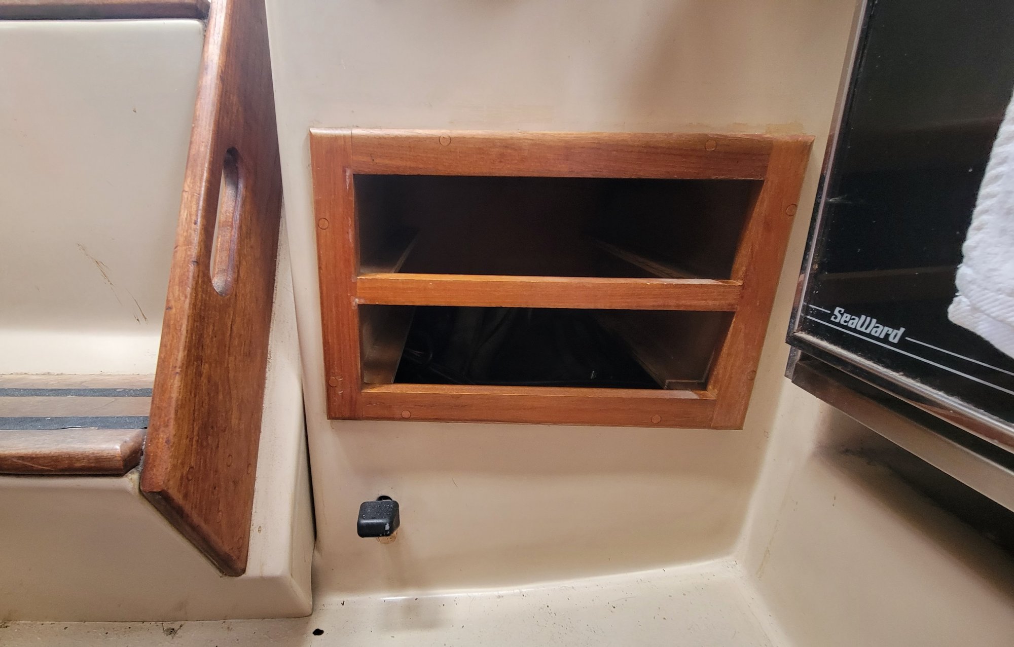

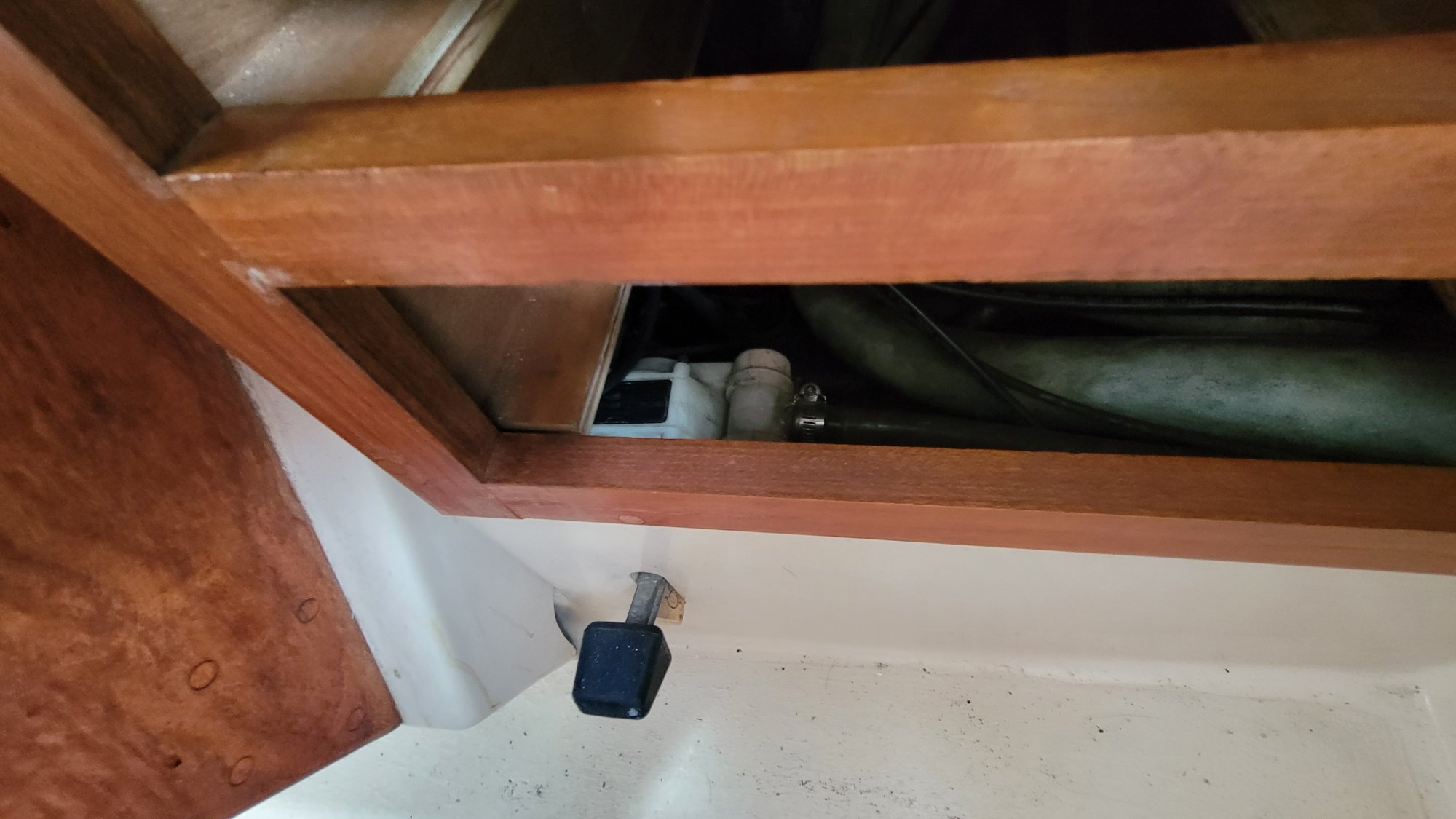

No screws in the back. Here are the photos. The oven is to the right, the companionway steps are to the left. There is no access from the back because of a gazillion hoses and the drawer box back. I am hoping that the whale pump is smaller than the size of the individual drawer opening. But, if we have to remove the middle piece, we will. I can't figure out anything else. It's a pain in the butt to get your arm in there to use a screw driver to loosen the pump.

Have you tried accessing by removing the stairs? I assume it's removable for engine access
I have removed the stairs many times to work on the engine and I did hope to find an access, but alas, no. The fiberglass wall turns a corner there and blocks access to the pump.

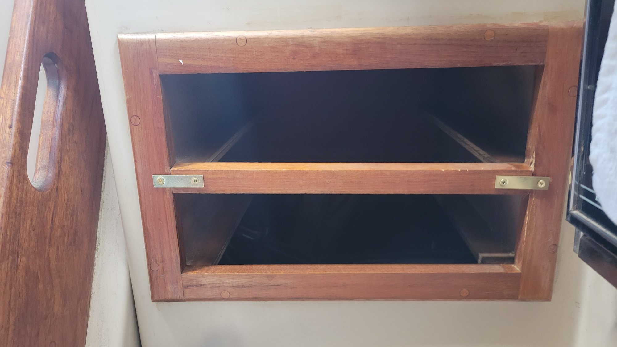

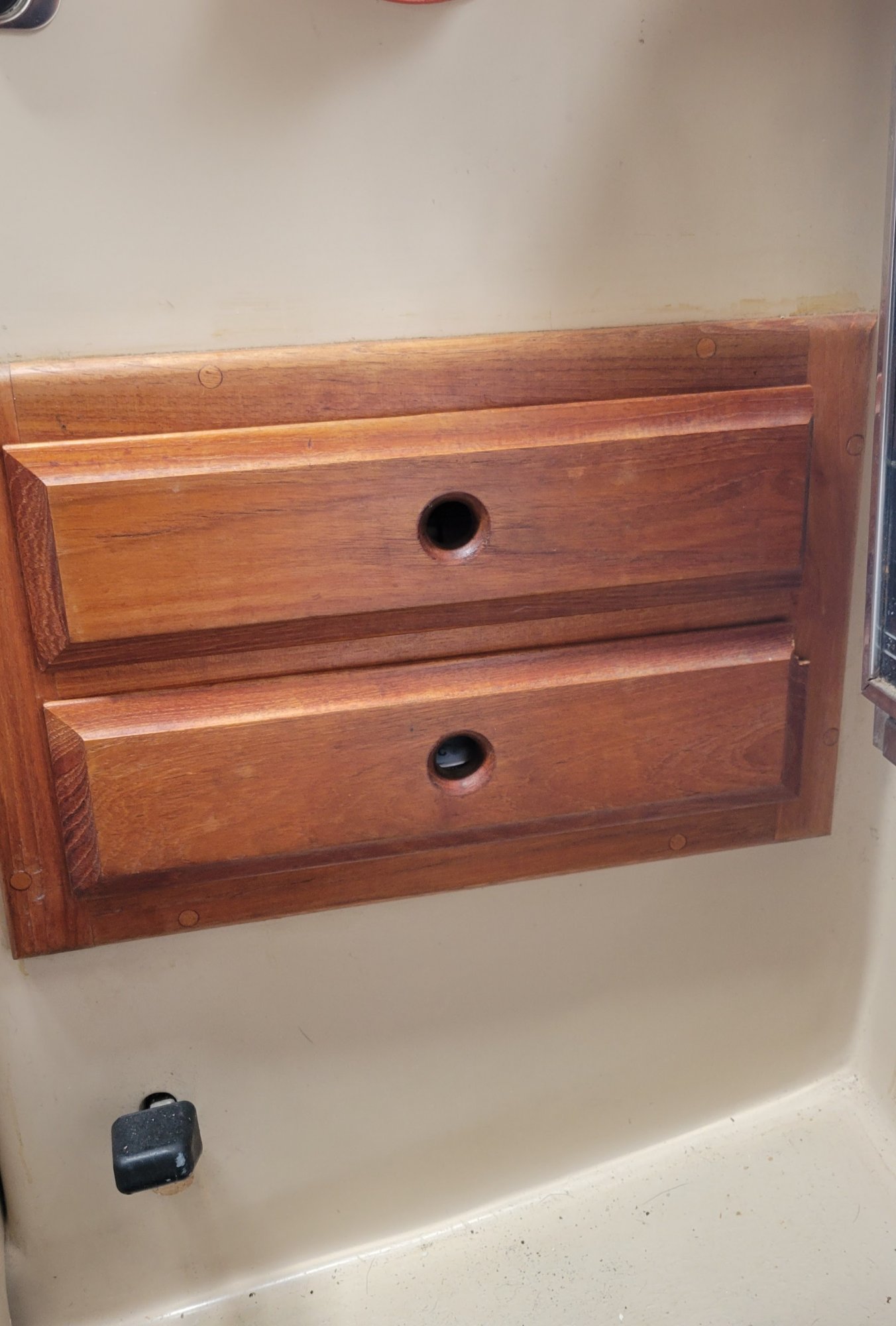

Well, turns out we couldn't drill out the plugs without removing the oven, so we chose the option of cutting the center piece and then replacing it with brass braces and screws to make that area more accessible in the future. (The sink is above the drawers.) The right hand brace has been straightened since the photo. The winds were near gale force when we did this and the boat was rocking enough to make us dizzy! The braces don't interfere with the drawers and it doesn't look quite as classy as all wood, but not bad. And the pump works perfectly. Thanks to everyone for your advice. (I thought I also took a photo of the drawers in place, but guess I didn't. )
