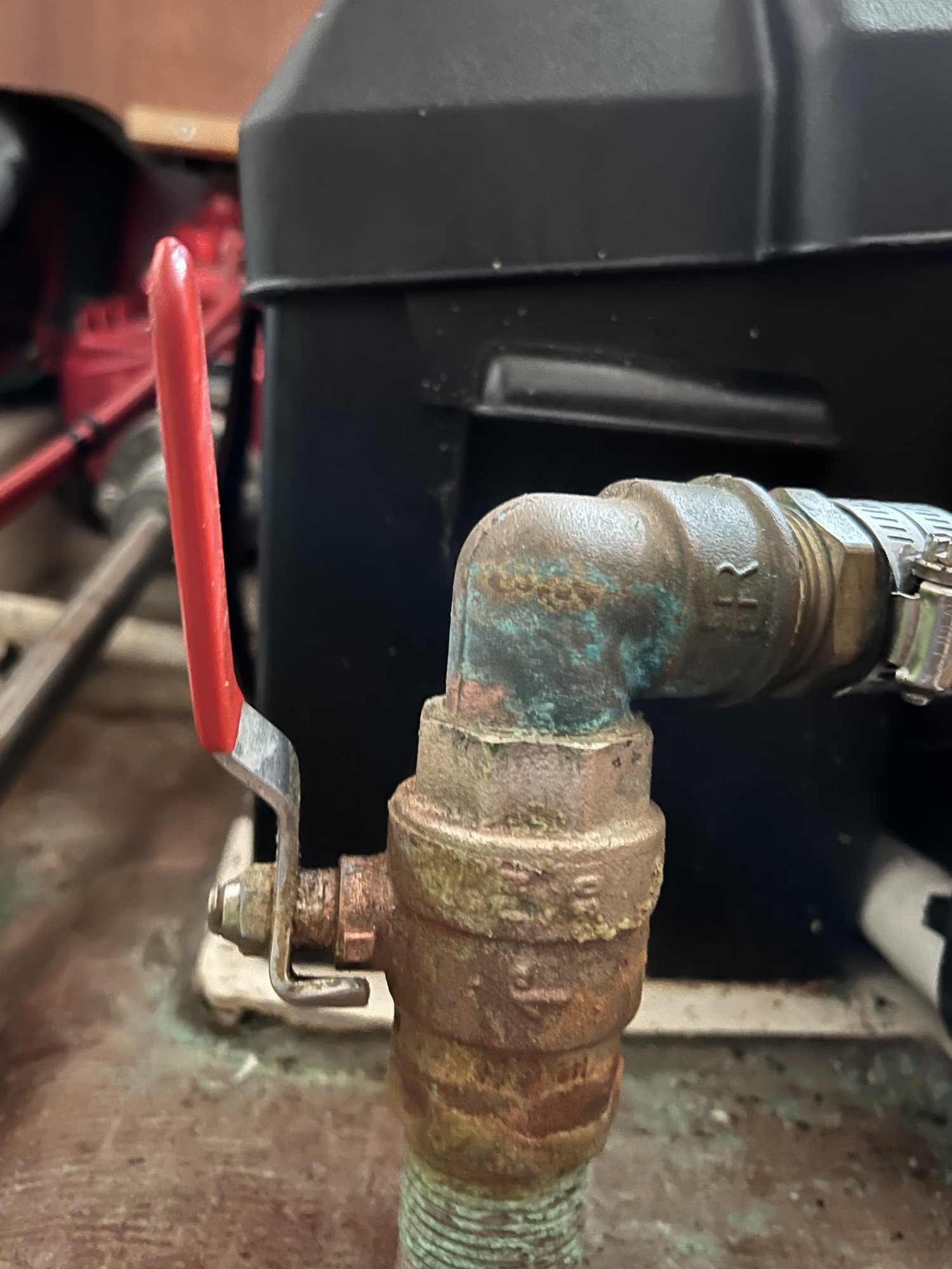

I’ve noticed water collecting around the prop shaft and working its way to the bilge. Probably 2 to 3 pints after 10-hour voyage. I don’t think it’s coming in at the prop shaft bearing. I think it’s coming in at the open/close control valve at the engine cooling intake through-hull. I’m looking for advice on replacing the valve without hauling the boat. Am I crazy to even attempt this?

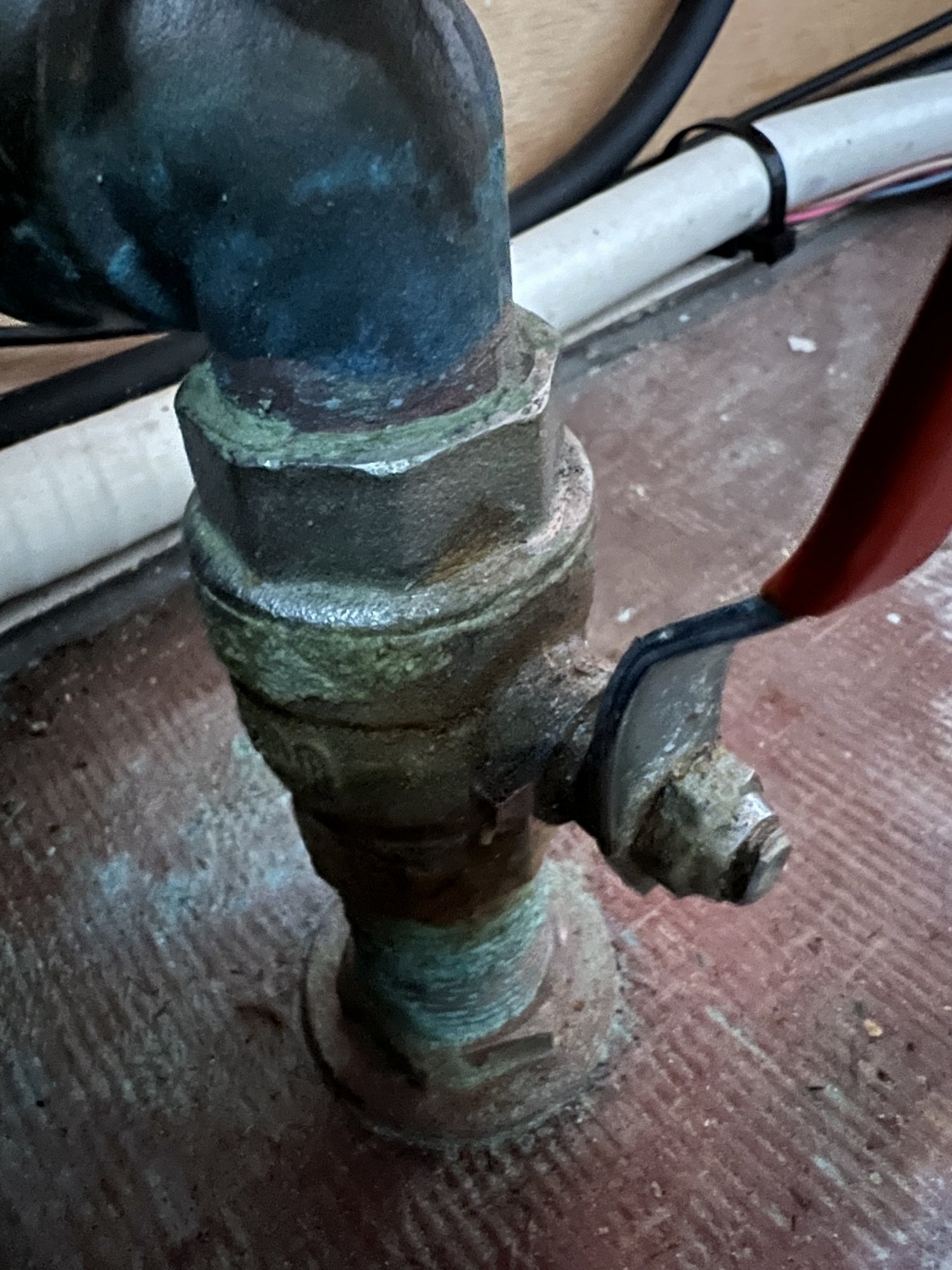

See my pictures in the above post. In this case the valve fell apart in my hand. It would have been spewing water for a while. Then when I began to try and get the bottom part of the valve off, the through hull spun. Knowing that the through hull seal was compromised, I removed and replaced both through hull and valve. Something not possible with the boat in the water.

Thank you all for your thoughtful replies and support. I have confirmed that there is a drip at the intake valve mechanism. But the fitting seems to have some integrity and in the absence of a good plan B, I feel happy to deal with an occasional pint of water, monitor the situation and replace the seacock and through hull when I haul out in the spring. I did a very thorough bottom job a year ago and was hoping for another season or two before hauling out again. But this will give me an opportunity to take care of other on-the-hard projects, and to re-touch the paint along the waterline. Thank you again everyone for your time and patience.
Do I take it that the leak is at the valve threads on the inlet side ? ? ?
If so, try not to kick the valve before haul out. The leakage is a little on the heavy side. Lightly scrape the thru hull threads and valve to be sure there's no galvanic corrosion going on in there.

I agree with the others, haul out to replace.
And I wouldn't wait til spring. The middle of a 10 hour voyage is not the time to find out that "some integrity" is not enough.

Beneteau 343 Slidell, LA
