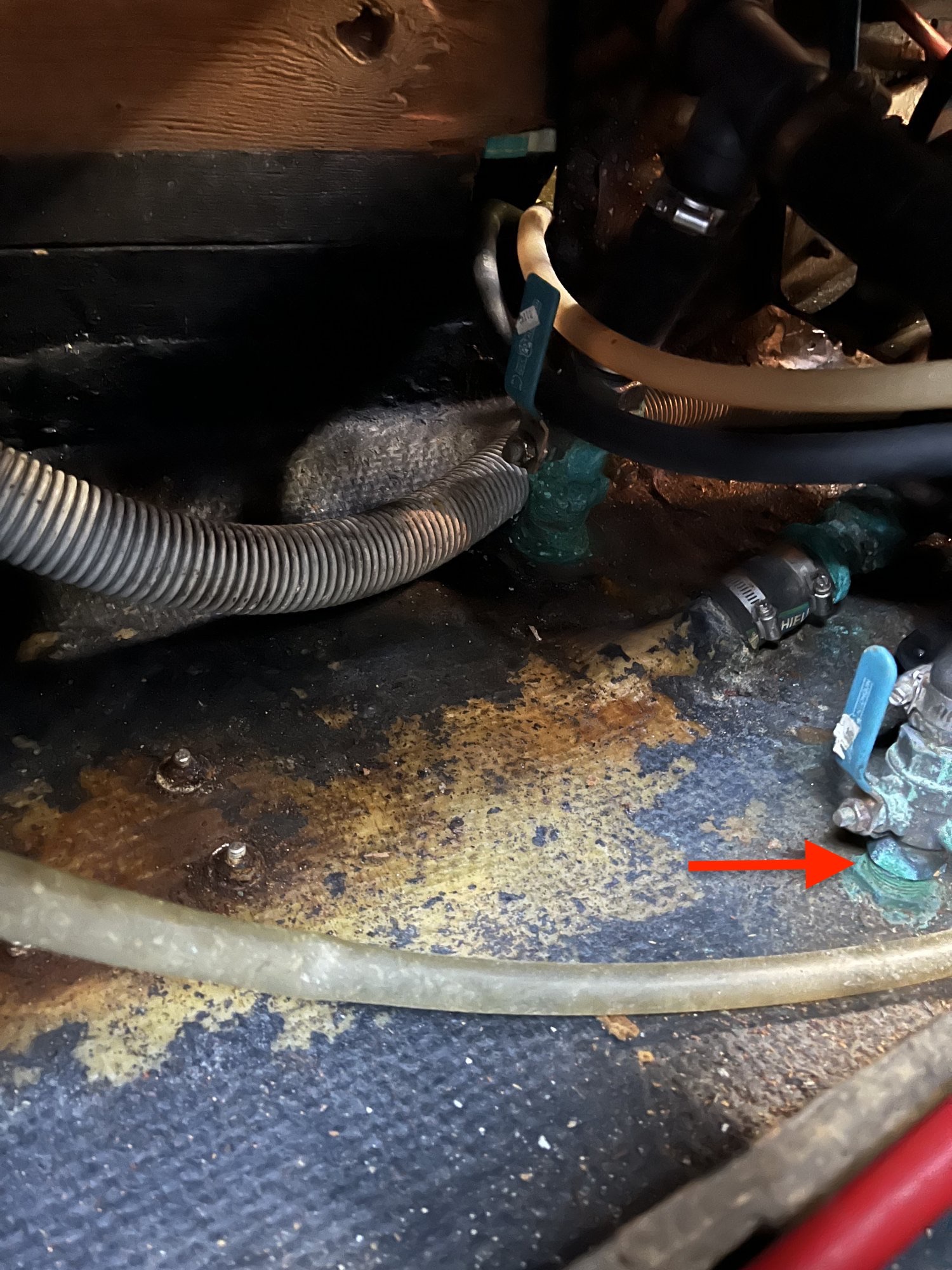

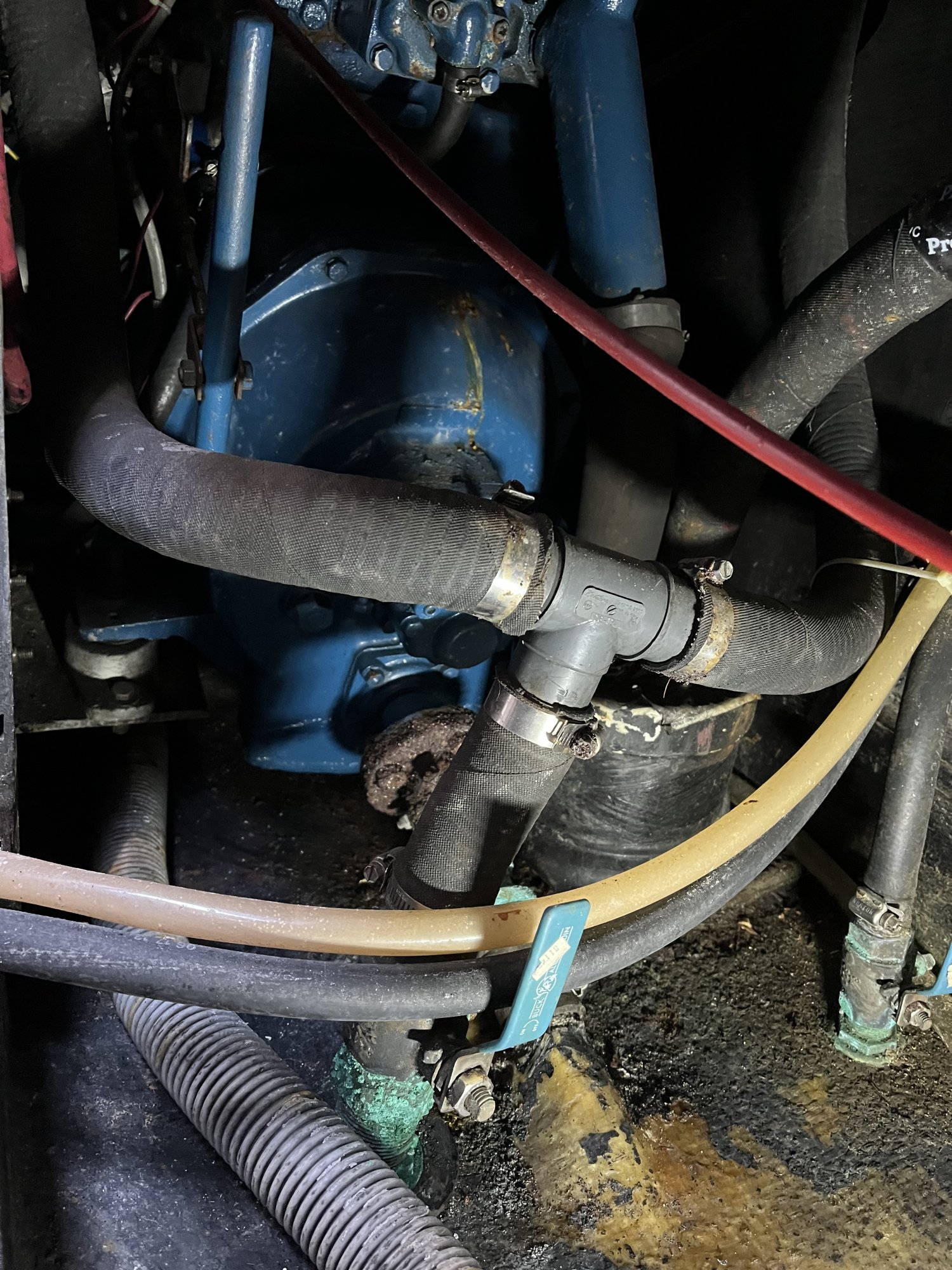

Here is the reason for the post. Now the bilge accumulated more like a quart or more after motoring, but also now leaks overnight. It is leaking about 15-18 ounces per 24 hour period. The only other thing that changed during this period where the leaking increased, is that I replaced both batteries. I was concerned that maybe I kicked one of the thru-hulls, which could be leaking. I am not a very good mechanic, and the bilge is very tight. So I inspected what I could, and the only dampness is under where the drive shaft exits the hull. I have attached pics of the bilge. Being a newbie, I don't know what I am looking at.

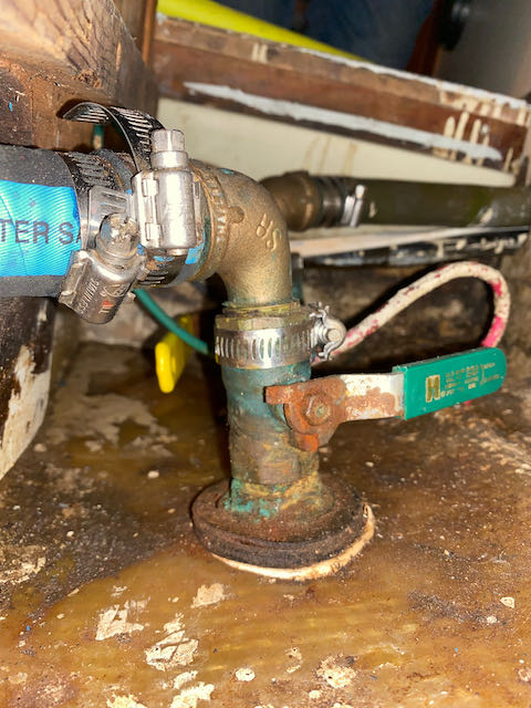

How do the thru-hulls look? To a novice, they look unbelievable corroded and green.
I am planning on repainting the bottom in a few months and addressing any thru hulls that need replacement. I also want to perform and needed rudder maintenance. There are no manuals for my boat and Lancer went out of business about 30 years ago, so any guidance would be much appreciated. What is a normal amount for the packing gland to leak and what should I do?

The packing gland should leak a drop or two every ten seconds or so while the boat is in gear. It should not leak when the gear is in neutral. The leaks you describe do not seem excessive. Your could run the boat in gear while at the dock and observe the packing gland to verify how much it leaks. By the looks of the gland, it has not been adjusted in a long time. You will need to soak it with a good oil [PB Blaster,etc.].

The packing gland looks suspect, the thruhulls are very corroded and most of the hose clamps are rusted and not double clamped. A little water accumulation is just lucky.

The corrosion on the through hull would bother me.
I would be scheduling a haul out to replace the valve and through hull.

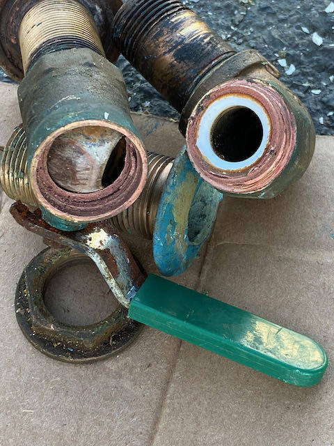

My reasoning comes from an experience last year.
Here is what it looked like.
Here is what I found when I tried to remove the through hull. It broke a part in my hands.
I take no risks when I have a boat from the 70's that I do not know the age or the condition of a through hull.

All -- Read this thread with interested. We have an '09 Hunter 45DS that was accumulating 3-6 cups of water in the bilge after motoring due to the normal seepage around the shaft. The thing is, we have been working to get rid of moisture sources to stay ahead of the damp smell and potential breeding ground for mold. To address the issue, we created a "sump" under the shaft using a plastic organizer tray epoxied in place for stability. We drain is using a turkey baster every few trips and on long-haul motoring days will keep an eye on it. The only challenge is when we are healing 10 degrees+ if there is water in the tray -- in that case, we can get a bit of spill over but even when that happens, it just goes to the bilge.
Overall, the solution worked and we have a dry bilge for some time now!

We had water accumulation in the bilge while under way, but not at anchor. Turned out it was coming in the rudderpost, which was above the waterline at rest, but had the stern wave cover it when sailing or motoring. Repacked the stuffing box there and end of problem. The trick was to stick your head under the cockpit and watch it happen while sailing, instead of being on deck enjoying the sail.

It does sound like the packing gland after motoring for an extended period and sitting overnight. Finding water in the bilge after being out in rough waters or the boat sitting overnight in motion because of lapping waves does not necessarily means there are leaks. Your boat like has many gallons of water trapped in the hull stringers under the sole and every time the boat gets in motion some of that water may be released into the bilge. That water that accumulates in the hull comes from rain leaks, washdowns, plumbing leaks, wet bathing suits, galley spills, sea spray, etc. Check the drip from the Packing gland and there should be none when the shaft is not turning. Measure any water in the bilge after a night of calm waters and no rain. If it continues to show 15-18 ounces overnight you have a leak that seems to be getting worse. Beware on the Yanmar GM 1 if a water leak develops at the raw water pump it will drip down and eventually corrode the oil lines that run under it.

As I mentioned in my post, my thru-hulls "look unbelievable corroded and green " to me. Is there any kind of maintenance that I can do to clean them up? Would CLR or something stronger be good.
