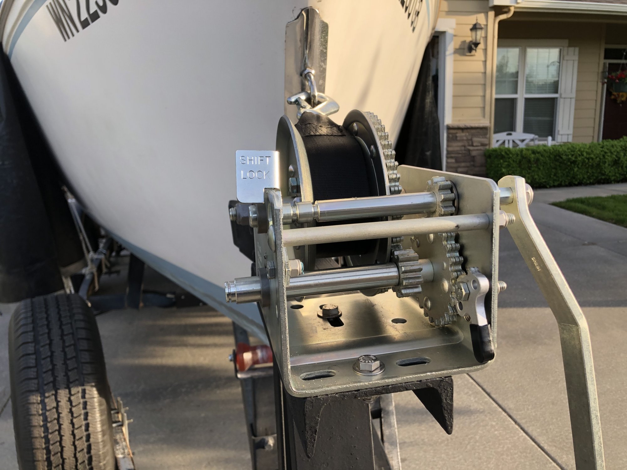

I had some challenges with a legacy rope stretching every time I pulled the boat. Converted to a new strap winch and solved that problem. UV not a huge issue for my particular set up. I don't use the winch for mast raising my self-- but that strap is looong. It might be a viable option?
