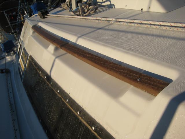

After years of pain in maintaining the narrow teak eyebrows along the length of the cabin top, I purchased and installed new "Plasteak" eyebrows.

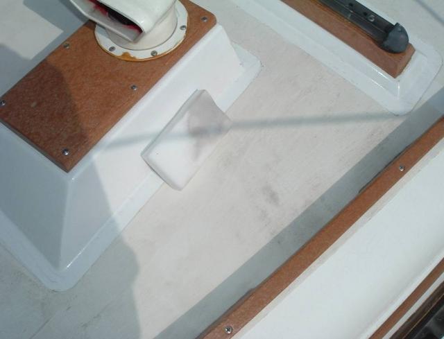

My experience is good and I'm very pleased with the product, but there are few things I'd like to share.

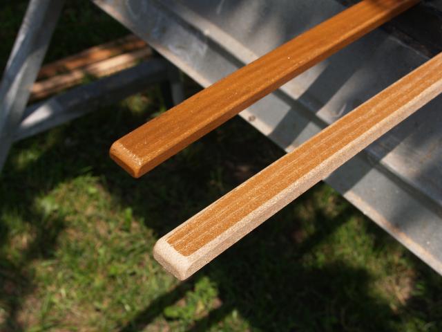

On the good side; it's made from recycled plastic, the price is comparable if not cheaper than teak, it cuts and sands like real wood, the color and molded grain looks just like teak, the finish, color and shine has held-up well through first year, and most of all it is expecetd to NEVER require any maintenance!!! When you look at it from the dock you'd never know it was not real teak. The company is great to work with and will custom cut to your dimensions.
On the caution side; long lengths will grow and contract with temperature. I installed fasteners in same holes as old teak eyebrows in the spring when cool. When the warmer summer weather came it bowed between fasters and I had to tape all-around, remove and then bed with sealant and reinstall. Unfortunately the company doesn't provide any guidance on this when you order (I should have bedded it to begin with). Also, the maximum length UPS will ship is 8 feet.
In summary, I highely recommend this product and will use it again for any further topside teak replacement.
