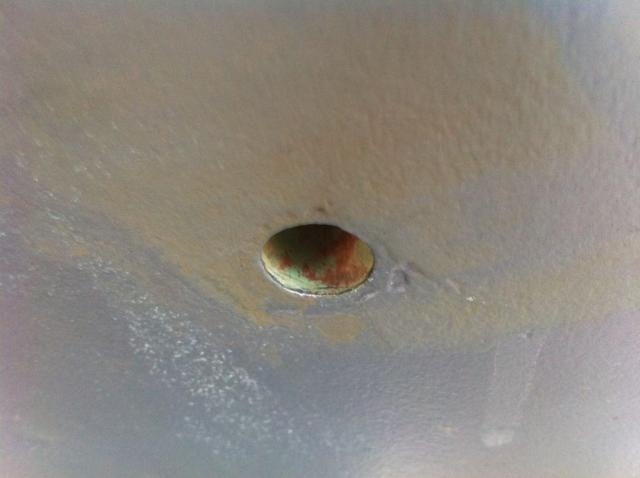

1) 2 of the three have a fiberglass layer over the through-hole (see first pic) and do not look like they have a backing plate. What is the best way to work through this top layer to get to the hull layer? (sand, grind or chisel away). I tried to scrape and chisel with little success.

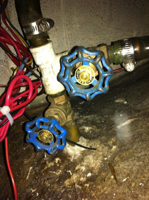

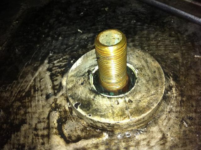

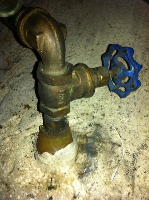

2) I am looking for some input into what lies beneath that fiberglass layer (second pick). What i have is the original flush through-hole with gate valves (pick 3). Does any catalina 27 owner know if these are bolted through the hull, or have a backing plate? Would love to know what I an getting into here. This is for the toilet intake and sink drain.

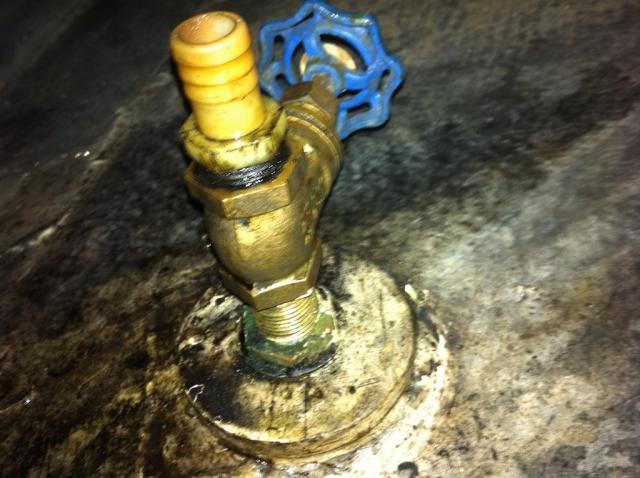

I got my water intake one (with backing plate) off no problem and will remount a backing plate following Maine Sail's technique.

on my '77 the factory thru hulls were simply a close nipple glassed into the hull. No backing plate, no bolts, just glass built up.
