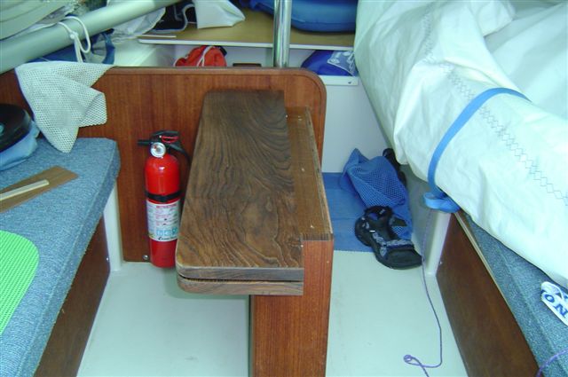

Another option, if you don't plan on using the table in the lowered position you could consider what several of the guys I sail with have done. Make a half table, gives tons more room. All used marine plywood.

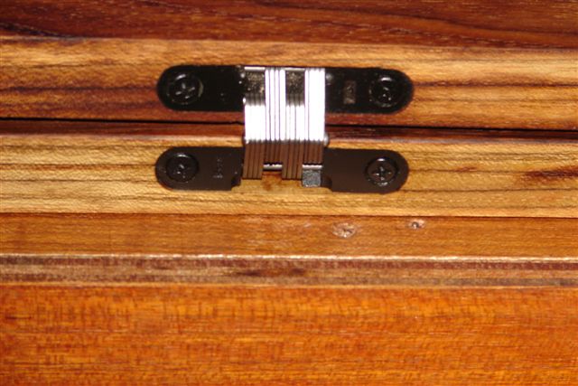

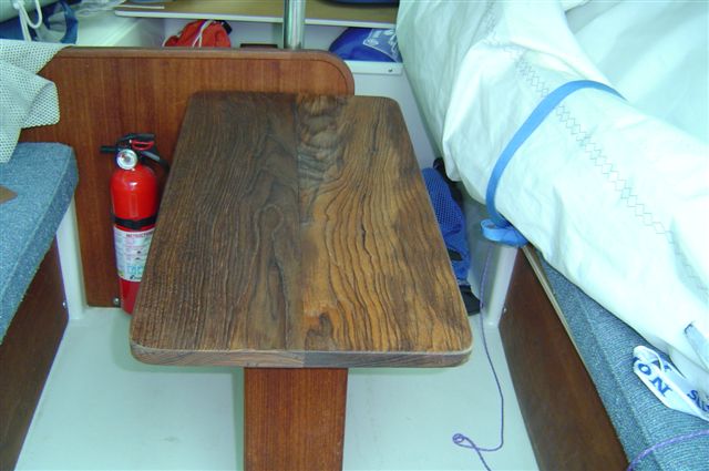

Didn't care for the table in the MK when I got it, passing it could easily remove a layer off the shin... So I had another built at a local teak shop.
Of course this is a different type table than you have or need. :)

1. I never knew there were "Teak Shops." That's handy to know.
2. Pretty nifty installation of hinges on that table, they seem to disappear.

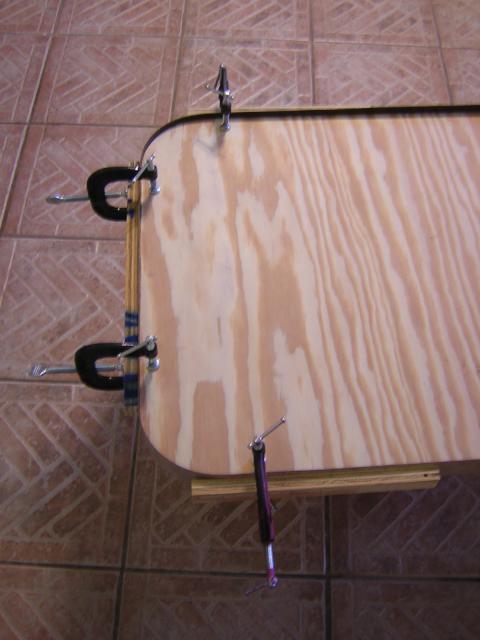

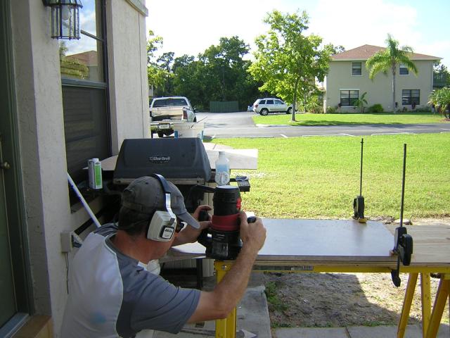

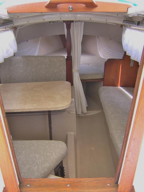

We made a table earlier this year using 3/4" plywood laminated with formica on all sides. I don't believe moisture should be an issue if its completely sealed. Check out photos on Sailboatowners under Owner directory; Owner photo albums; User name ; Shelled. Perhaps I could find the time to post the process and photos this weekend. We recycled the original leg and hardware

Your boat looks great! I like the off-white and beige upholstery, it gives the entires cabin an airy and warm feel.
