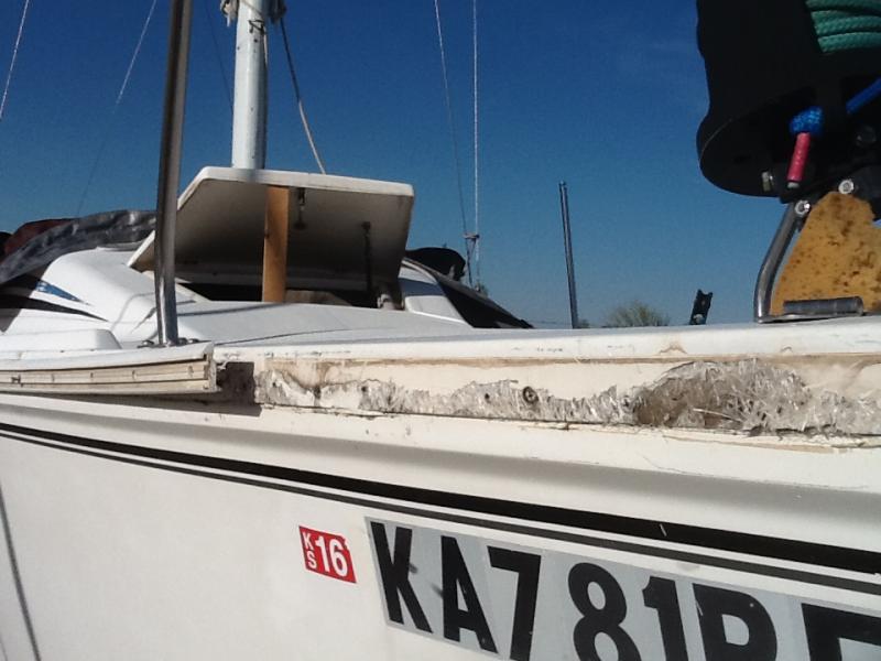

OK, I'll strongly consider 5200. FWIW, I having a helluva time removing the port rail. I think was this side rail keeper was rebedded generously with 5200 and the gel coat is coming off with the rub rail exposing fiber glas threads/mesh. Should I care or not about this since it will underneath the rub rail keeper.

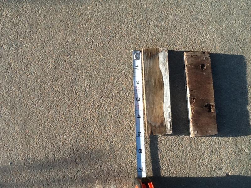

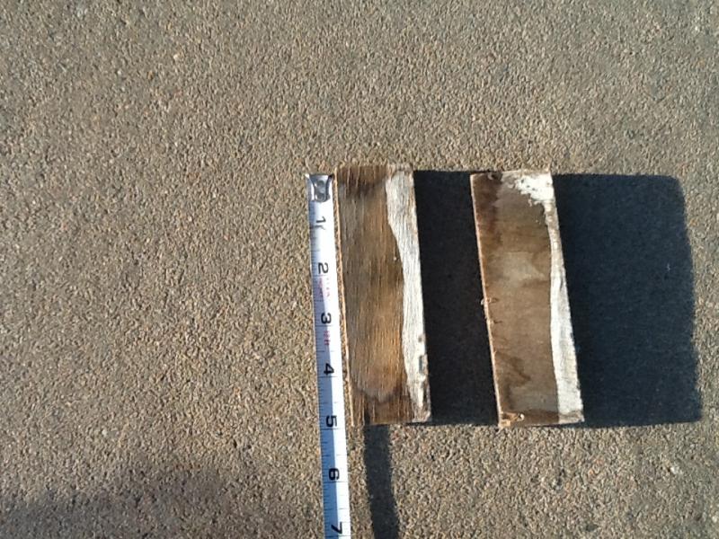

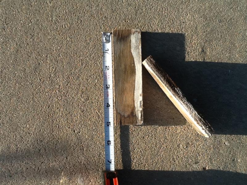

Here are some pix of the wood blocks
what plywood blocks sir. Take a couple of photos and post so we have a better idea of what to look at and get some really good responses from this forum.
These5 x 1.5 x 0.5 in. blocks are inside the hull where ever rub rail keeper screws penetrate the hull. I have found these in the main cabin (port and starboard) and in the lazarette when mounting some line cleats aft of the aft life line attachment. They are usually barely attached and some time they just fall off in your hand.

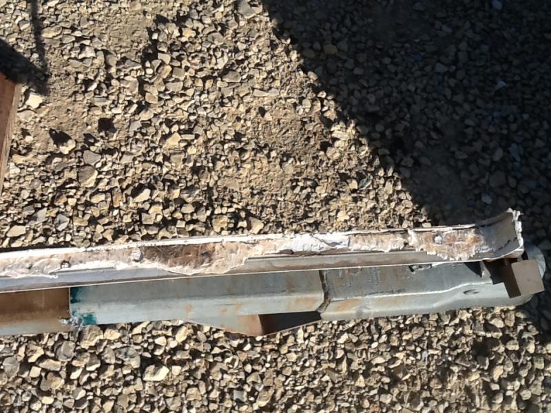

Initial about 8 ft of the rub rail was damaged by bashing the port side into the slip during thunderstorm with 80 mph winds. Both port stanchions were bent over as well. I did not secure bow dock lines as tight as I should have.
Anyway as I removed the black insert it damaged the undamaged rail keeper. And I do not think there is a way to cleanly replace just a section of the rub rail and keeper, especially if 5200 has been used before.
