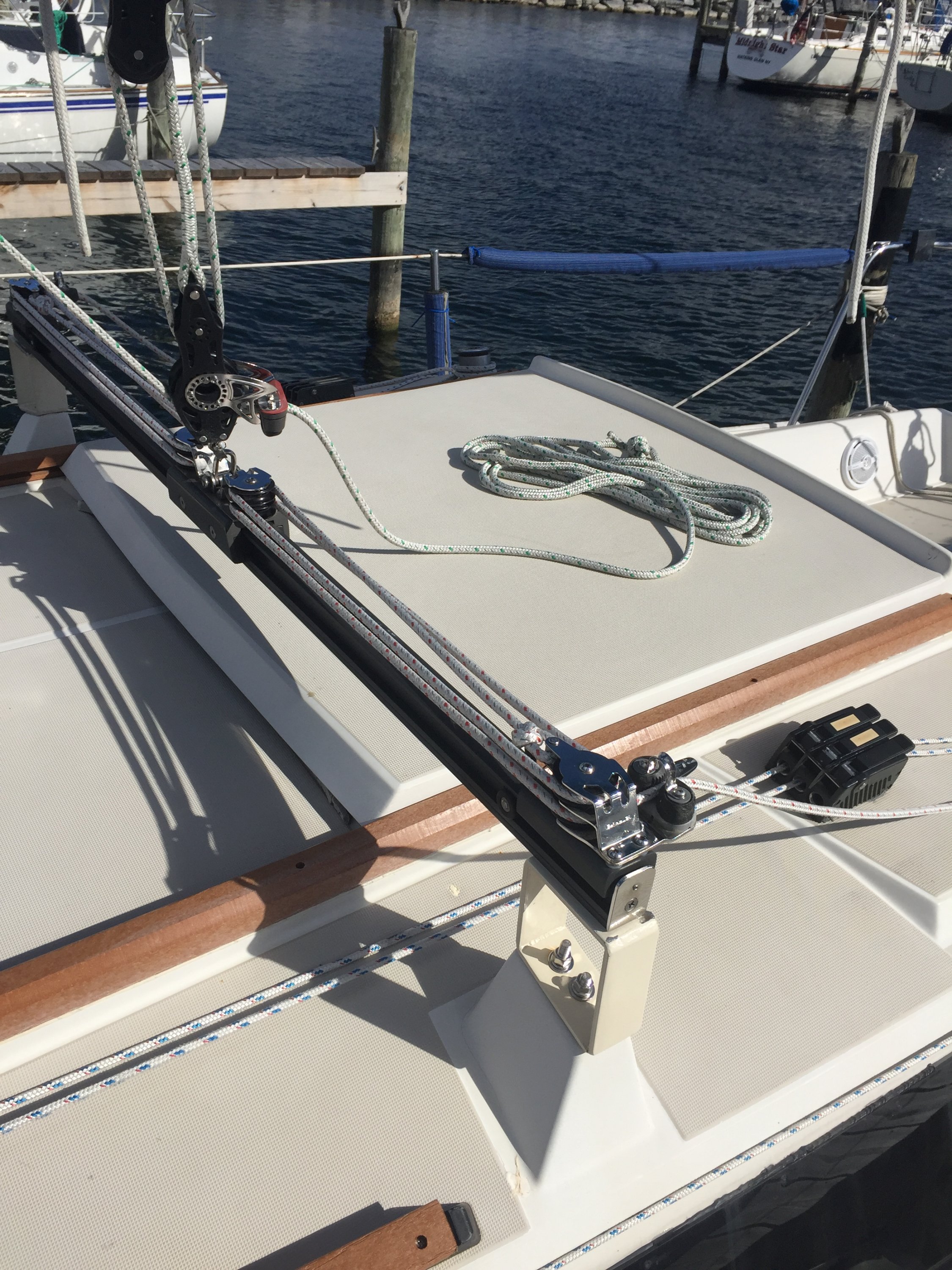

Go to Garhauer. I upgraded my traveler to the MT1 on my 272. Get rid of the curved track too! I had stainless riser boxes made to mount the new track. The new traveler with controls works better on the flat track. Garhauer makes risers too, but I got mine done much cheaper at a local fab shop. I made a mockup of the traveler track (wooden 1x2) and cut modeling foam to create the mock up of the risers.

...and just let me say: Gawd I hated that awful curved, pin-stop track! Grrrr!

Thanks to everyone for the comments and pictures. I never thought about going to a flat track. I wonder why O'Day went to a curved track in the first place

Cheaper! ....oh how I loath that curved track with the Pin Stops...
then I bought my Telstar 28... Pin Stop Traveler!
Nooooo!
My first upgrade was to make traveler control lines! Ahhhhh.... relief....
