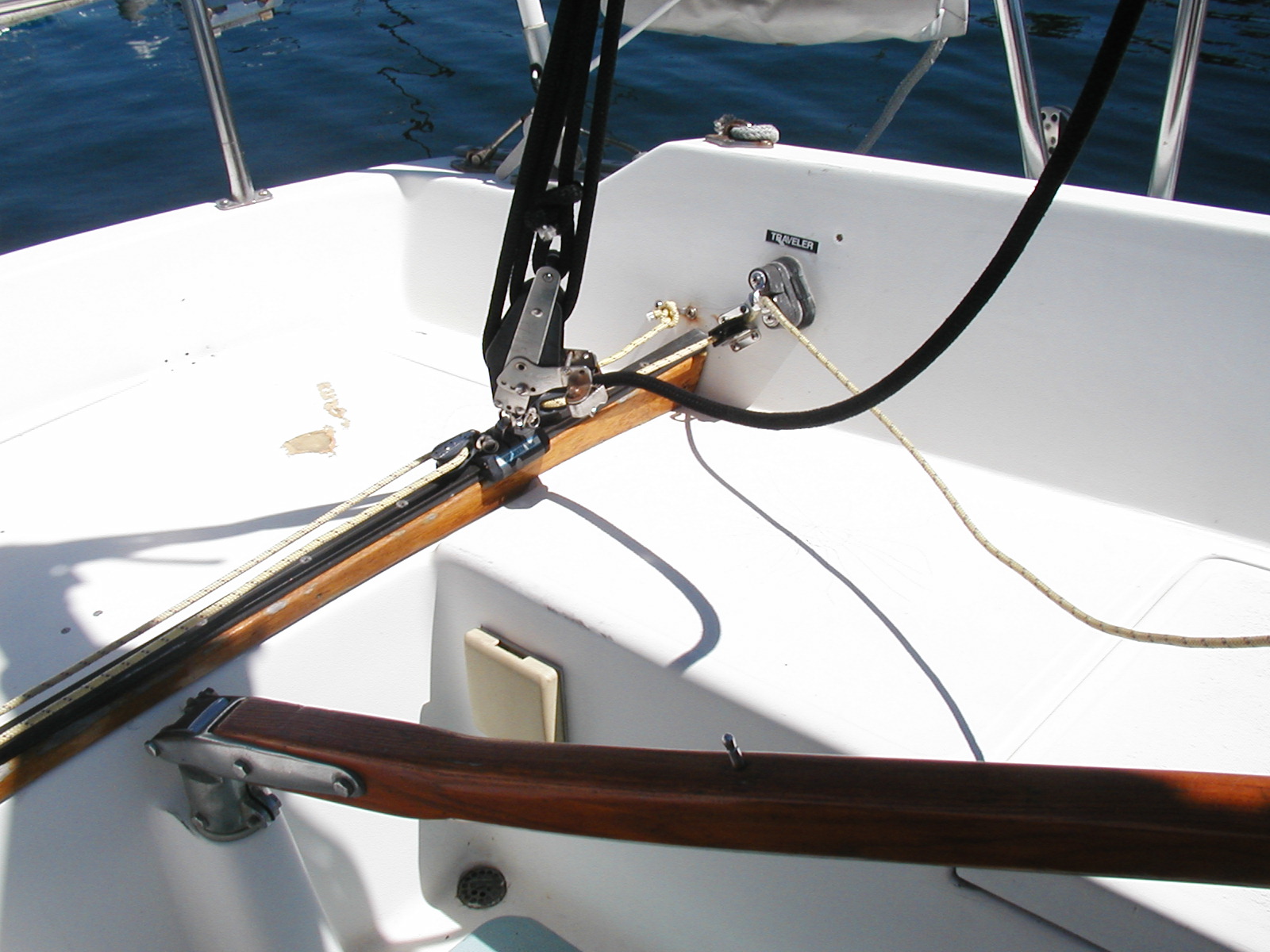

Sorry about the thread drift, but I like those hatch sliders. They look like the "pleak" (plastic teak) sliders that I have on my 35 - made on the table saw that I used to own.

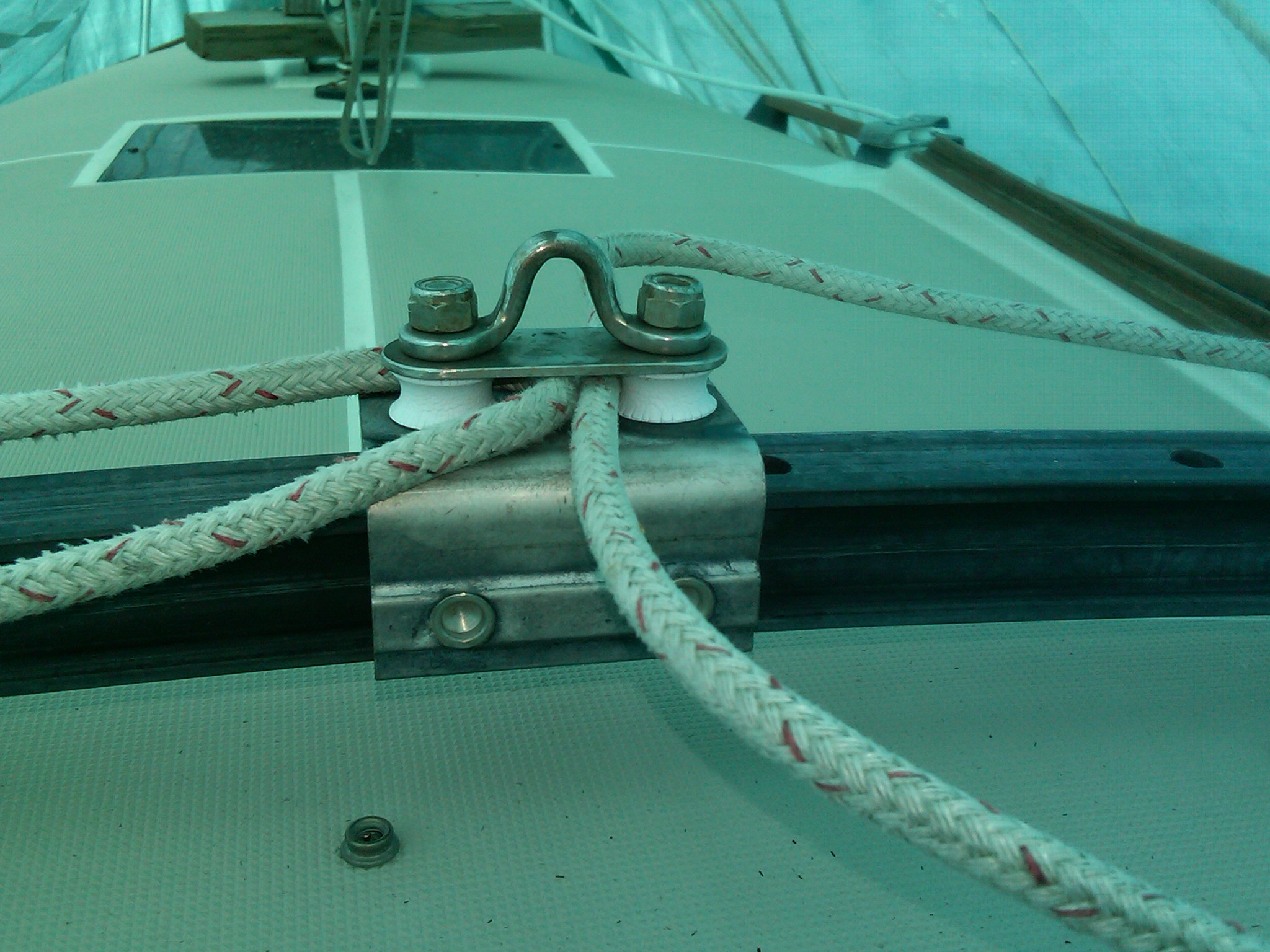

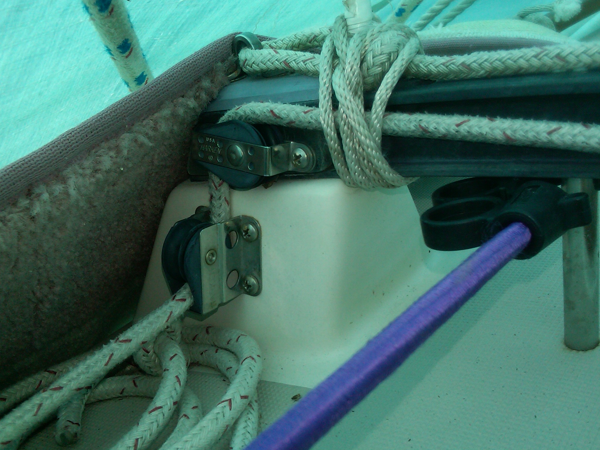

I really have no idea what possessed O'day to use the curved track but I do know that somewhere on my computer...there is the email reply from Harken stating the various sail shape advantages to the curved track so I kept the curved track and called Nicro to get the cars, etc while keeping the curved track....the blocks are all Harken...If I can find the Harken email
I'll post it.....the positive to the new setup is I can operate the traveler from the wheel with ease. Pat

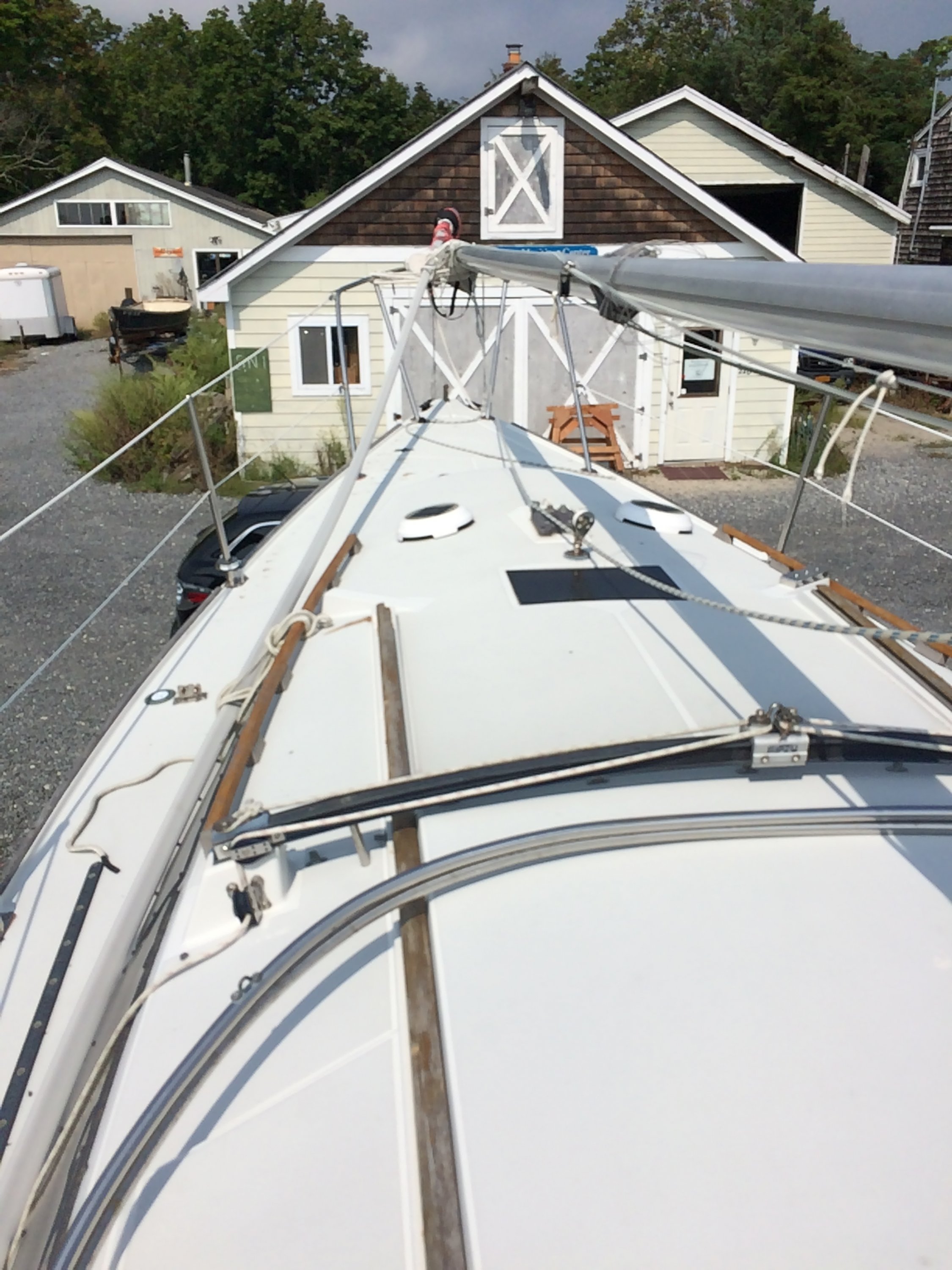

Umm... Your track curves up. High performance curved traveler track curves THE OTHER WAY.

I can't explain the curve as it is on my 272.other than it matches the curvature of the cabin top....when I added the adjustable blocks, etc. I also had our racing buddy re-do our mainsheet tackle and it's really impressive what a difference that made as well....It use to be that sometimes I had to physically push the boom out; i.e. in very light winds.....not any more the tackle he installed is so sensitive it takes care of itself...all I do is pop the cleat and make my minor adjustment(s) even in very light air; much better than the original stops, etc.....I've got pictures I took yesterday...we do not race however we have, but the boat itself is not a racing boat....but is still a great deal of fun....Patrick
That's the reason they did it; it looks sleeker and anyone climbing over the cabintop is less likely to get snagged.
