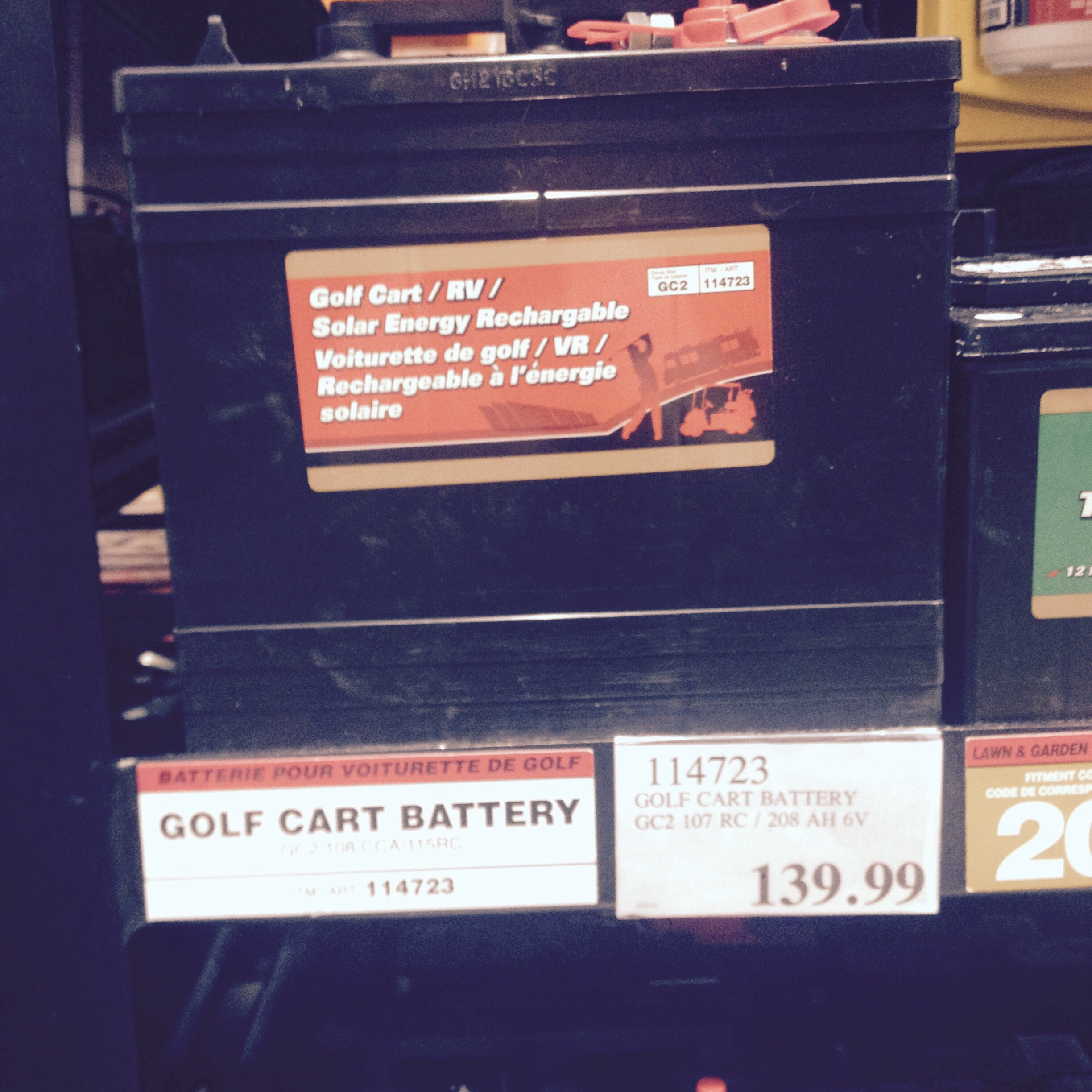

I was looking at these golf cart batteries in a Canadian Costco, are they the same as the ones Mainsail recomends?

Captn Scotty said:
these golf cart batteries in a Canadian Costco, are they the same as the ones Mainsail recommends?
There can be many different labels on what is the same battery. Somewhere it should give you "manufactured by" info.
