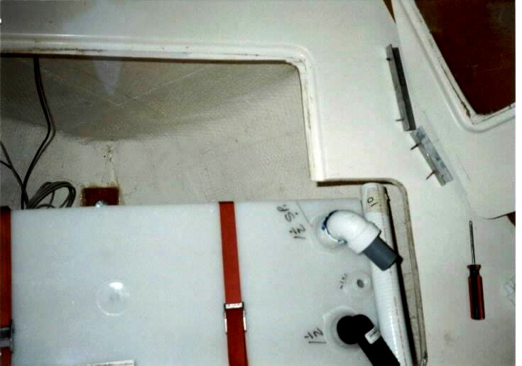

Replaced with small Ronco plastic tank
Steve, Just so you have every possible option :) here's what I did to replace my leaky aluminum tank last winter. I cut off the top of the shower seat and cut up the tank and removed it that way. (I removed much of it from the starboard V-berth locker but couldn't get to all of it from there.) I replaced it with a simple Ronco plastic tank (in the same place), about 10 gallons capacity, and made a new starboard cover for the shower seat. My thruhulls are in the V-berth starboard locker (my boat was built in 1980). I've had the boat for three years and, in hindsight, the old tank must have been leaking from the first day I bought it. One day last winter the output hose fitting from the old tank broke off. Replacing the tank has been like getting a new boat.
R
Ron
John Reid
Did you use the piece of the shower that you removed or did you build from scratch? So far your idea and the one using the starboard vee locker seem best for me. Have you got any pictures to share with us??? Ron/KA5HZV
