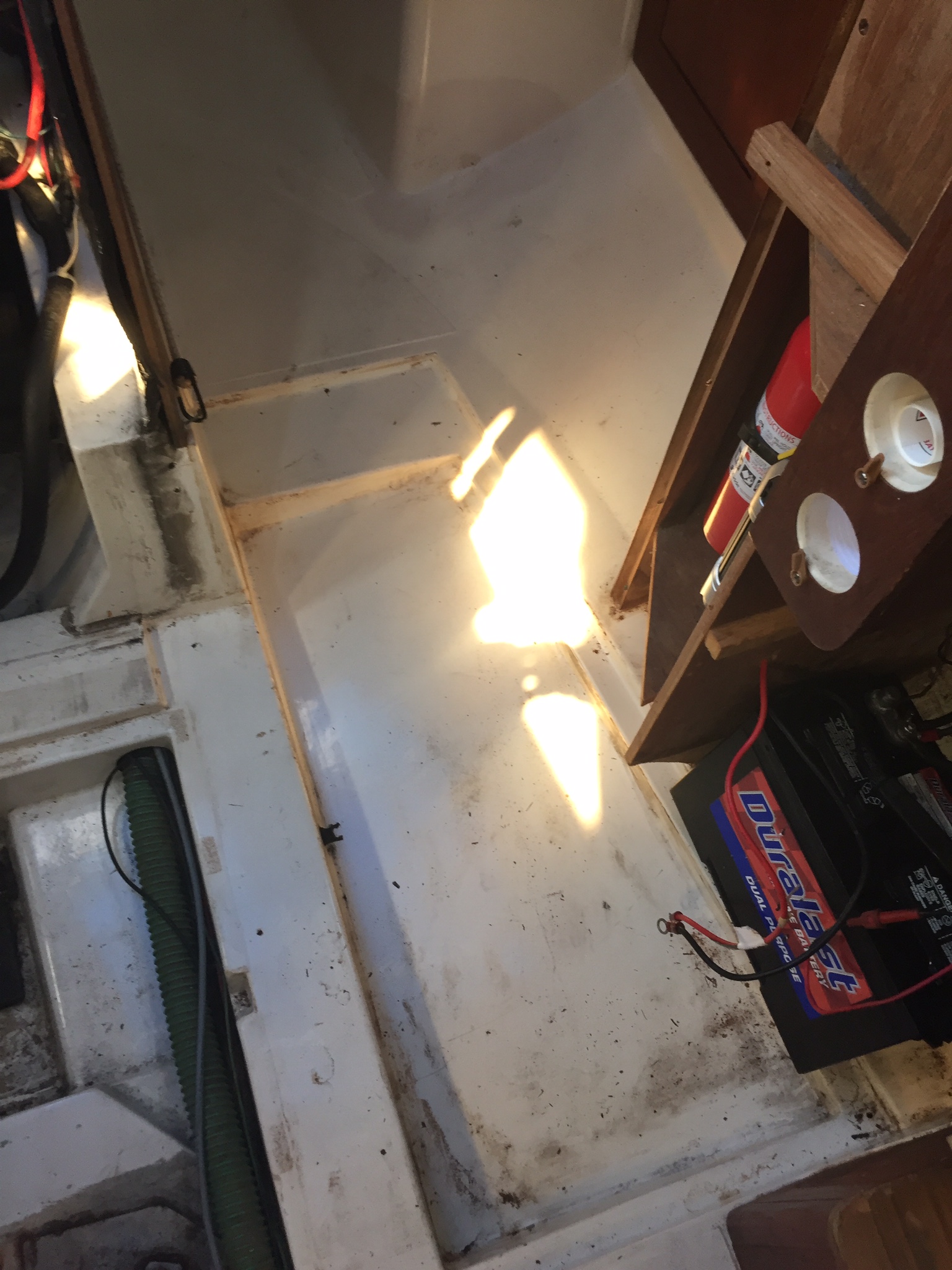

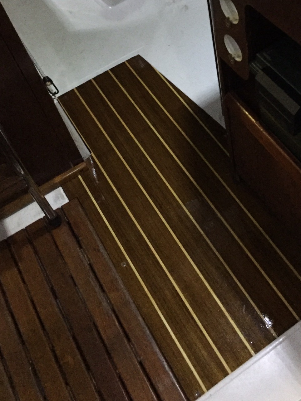

I concur I just replaced a portion of my sole. They were in place for 35 years with stainless screws. I unscrewed them and the sole popped right up. Plus you need to have some space for water to move to the bilge under the sole. See the attached picture where the sole goes.The soles sits on the edges with screws going in the edge. The second picture is the new piece installed. Note the screw heads showing, you chamfer the holes so they sit below the surface of the sole. I did not get to put the teak plugs in to cover the screw heads as of yet, but that will happen soon. I had to stop working and go sailing!
