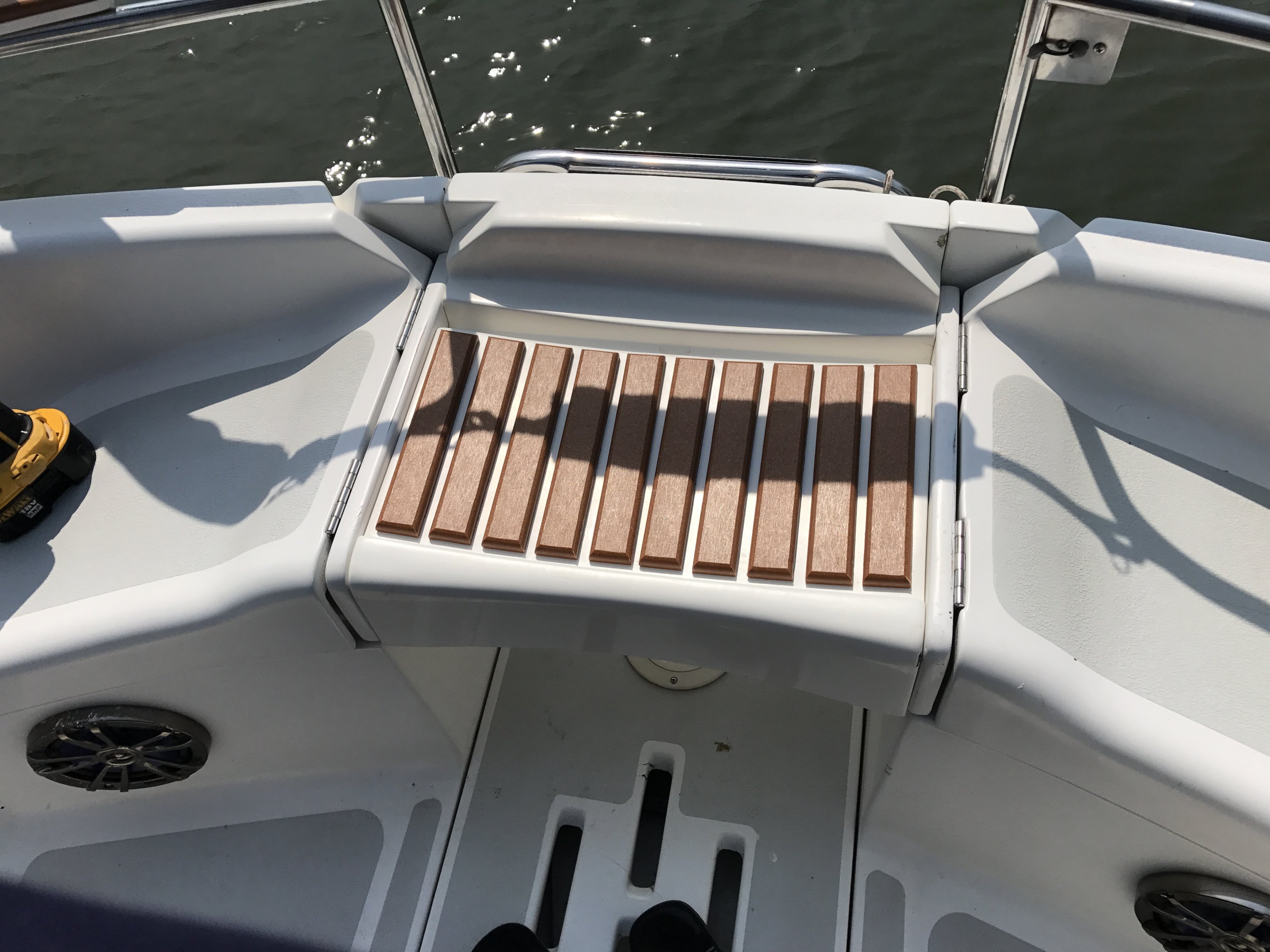

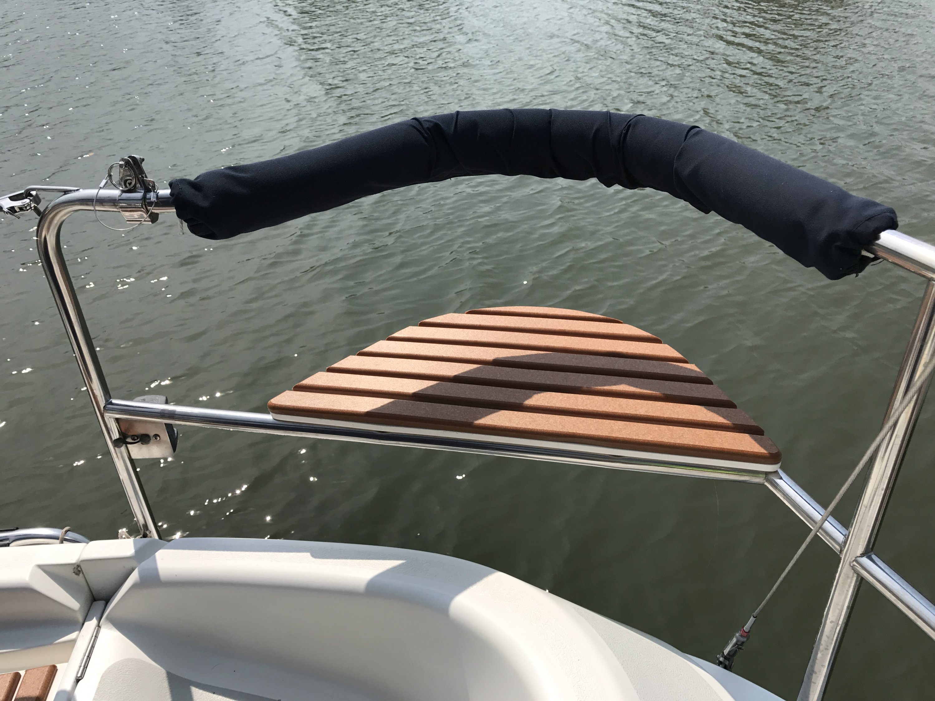

I am curious how you all have treated the sawed edges to match the factory surfaces.
I router the edge to make it smooth and rounded. The edges are small enough that you don’t notice the lack of texture.

Will, where do you see Plasteak advertising it for interior only? They make swim platforms and bow pulpits out of the stuff.
