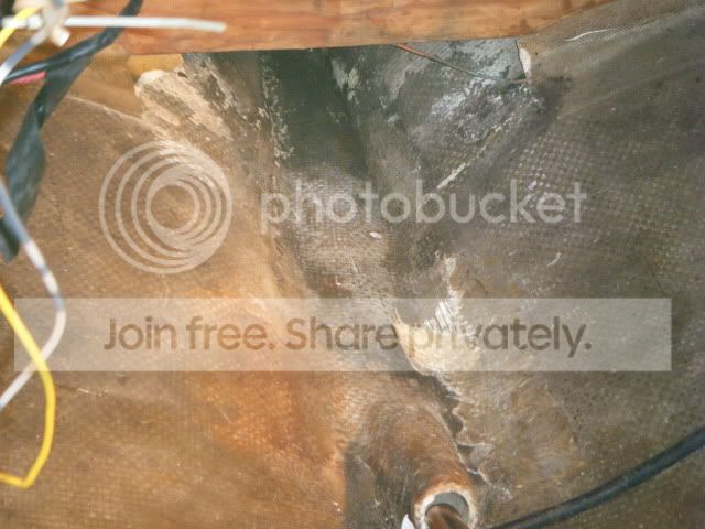

I got the strut off this morning on my H30. Kind of a pita working by myself. My arm was just long enough to reach the nuts. I had to clamp the nut inside with vise grips and climb up and down the ladder 12 times but it's finally done. The backing plates are rotten. I almost cried when I seen what I have in store to put new backing plates on. I am 6'5 have no idea on how I am going to contort myself in that cramped area. Any tips or lessons learned before I start besides plugging in the heating pad for my back?

Nice job Tommays. I see you are using my favorite tool....the oscillating saw. Not sure what I'd do without it. Looks like you at least have some room to work in. My strut is a vee shape and need 2 backing plates and is located under the fuel tank. I lucked out and was able to just pop off the old wood plates. I used one as a template and predrilled my holes in the g10 epoxy plate.

Oh Tommays, if only the H30C's nuts/backing plates were that easy to reach!
Yes, I said PLATES.
The strut is a V shape at the hull and requires two separate plates mounted at a
80 degree (or so) angle and they lie almost under a FG cross plate, aft of the stuffing box.
Kito, I'm afraid Woodster has the only viable solution.
BTW, when I replaced mine I used King Starboard instead of wood.
