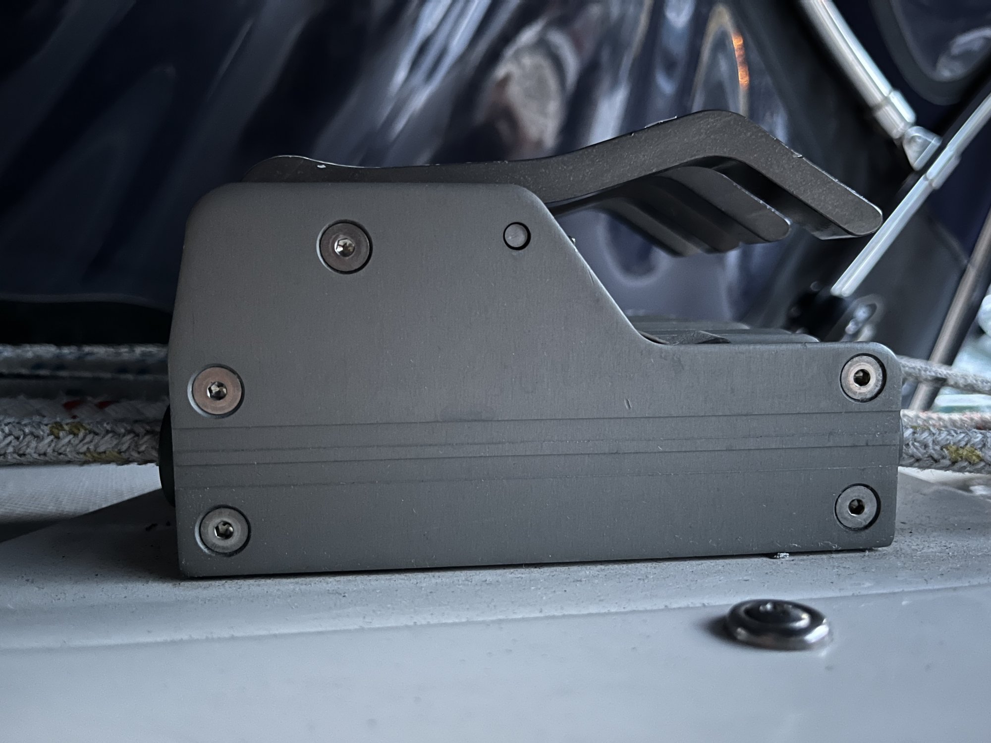

The clutch for my main halyard refuses to stay in the open position which makes it difficult to drop the sail when single -handing. As a temporary solution, I swapped it into the clutch and block for the Spinnaker halyard. I think I can find a quad clutch online and would like to replace it when on the hard. I understand that the OEM clutch is screwed into a threaded plate glassed into the deck. I understand, further, it can be difficult to remove the original clutch without stripping the threads in the plate. Has anyone replaced their starboard clutch and, if so, what are some pointers to do it successfully? Also, any advice on what model replacement clutch to get? Catalina Direct doesn't seem to carry a quad clutch. I want see if I can match up the mounting holes. Thanks!

My 320 used Garhauer single clutches with the gray bodies, those will malfunction as you decribe if the allen head screws at pivot points are loose which they have tendency to do. I think Catalina used Garhauer.

Had the same problem with my clutches and found forward pivot point screws to be very loose as described by Calif.Ted. tightened them after I applied thread lock and no problems. Also you can get a rebuilt kit for these clutches should the need arise.

I had the exact problem recently - clutch would not stay open. I asked a pro rigger and he confirmed: Garhauer clutch. and yes, tightening the screw slightly to increase friction on the spring totally fixed the problem, as mentioned by other posters. Easy.
