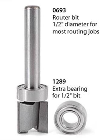

Glad to see he's shaping his own lenses as this is something I haven't seen posted yet. Saves $$$$. The original lenses have to be removed in one piece and the archives show how. If he's into routers, tell him a template bit will do a flawless job +/- 0.001" of copying the original lenses:
If he's not into routers, tell him to do so. In the overall cost of the project, it's minor and he's then set up to do every portlight/hatchlight on the boat. Sorry I can't give you the Catalina thickness but on our Hunter 310, they are 3/8". Keep the acrylic smokey for your privacy.
