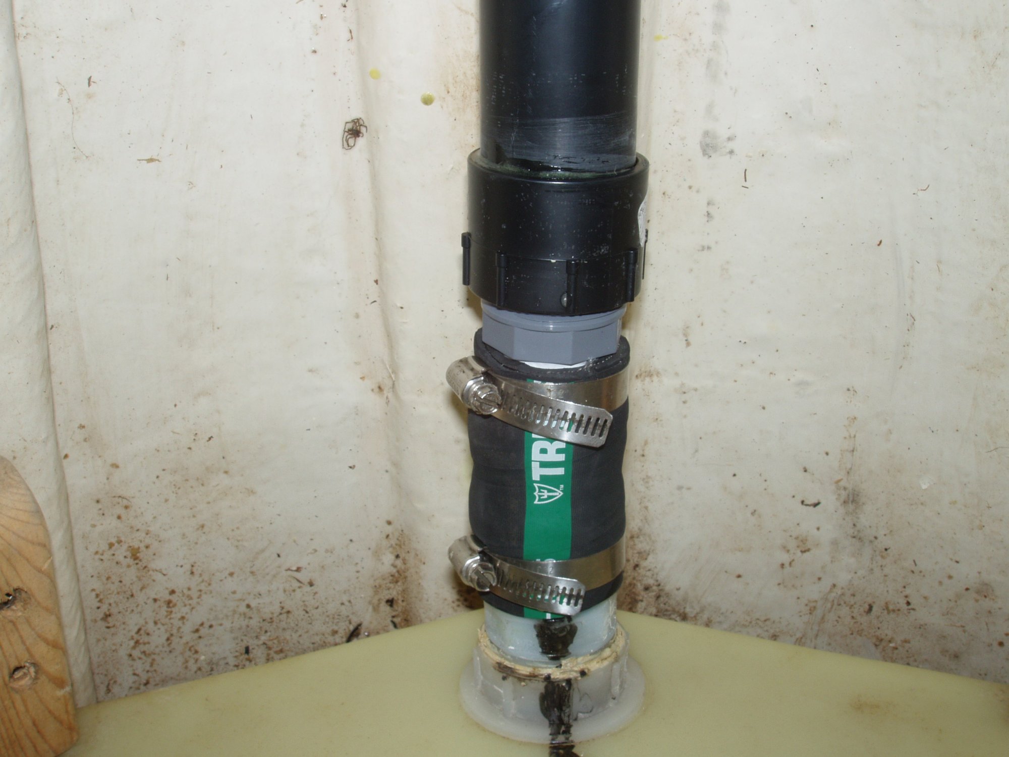

Yes, Black ABS is better but must use flexible hose as coupling. See attached. Had them for 12 years now. No smell.
